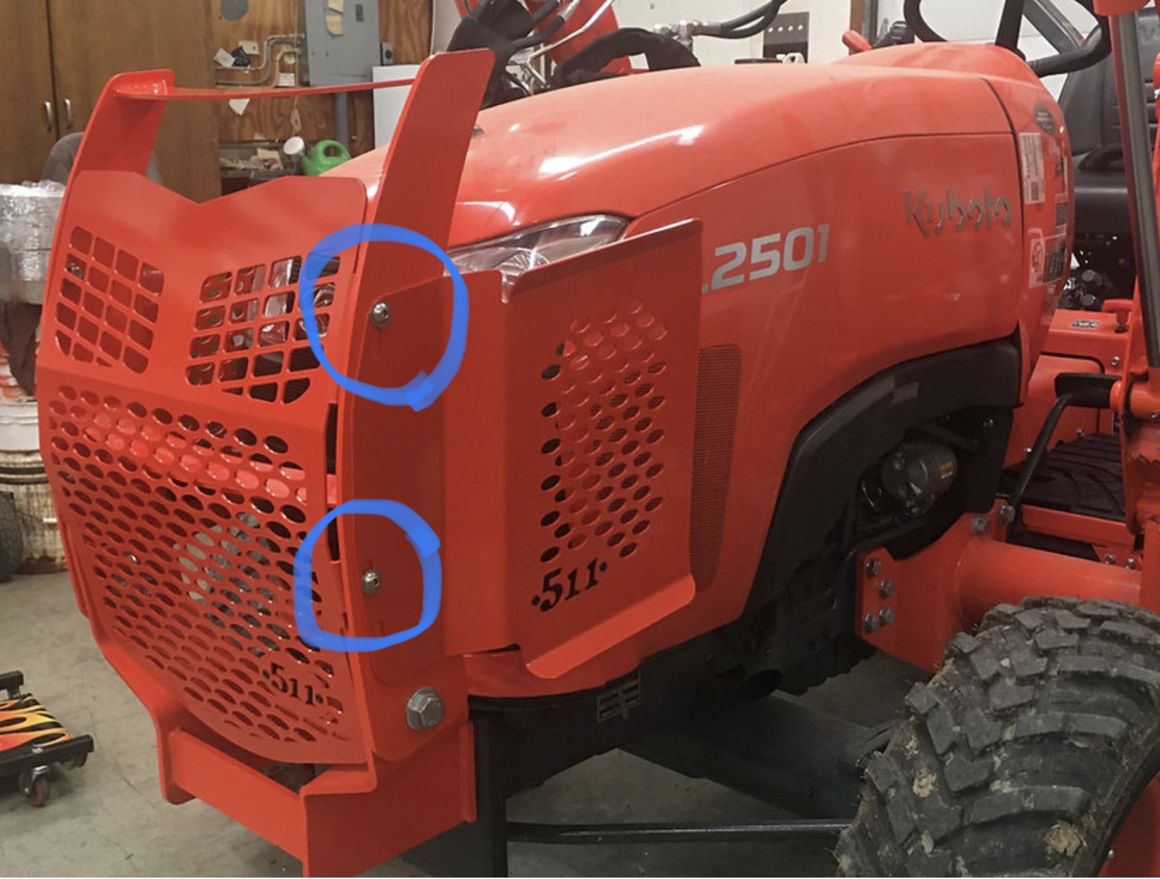

I got two out of 4 holes drilled through. I still have two to go. I have broke more 1/8” drills than I can count. I have ordered some more drills (1/8 carbide and 3/8” tool steel) from McMaster Carr and will have them Monday. The 1/8th drill is first to get a hole opened that the 3/8th can just hog out the necessary material. I have used oil as well as cutting fluid to keep on the drills While drilling.
I was going to put it on my drill press but its not tall enough to work nor is my knee mill.
those that have done the drilling, any pointers? This shouldn’t be rocket science…but damn!

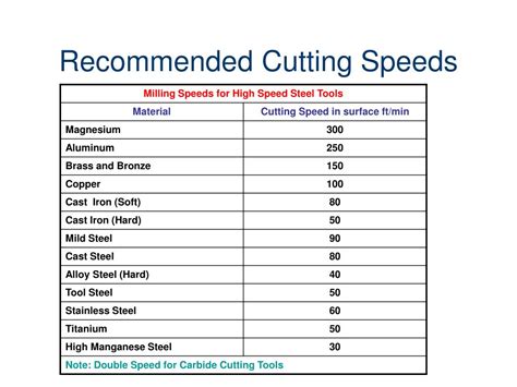

Is your drill motor in reverse? RPM=4xCS÷diameter
RPM=4×90÷0.125
RPM=2880
These are theoretical values and should be "adjusted" for every case. I'd run around 1800-2000 based on my experiences. Back off on the feed pressure as you approach breakthrough. My bet is that's what's causing your breakage.

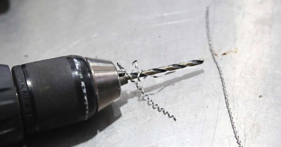

You are probably going too fast. There is actually a formula for RPM based on diameter, material and feed rate.
Anyway, heat is the enemy. Like BBQ, low and slow. 200- 500 is probably good enough. You should see curly strands of metal coming out. Too fast and the cutting edge will overheat and not bite in. Heat and not drilling straight will break bits. If you are using a cordless, the trigger should be barely pulled.

I'm still trying to figure out why you can't use your drill press ?
I'd center punch, then hold the steel near '511' and drill the holes.
2nd choice, clamp to workbench and drill....
Am I not seeing this project right ??
My drill press is a bench top. The holes to be drilled are marked on the inside. Once I get break through I was able to flip the guard over and get after it with the 3/8” drill. That was able to spit out nice pieces of steel.

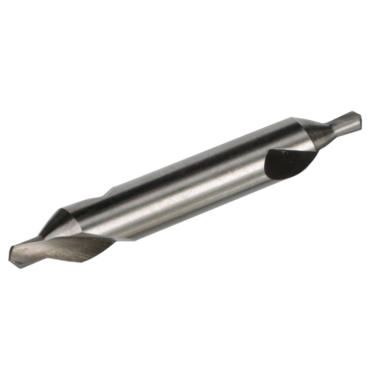

Here is an inexpensive, accurate, and hard to break way to start freehand and machine drilled holes. Spot it then drill to full size.
A "cheap imported" #4 HSS double end center drill is less than $2. Step drills are sheetmetal, carpenter, electrician, and plumber tools.
I have those…from my mill….and used them. Good suggestion.
