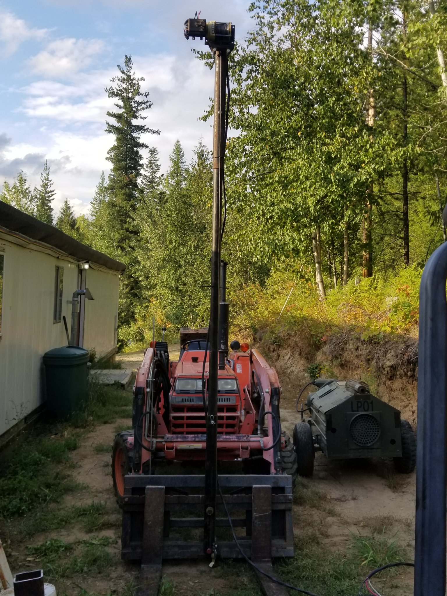

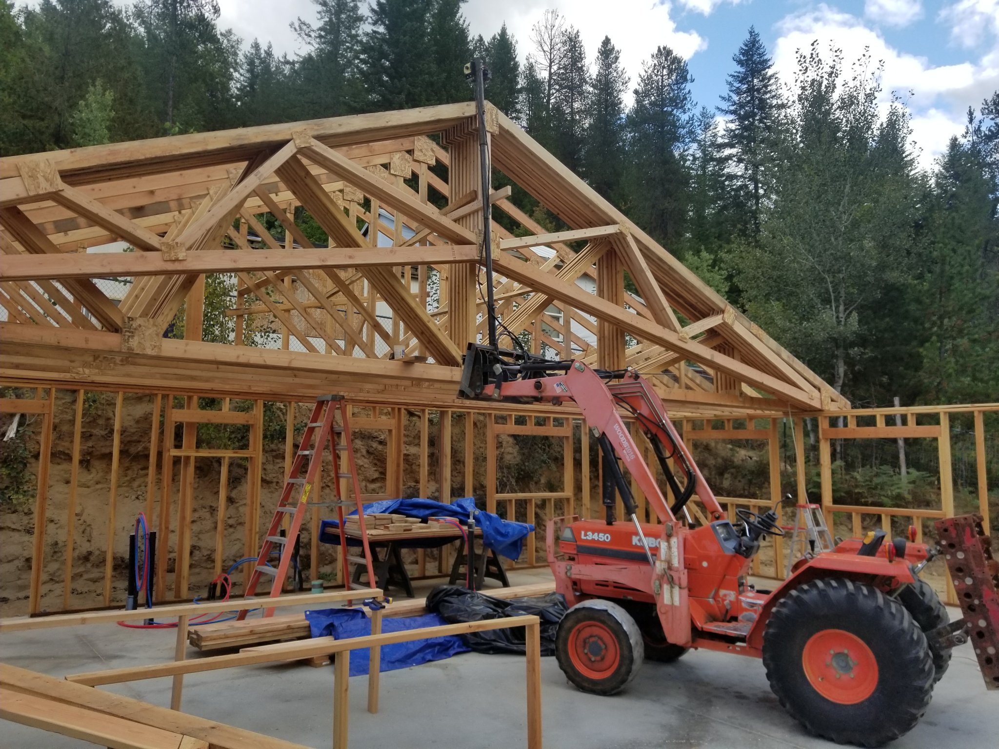

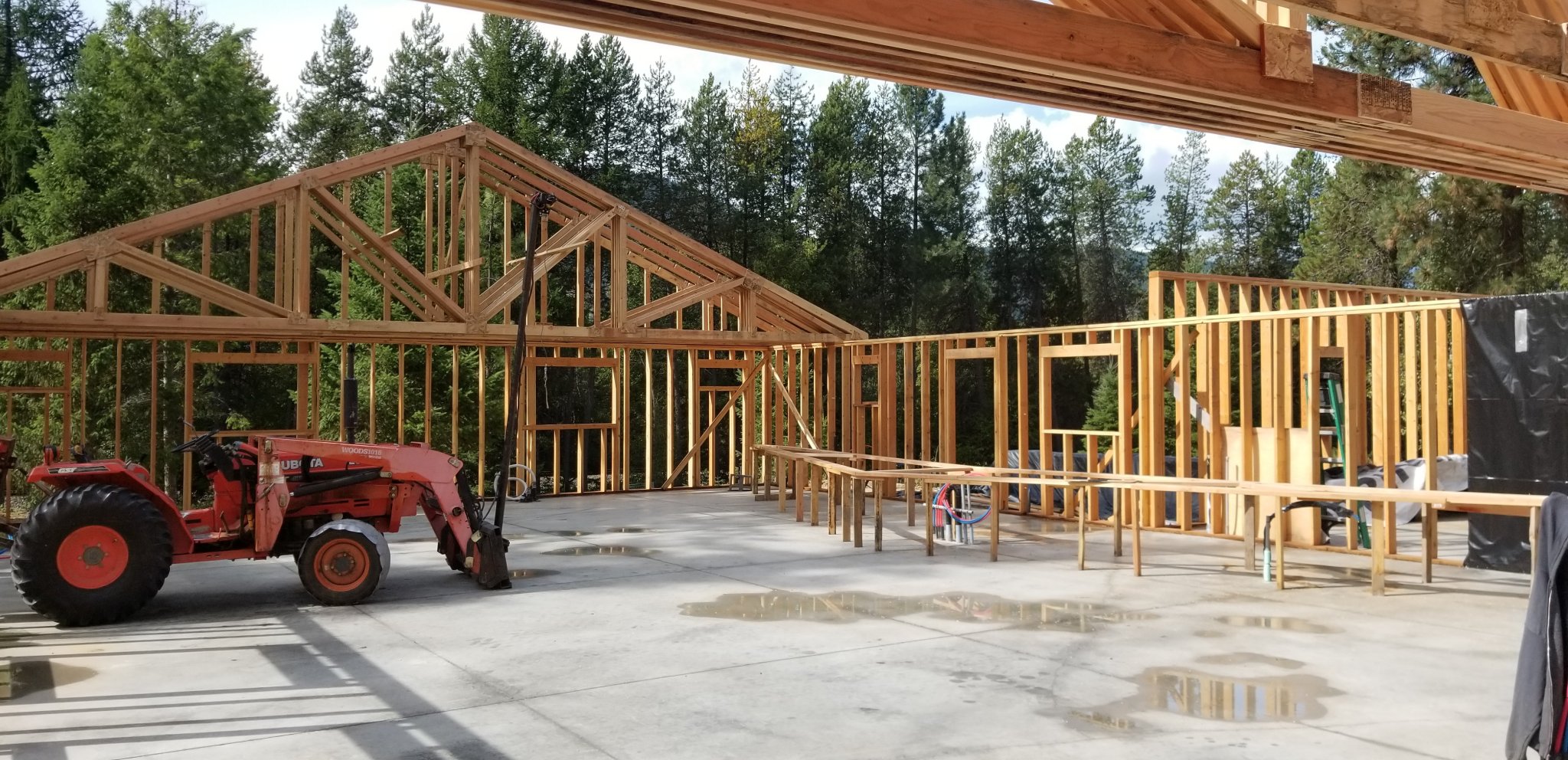

28,646
5,091
This was my solution:
It has a ATV winch (which would have been better mounted lower) that has a remote control.
I ran it off a small battery strapped to the fork frame.
Much smoother setting the trusses with it that it was with Loader controls, and an added bonus I could shimmy up a ladder lift them just enough to move them into place and then set them down and pin them up right.
Could lift the trusses up from the center about 1/3 down easily, and they are up there 19 foot to the peak.
