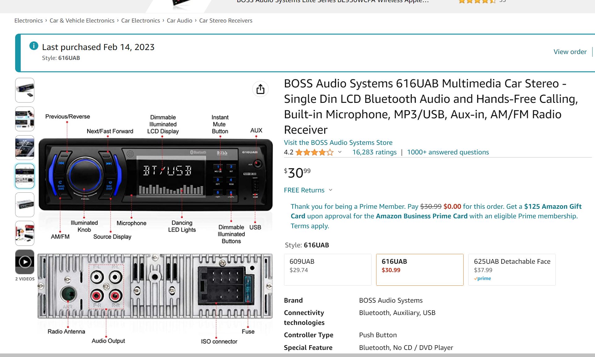

I put one the cheap boss audio radios in mine a couple of months ago. Nothing great, but it certainly works just fine.
Here's the one I used (with the correct wiring plugs).

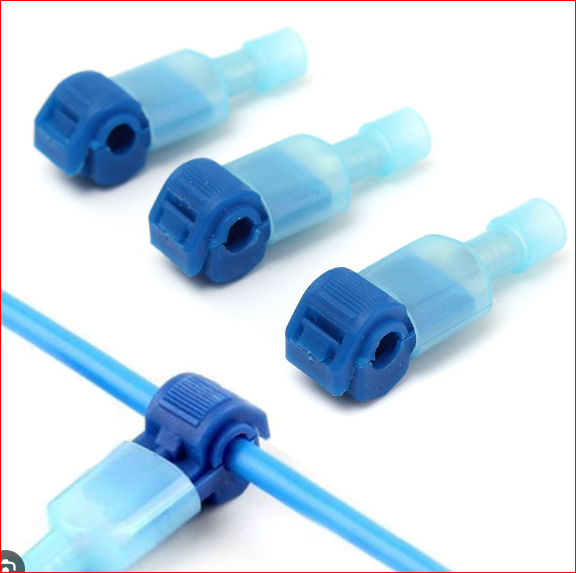

And if you do not want to cut those leads from the U27-4 - you can tap off the wire and and each coming from the new stereo.

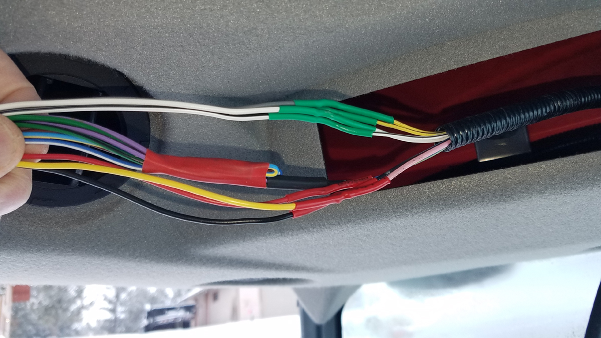

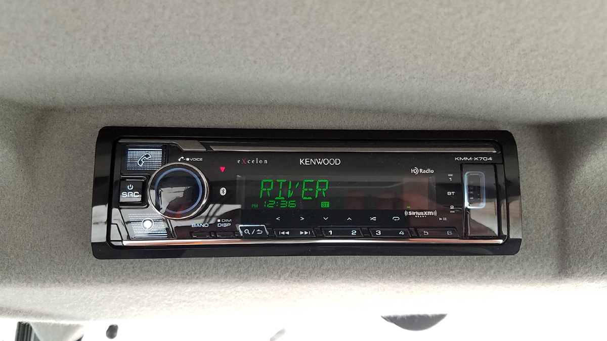

I have the same head units in both tractors in the form of a Kenwood KMM-X704. I always solder and heat shrink connections regardless of what the vehicle is.
