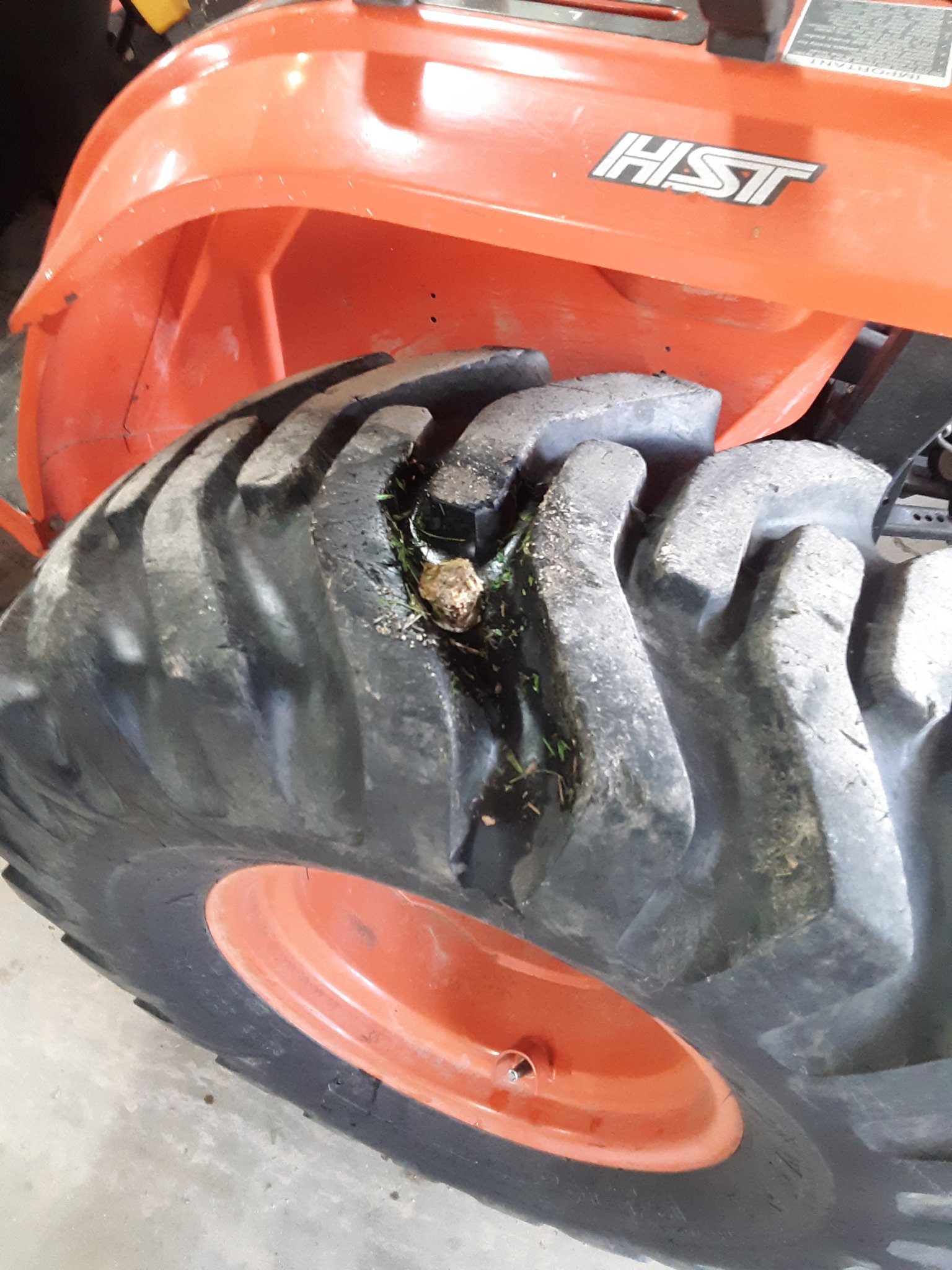

I done it this time. I got a giant 1/2" sticker or wood chunk stuck in my rear filled tire. What do you guys do to fix a hole this big?
I have had holes before and just put a plug in them. I don't think a plug will work on this but who knows? Do I put a tube in or is it time to get a new tire? I got work to do and this sucks...
Please let me know how you guys deal with this issue.
thanks

Definitely repairable. Reinforced boot, uncured rubber, A-B compound with mesh, etc. I made a big homemade c-clamp from 2x2 square tubing for large repairs like this. Many YouTube videos on this kind of repair.

Thanks guys! I drained off the fluid to a big trash can and took the wheel/tire to my local tire shop. They patched it from the inside and were super cool about it. Got it back and put the fluid back in and so far it's been fine. I am glad I don't have a "big" tractor :)
