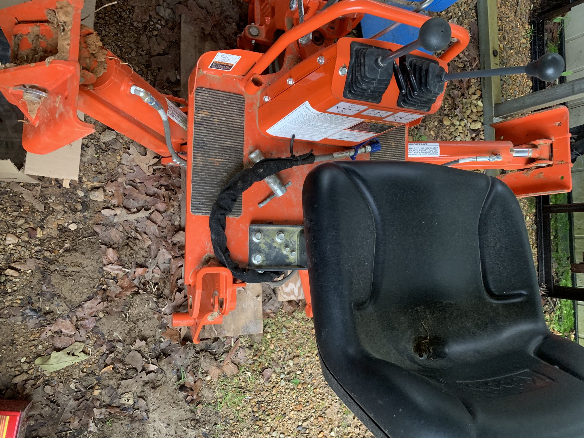

The seat is bolted to the backhoe frame, not the subframe on the tractor.
just for clarity

Fordtech, do you have a part number for the seat stick? I can’t find it and they gave me a bh70 owners manual
This is the best I could come up with. If you go to the German bliss site and search bh77.
then go down to operators platform group. Ill try to link it straight to page.
I don’t see where the list a complete assembly though, looks like only the individual pieces. No prices listed either, says to call.
