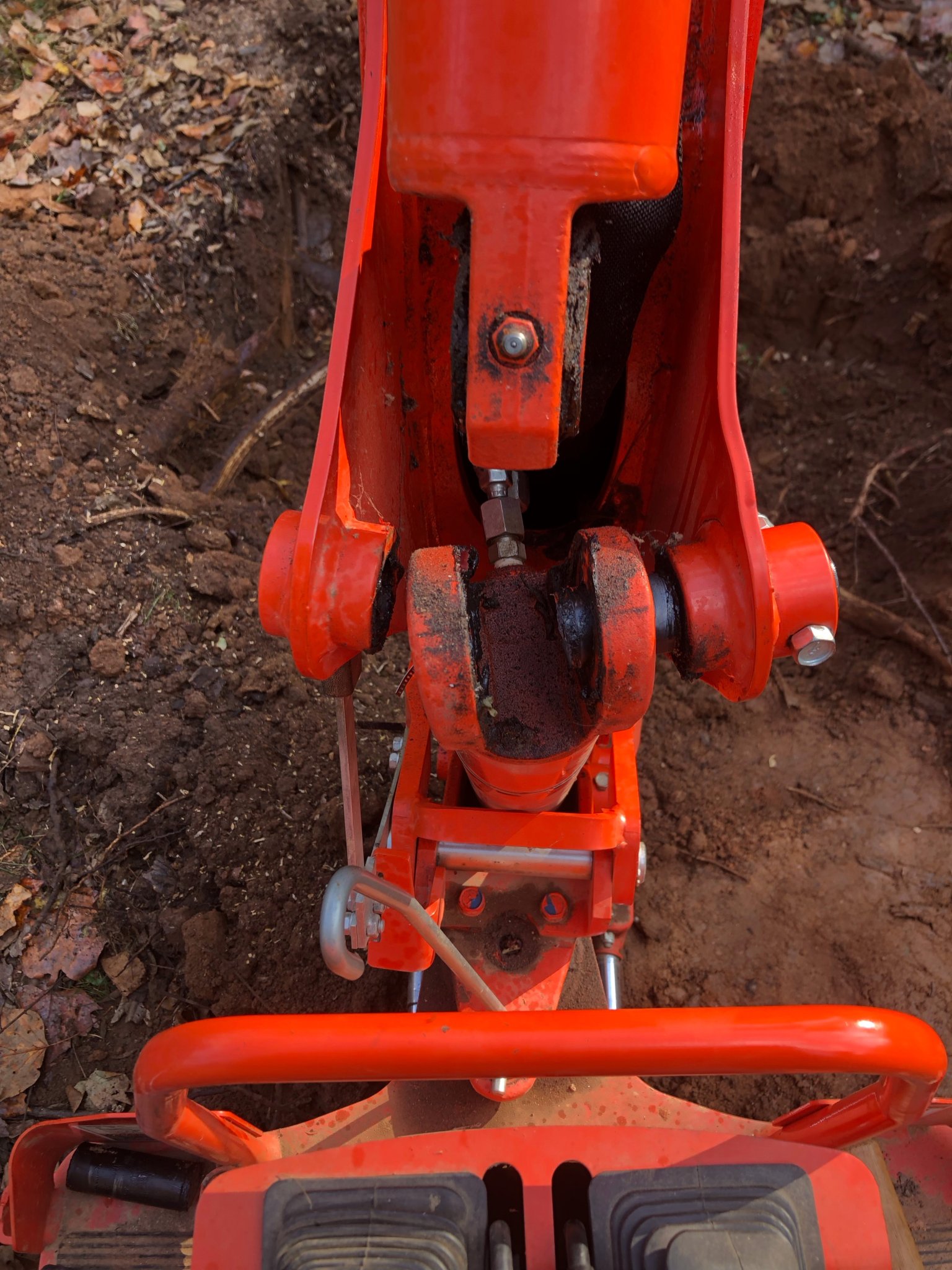

Yes my pin broke just the other day ( BH 77 ). I heard a pop earlier and didn't know what it was and then saw the pin hanging out and a bent ear. Just called my local dealer and gave him part # 7K503-23152 , but this is the old part and #7K503-23160 supersedes the old one. I talked to the shop foreman and he said there was no recall. My serial # is A0539
A0539 is not affected. IIRC A1200 was the last of the BH77's with the "recall"; but this is a 6 year old bulletin and you're best bet is to contact a dealer. There weren't that many affected serial #'s.
