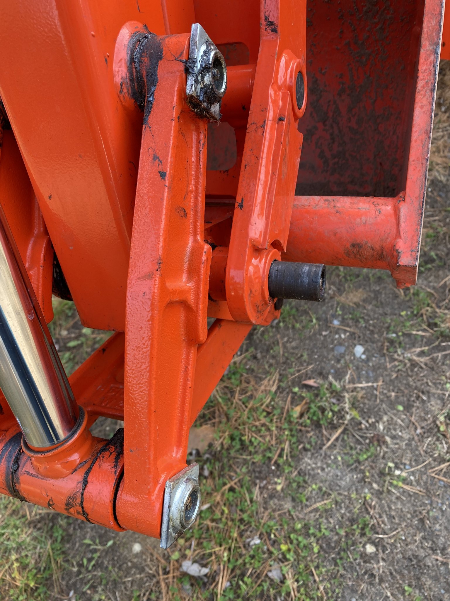

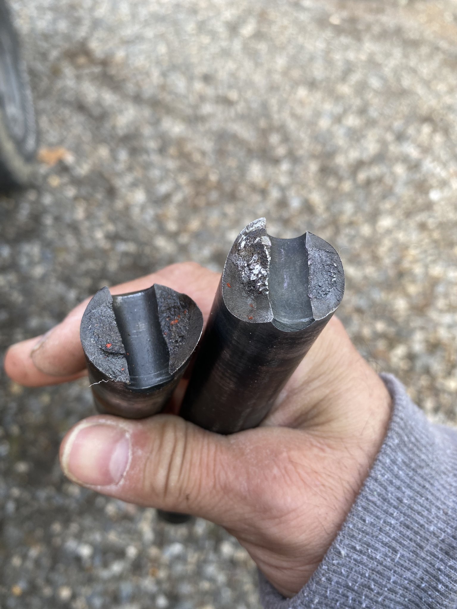

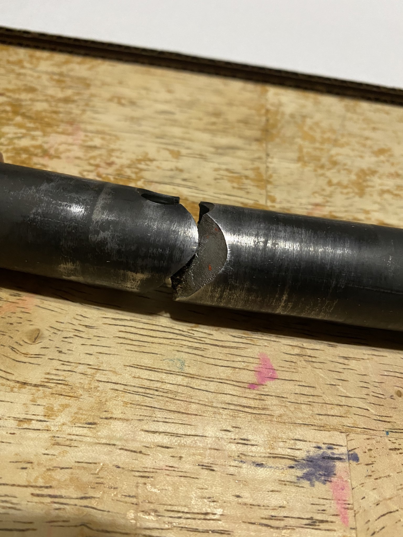

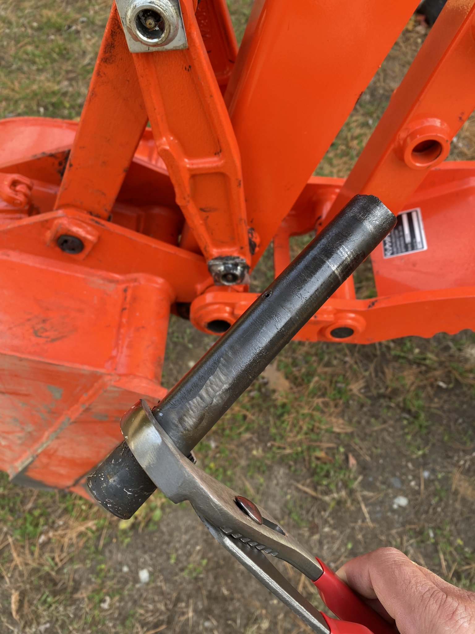

Did a walk around on my backhoe yesterday and notice the pin hanging out about two inches on the end of the dipper. The day i got My machine it was hanging out and inch and i thought It looked funny, tried to bang it in and it didn’t move. But never took pliers to it. Took pliers to it this time and it spun right around and pulled out. Anyone else have this problem lately? I saw Some super old posts about it. But nothing newer. Called Kubota and they didn’t have a recall on it.
