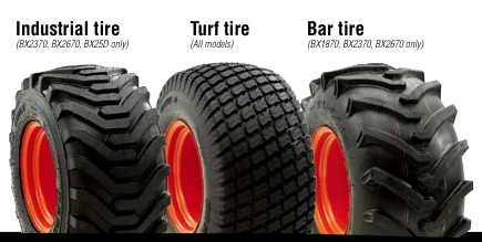

The Ballast box will help the most.
What tires do you have? and what pressure do you have them set at?
If you have R4 / Industrial tires, they just suck for traction and letting air out does not help them much. If you have R1's / Agricultural tires, running them with less pressure to the point where they squat down helps put more surface to the ground.
will I be able to pull that info off the tires themselves? I'll get whatever the tire stamp is and post here.

From left to right, R4, R3 , R1. Also Industrial, Turf, Ag.
I dont see the term bar tire used much anymore, i think because the proliferation of r4s made it kind of overly vague.
