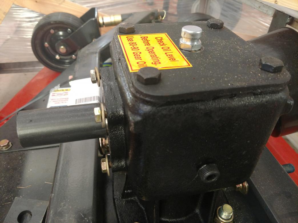

Here's my Betstco gearbox with the oil level plug on the side and Fill plug on top. I can't imagine it needing more than 1 qt.

Wow, I wish mine looked like that! They must have changed the design, because I have no drain plug at all. Thanks, GeoHorn.

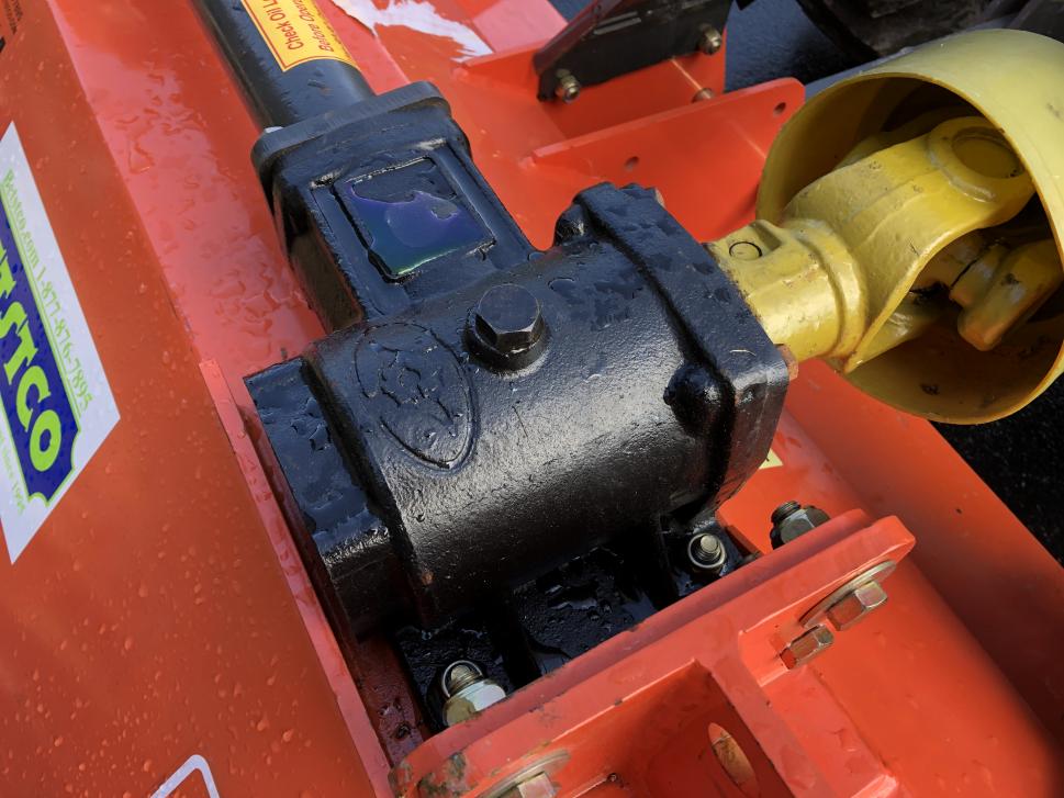

Wolfman, here's a picture of my gearbox. Just a fill plug with no vent.
This is the first image that I've tried to attach, so no guarantees that it worked correctly!

UPDATE: I just found a TINY vent hole in the filler plug, which hopefully will prevent seals from blowing out if there's too much oil. The actual problem began when someone at Betstco filled it right to the brim with oil. They swear that they won't ship anything with oil in it, but they sure did this one. I'm just going to go ahead and run it and not worry too much. I wish they hadn't changed the design away from a gearbox with a drain plug. Thanks everybody!
