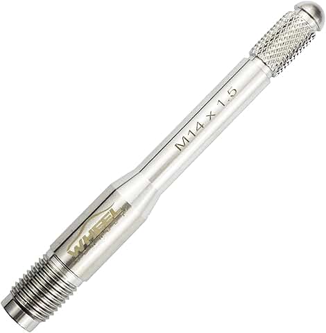

  • Unique Bargains M14x1.5 Wheel Alignment Pin Mounting Car Wheel Hanger Rim Stud Bolt Nut Tire Change Guide Tool
  • Color: Black, Material: Iron, Thread Size: M14x1.5, Length: 120mm / 4.72"(L).
  • The round contour handles are comfortable to grip.
  • How to Use: Screw the wheel alignment pin tool into your wheel hub; Recessed area on the shaft to keeps your wheel from sliding off the wheel hanger studs; Simply screw in remaining nuts to secure tire into place.
  • Durable material construction provides longevity.
  • Wheel stud alignment tools will not bend and rust.
Buy the size you need. Get pin started in one hole and then rotate the tire to get the studs started.
