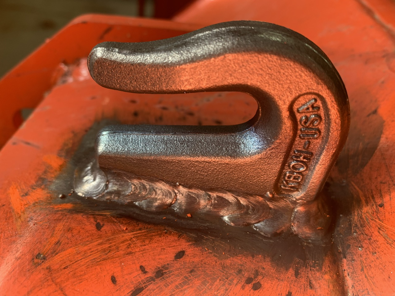

Weld’em on!
I don’t have a picture of it, but these are inline with my loader cylinders. Luckily my bucket on the MX has a nice flat spot to weld to.

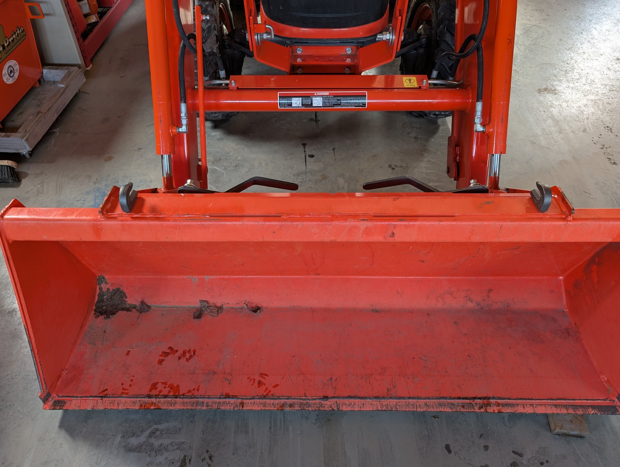

So this would be a good safe spot, it's right inline with the curl cylinders.
Also probably should repaint the bucket this spring. Although it's gonna get all scrapped up anyways.
34,141
9,330
Yes that is the perfect location!

Wish I could weld like that
Not quite a stack of dimes but definitely a roll of nickels. Good job!
My welds are consistently terrible. Ray Charles could probably weld better than me with his feet.
I have good days and bad days. When in doubt, turn up the heat! And then there’s the days I forget to turn the gas on…

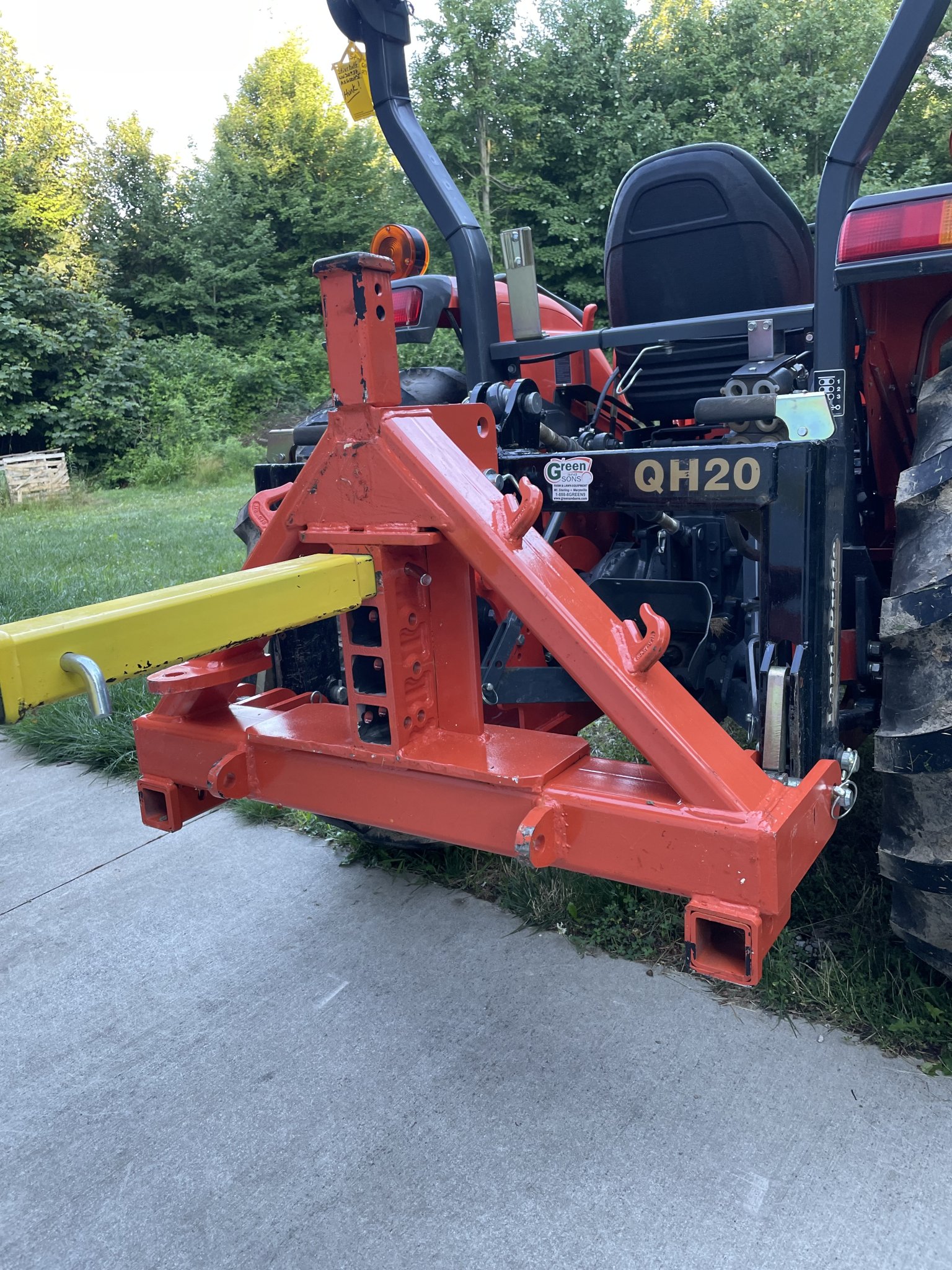

Thanks for the mentions guys, we greatly appreciate it!
NP…great products and service sir. Your hooks are not only accessorizing
my buckets(2) but I have some jewelry on my triangle too!
