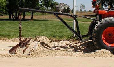

Below are 2-1/2 DIY implements. I had the weld shop at work make the top one for our large gravel laydown area behind the shop. The lower two (or 1-1/2?) are two versions of a fabricobbled drag made of a pair of I-beams. The first rendition was to smooth a sand volleyball court I made for the kids. It's on a B7500 in the lower picture. The boom pole mounting worked nicely (but was cumbersome). A chain on each side could be lengthened / shortened to cast material to either side.
The center pic is a modification of the original I-beam drag. The blind flange provides some weight and a pin dropped through the bolt holes allows setting it to an angle.
