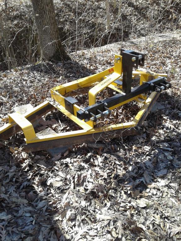

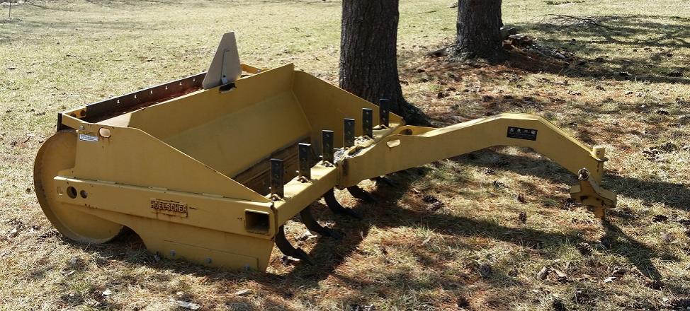

I found this video useful. A hydraulic top link almost seems necessary for box blade. Standard top link ok for most land planes since the sides have steel runners to guide the plane.
https://www.youtube.com/watch?v=wYXcMN7tBjQ
The Agritek plane really needs the hydralic top link. The Hoelscher box blade, the lift arms change the "angle", the major disadvantages - harder to backup, can't lift implement off the ground.
