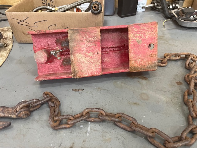

I tossed this together from scrap at work. The pin could be replaced with a ball easily. We have mainly pintle hitches so the pin made sense. I have moved ball hitches with it also.
Chain hooks to fork frame so it doesn’t slide off and pin on bottom keeps it from sliding up the fork blade.

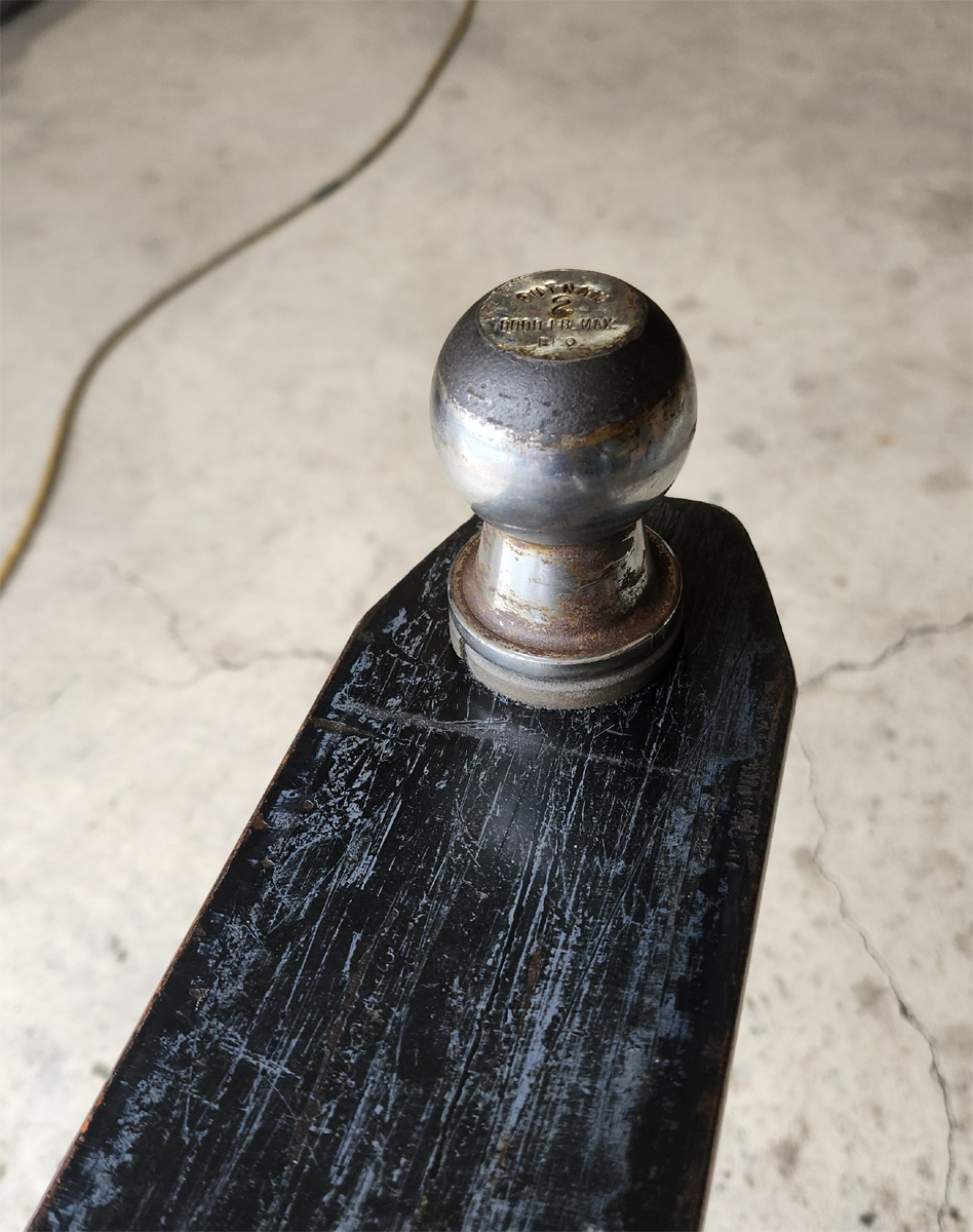

I drilled both forks for a ball, if real heavy load I have a piece that goes on both forks and there is a pin that drops in the holes at the ends of the forks. It divides the load.

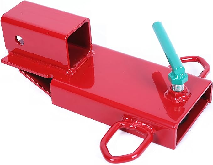

I bought one of these: https://www.amazon.com/gp/product/B01N193WWU/ref=ppx_yo_dt_b_search_asin_title?ie=UTF8&psc=1
But then drilled a 3/4” hole about ten inches from the tip of my left fork...to accept a ball…OR to accept the threaded pin of the adaptor. (It takes a cobalt bit to drill that fork…it’s really hard steel.… the idea it would void commercial use or home insurance sounds like the typical “lawyer fear-mongering” that goes around.)

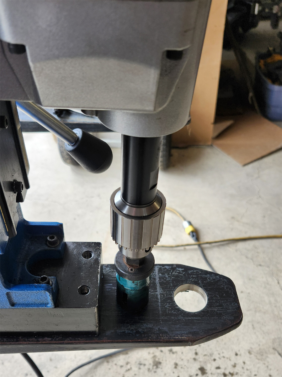

I cut a hole about three inches from the end of one of the forks. I used a hole saw that has seen better days.
