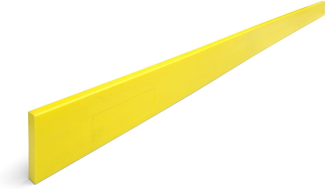

I changed the cutting edge to a UHMW plastic edge like this.
W plasic

Does the plastic cutting edge require special hardware to install, and where did you purchase the cutting edge from. I know that Kubota offers them, but wasn't sure if you might have found a less expensive supplier.
I used the same hardware.
This would probably work fine.
