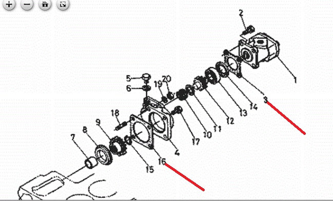

You don't state the model of B8200 and sometimes it makes a difference.
I see gaskets
The first is #16 #67810-36420 for $5.29
The second is #3 #15231-87130 for $3.85
If you are going to the work and expense to replace the pump, then consider replacing the suction screen or filter + any seals or O rings on the suction side of the pump.

Thanks for your reply. The data plate on the tractor only shows B8200D. It’s 4WD and is a regular gear drive not the HST.
Your diagram has me wondering if this project is more in-depth then I thought. The WSM shows removing the bolts and separating the pump from the engine. The next step shows removal of the gear pump holder for the 4WD which I wasn’t going to do.
Seems like I’m only looking at half the job?
The parts illustration for the B8200D looks the same as far as the pump is concerned.
I looked at the WSM I have which is not a great one.
I think it is a bit misleading but I have never changed a B8200 pump.
The WSM shows the pump removed from its drive and then talks about removing the pump holder.
I think the misleading part is that the holder does not have to be removed to change the pump but only in a more extensive tear down of the engine.
I also looked at the B8200HST manual which is a bit clearer and again I do not think the holder needs to be removed which makes the job much simpler.

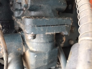

Post a picture of the pump on the tractor if your not sure.

After searching online and not getting a good feeling about what I found I went to the dealership up here. I know that they make mistakes, been there, but hopefully they have the correct pump coming in.
pic showed up sideways?

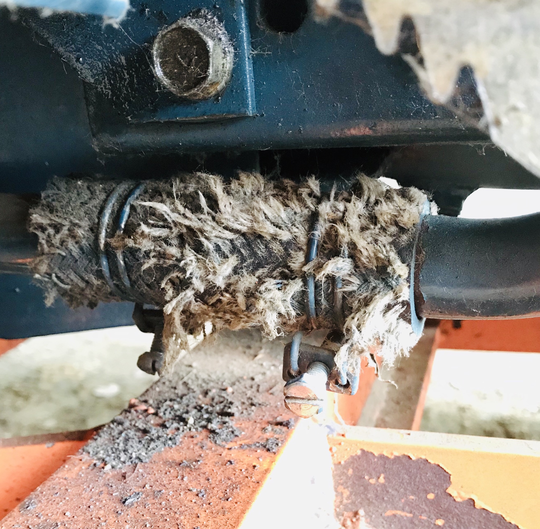

Here’s a picture of a hose that connects the two pipes for the low pressure return line. Think I should replace it?

Yes replace it before filling transmission if you can. It is probably fine but will only cost a few bucks.
