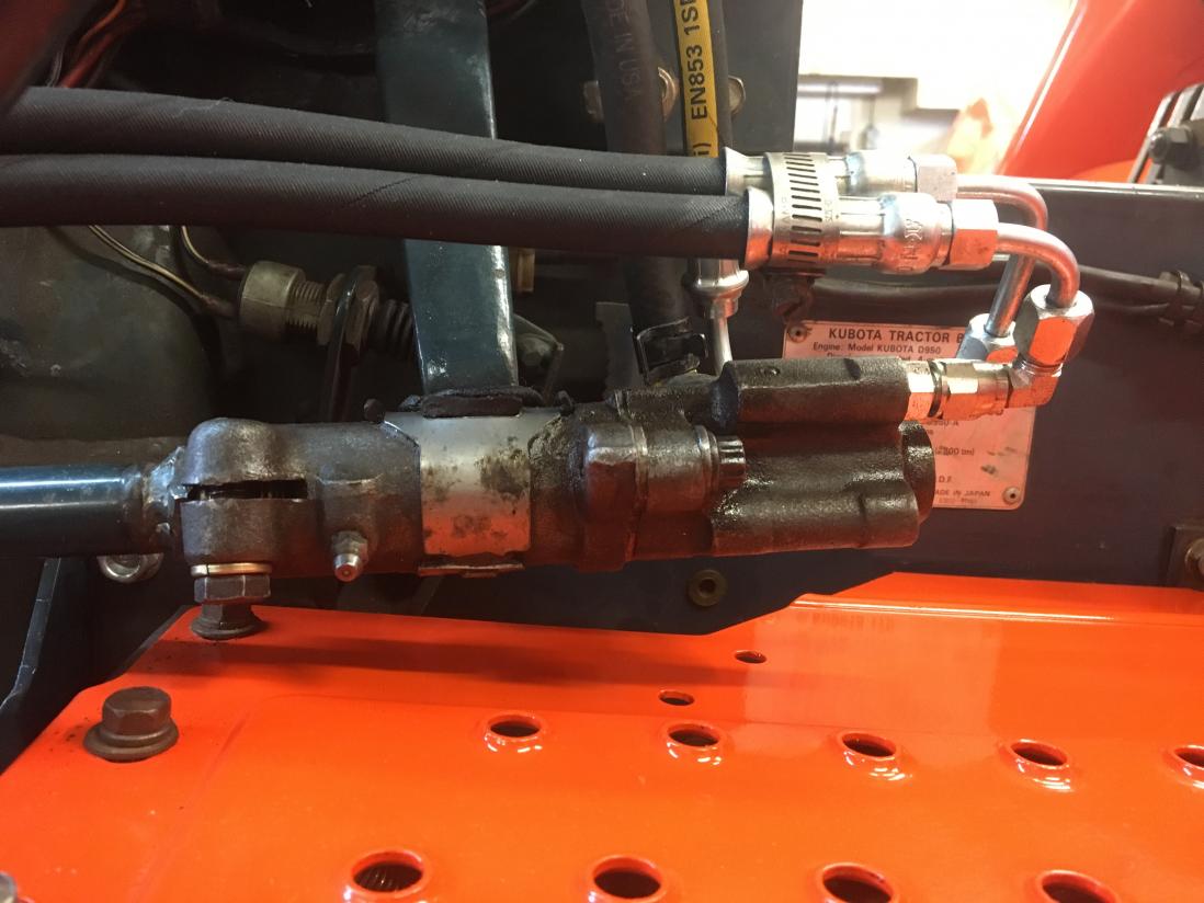

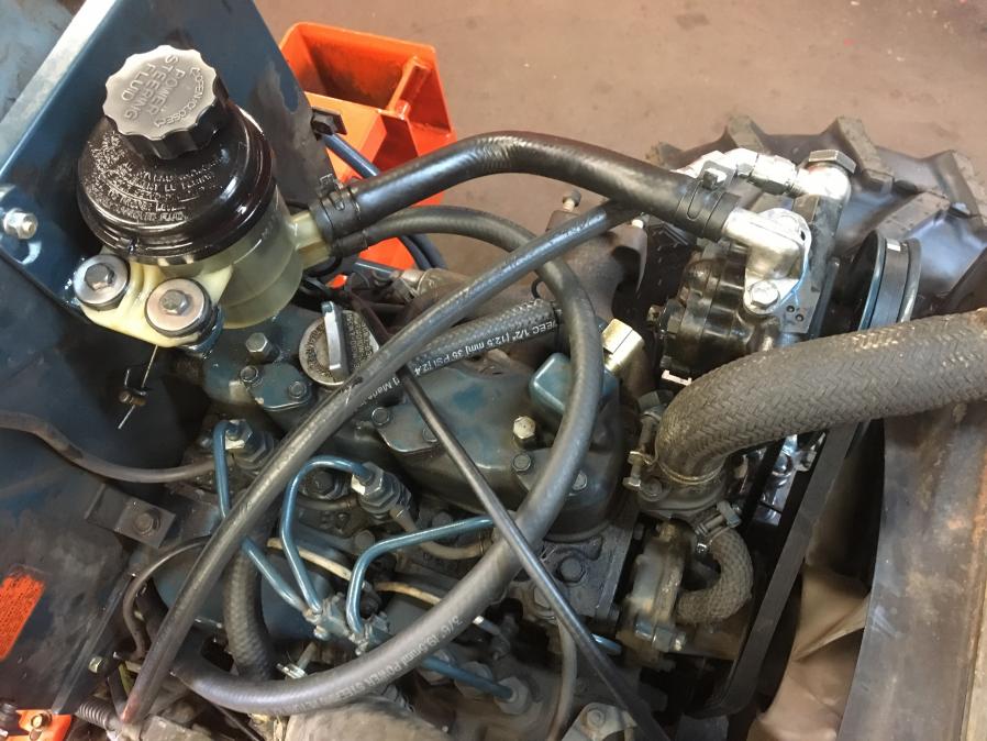

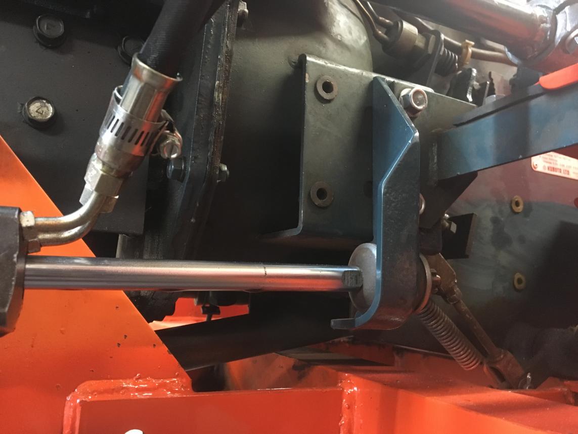

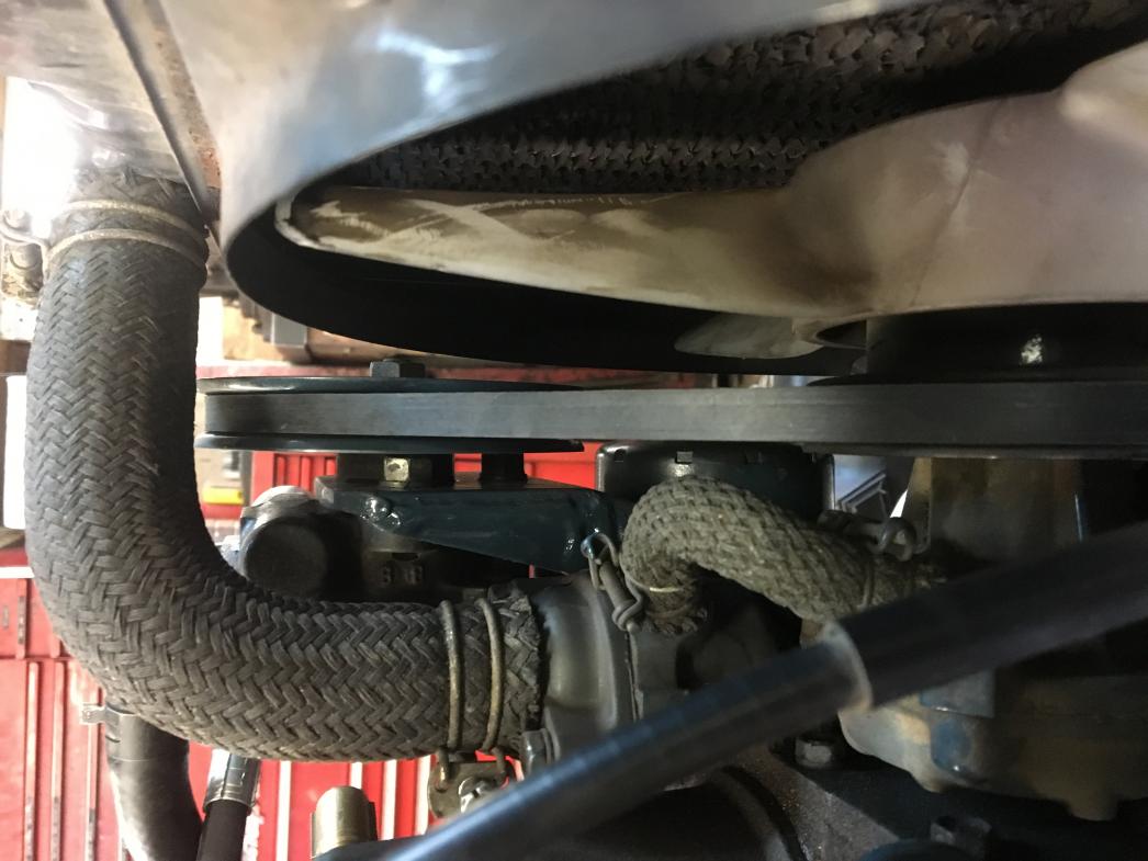

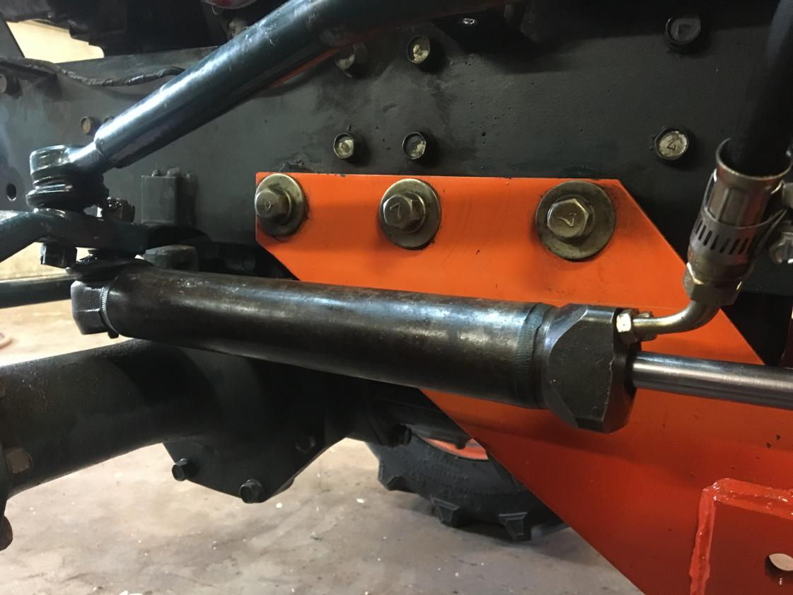

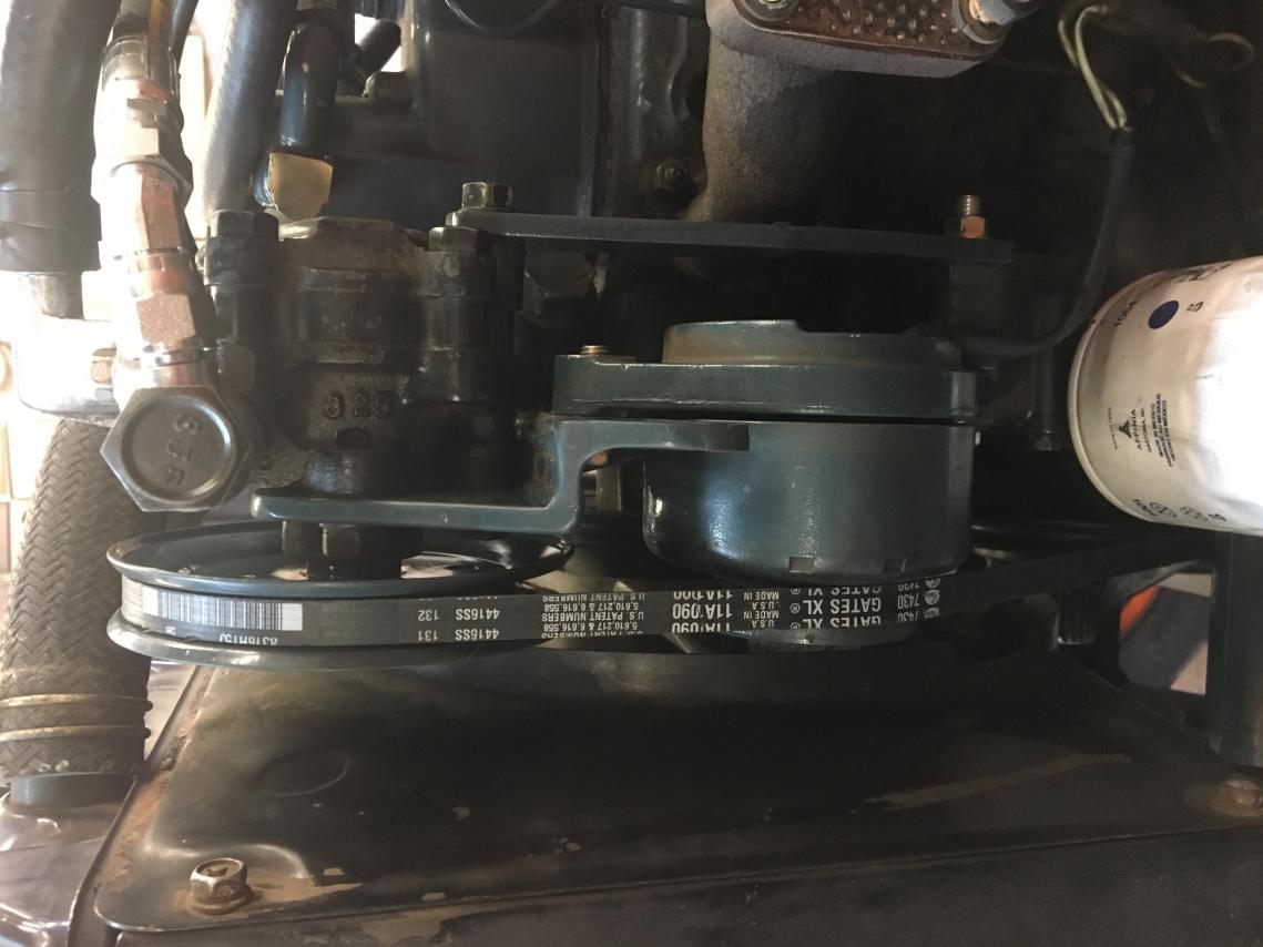

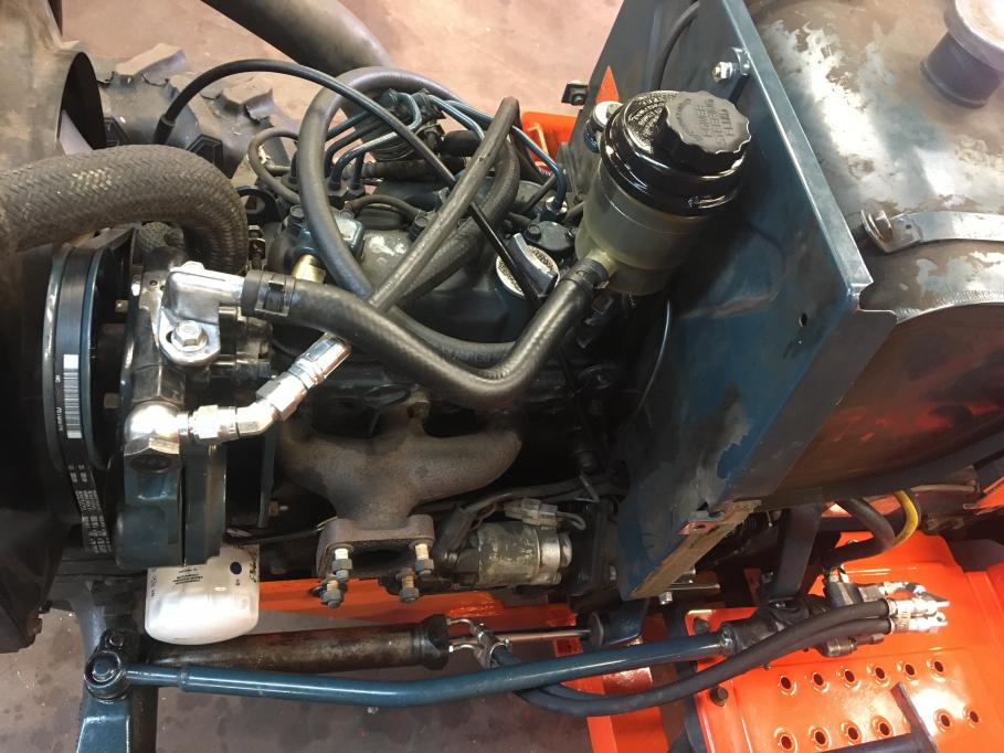

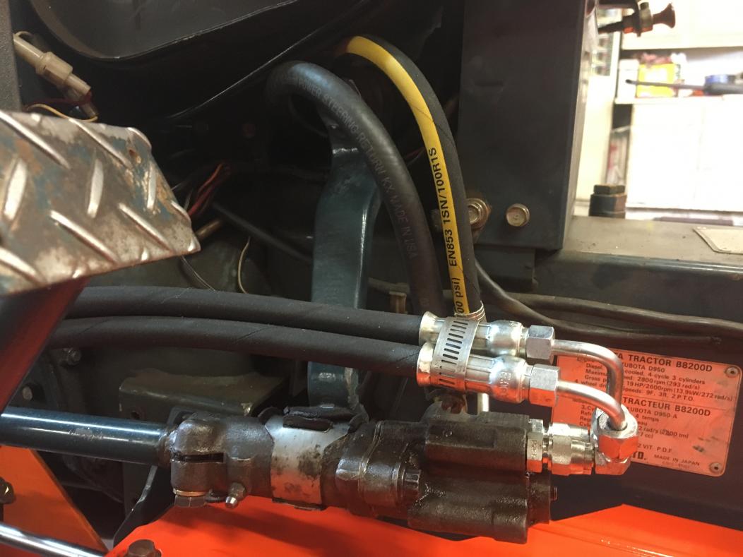

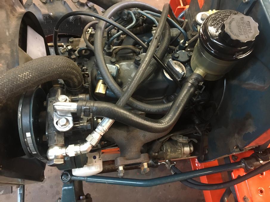

This is the system I have installed on my B8200. It works well and was fairly economical. I have about $400 invested. There may be some better ideas out there, but this is what I did. I also installed this system, using the GM pump on my L245DT about 30 years ago and it is still working fine. This system's pump is from a 1986 Nissan Pathfinder although many others will work. Finding one this small, with a v-belt pulley was difficult. The control valve and slave cylinder is from a 1963-1982 Corvette. Many are available on eBay. The reservoir is from a 2006 Hyundai, but again many others will work. I had the hoses made at a local hydraulic shop. The brackets for the pump, slave cylinder and reservoir, I fabricated out of scrap steel. This is a power assist system which allows for much quicker steering than a hydro-static system and still provides steering capabilities in the event of a failure of the system. I hope this is helpful.

I would also be interested in more information on this. Preferably, at 3 of the 4 attachment points.
1. The point at bottom of the pitman arm coming from the steering box that attaches to the hydraulic control.
2.The second point at the threaded end of the hydraulic control attaching to the drag link.
3. The third point where one end of the cylinder attaches to the knuckle arm at the top of the king pin.

im wanting to put the power steering assist on my L245dt. i know this thread is pretty old but maybe you can help. did you mount the power steering pump on the left side of engine as in the picutre. my alternator is on the left. is the picture of a L245dt or the b8200. any help would be appreciated. thanks doc
