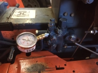

I did purchase a WSM also and have ordered a hydraulic pressure gauge

With the issues you have I would say you have something going on in the control that is out adjustment, plugged or broken.
I would wait till you get a gauge and test the system pressures as that will tell you quite a bit, and give you a direction to go.
Does moving the three point control change the engine sound at all?

engine doesnt change at all .. with the feed back arm off if I lift the lift arm to full lift and hit the feedback arm on the 3 pt control box it pushed the lift arm down completely one other thing is that when raising the 3 pt arms manually i hear a clink sound .. what is the connection thread to attach the hyd gauge ?
