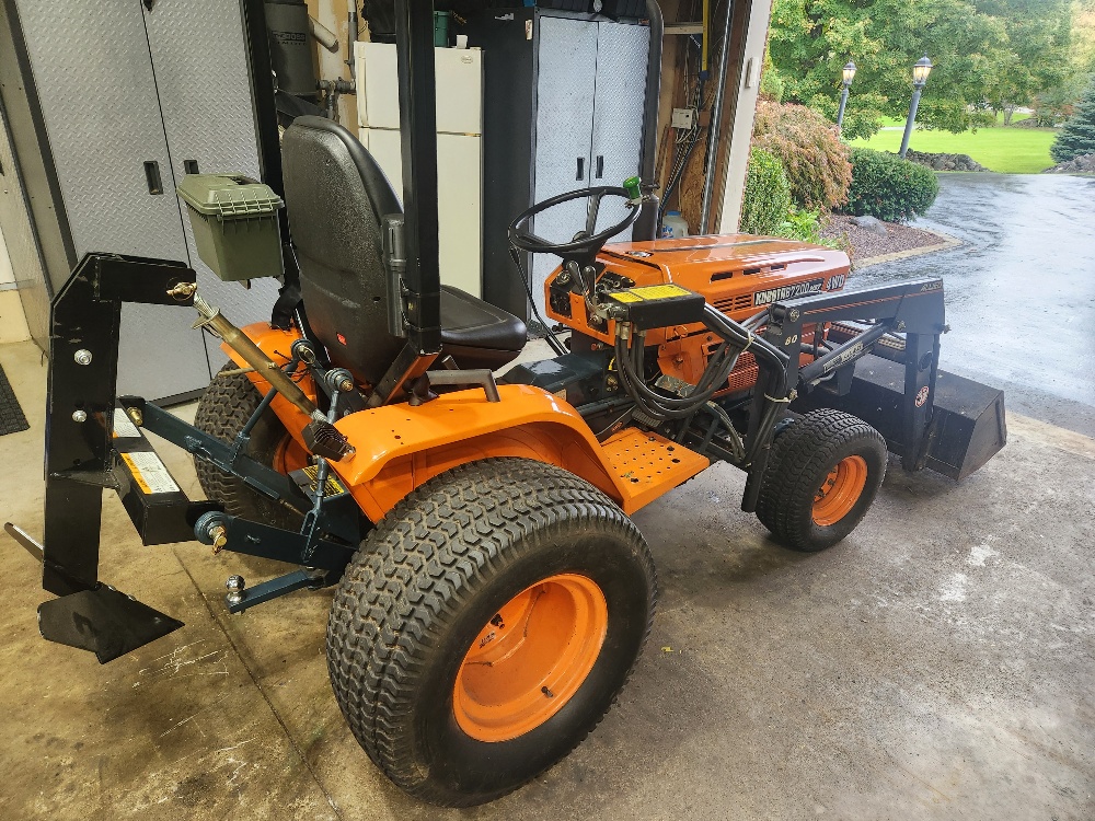

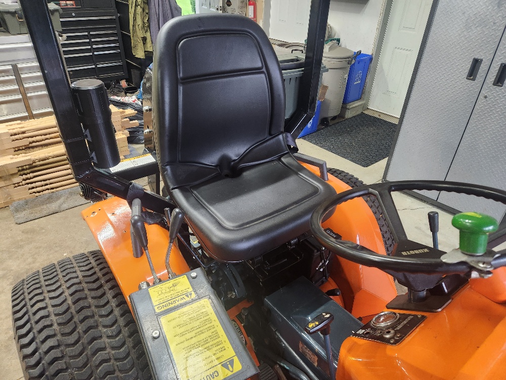

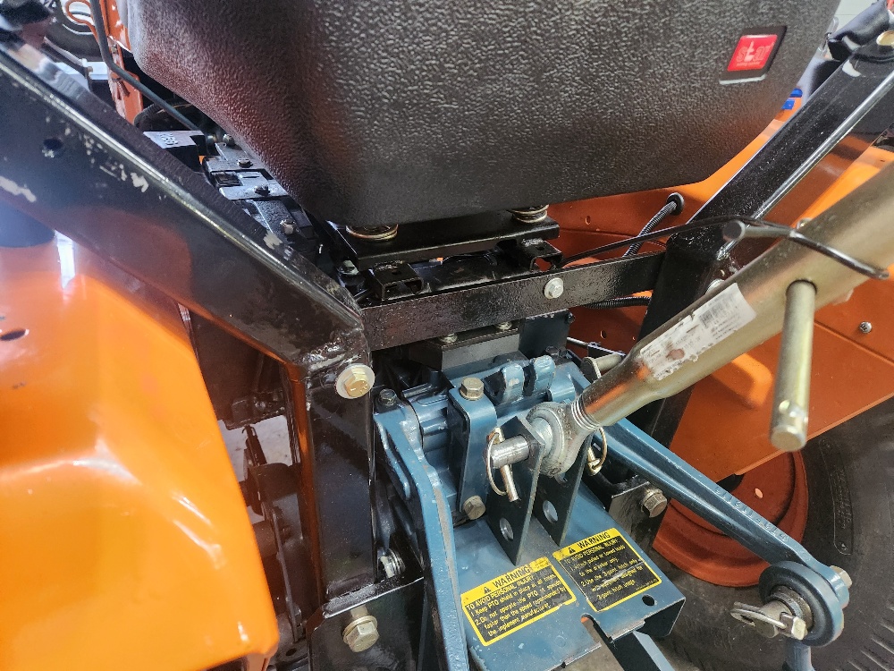

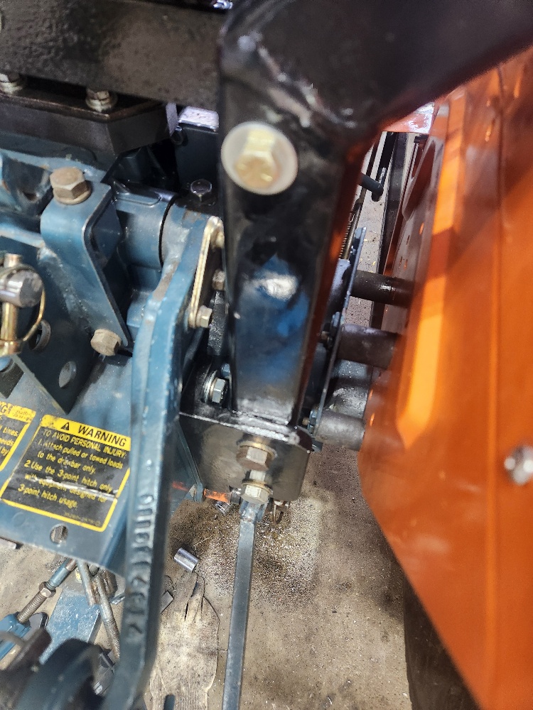

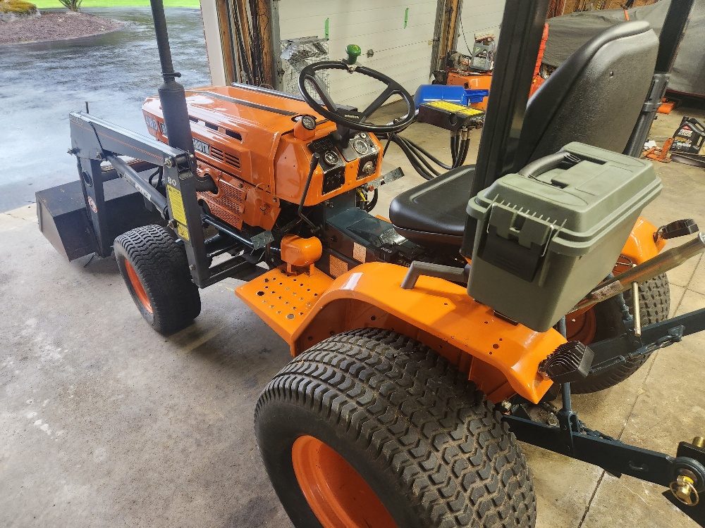

You inspired me to do the same.
Steel cost me about $130.
Took about 8hrs over a span of 2 days, to cut, fabricate, weld, paint and bolt it all together.

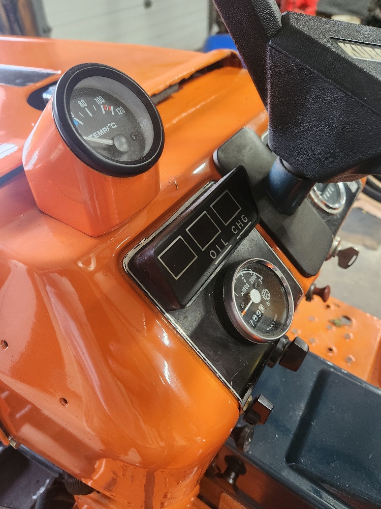

I overhauled the tractor as well - fixed a number of minor issues. Added a coolant reservoir tank. Added temp sensor and gauge (with a 3d printed gauge pedestal). Added LED work-lights to rear fenders and top of ROPS. And a Tool box.
It's almost ready - but I decided to add power steering. Still figuring out if I will install the C3 corvette power assist, or a marine IO drive power assist. If you have some insight into this, that will make the installation easier and/or cheap - let me know.

Nice job man!
I dig the thermos holder too. (y) (y) (y)
