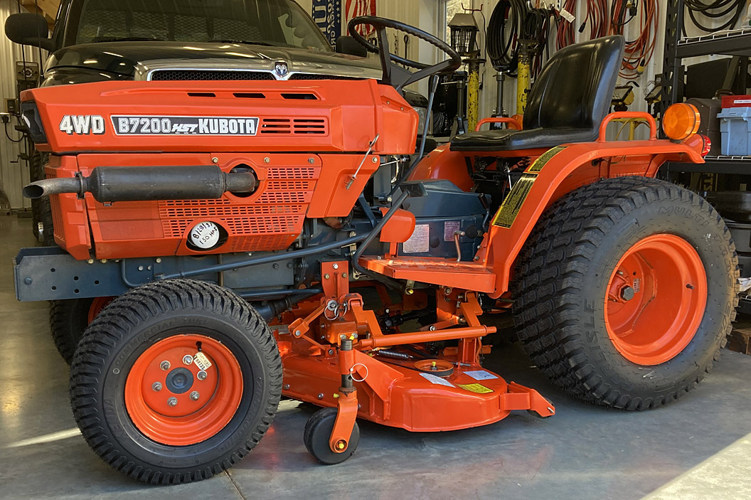

B7200 exhaust up or forward
MikeG6
B7200, RC48-62H mower, snowblower
Jul 26, 2022
11
The internet images of the exhaust sometimes appear to be forward on my B7200 especially when shown with a mower deck. When I bought it, it came upward and with a longer tailpipe. I moved it forward, but the tailpiece sticks out way too far, and the clamp was tightened so much that this piece is crimped and thus jammed on the muffler.
I would like it positioned forward to cut grass around trees. However, to do so, I will need to exert considerable effort to remove the long pipe.
Is there any reason I shouldn't position it forward before I go through the trouble?

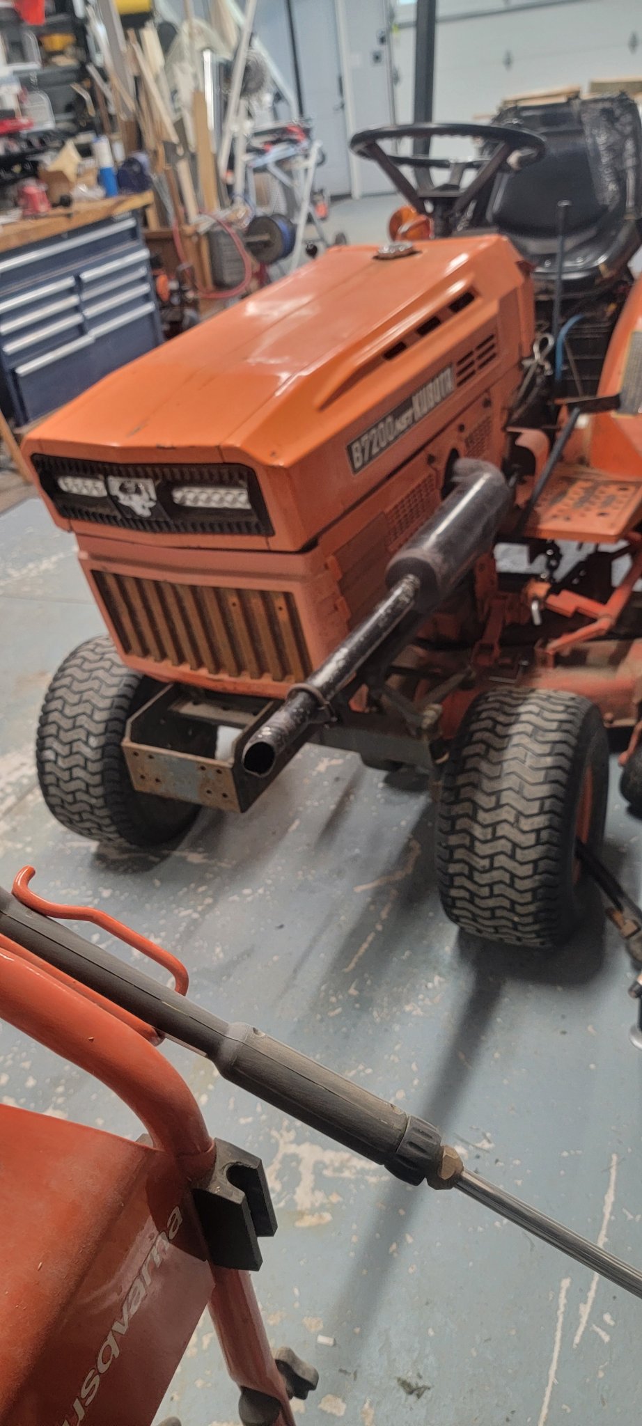

Your B7200 probably had a FEL attached at some point in the past, hence why it was upright with an extension when you got it. For a mowing machine, it's best to mount horizontally like you have it now. Here is a pic of my B7200 with it mounted horizontally minus the extension.

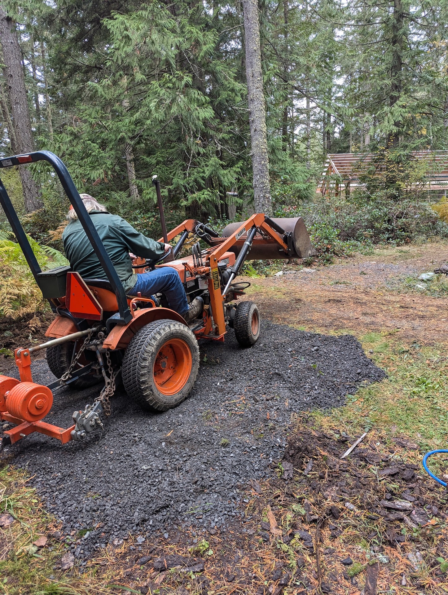

I got really tired of breathing diesel exhaust while mowing w/ our B5100; i rotated the exhaust vertical and added a flapper valve. Big improvement.

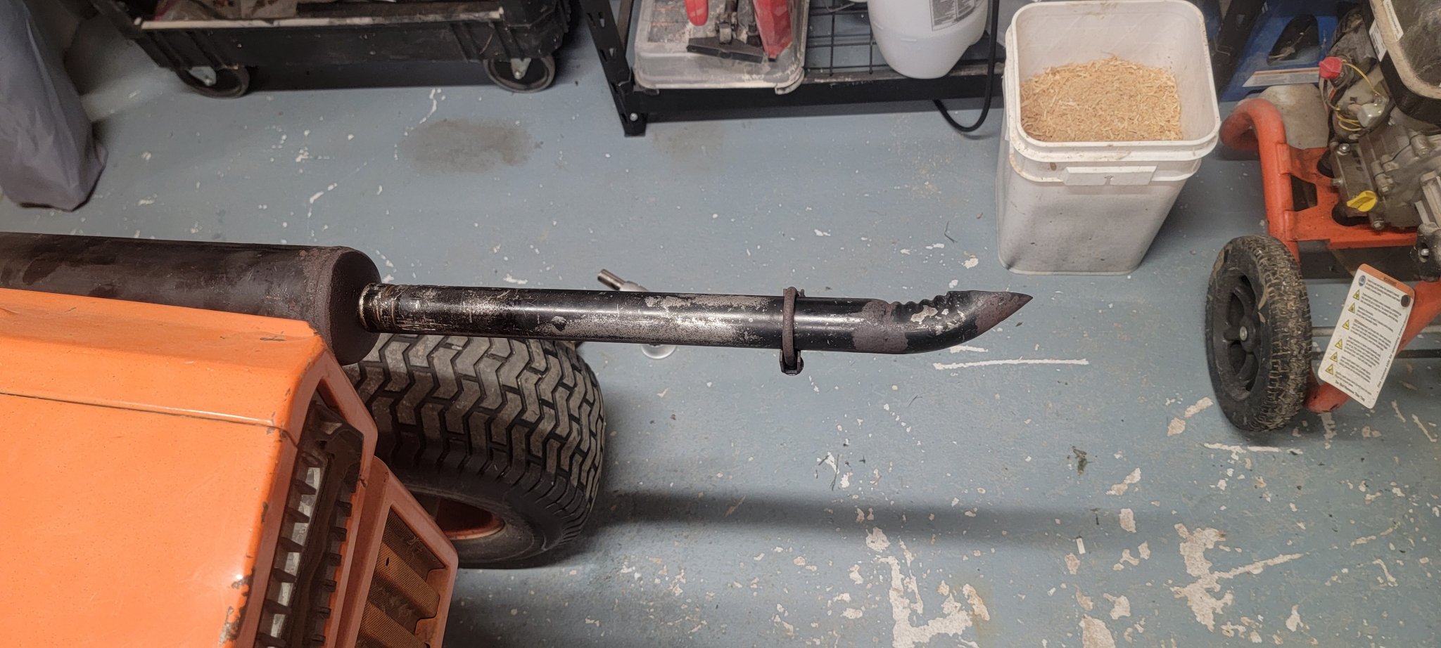

I took mine a little higher, opening 90° to the tractor & down ....
No more fumes.
