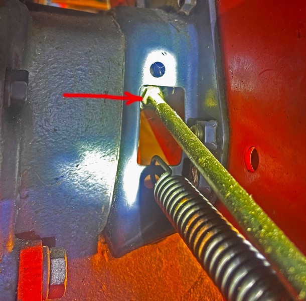

OH. I'm taking a look....
I see this:
SO: IF I temporarily disconnect that spring, and free the other end of that rod, can I rotate it in a ways to have more travel on the brakes?? My brakes don't make any noises but I'm out of adjust range..
Anyone done this??? THANKS!

Yes I did this on my B6000.
I disconnected the spring and other end of the linkage by the brake pedal and turned the whole linkage out of the rear end, adjusted the lock nut in your picture further in (towards the front end) and tightened it back into the brake assembly.
In the picture below you can see the linkage adjusted (bottom rod) as far as it would go, which gave me some brakes as opposed to nothing
