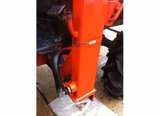

If it's a B219, (see pics below) the ID plate/sticker will be on the inside of the left upright.
The B219 also has the reservoir in the right upright, and the large fitting that the return hose goes into is a filter screen, and needs to be checked. Also, if it was as dirty as mine was, the lower end of that tank upright needs to be checked for dirt/sticks/leaves/dead possums.

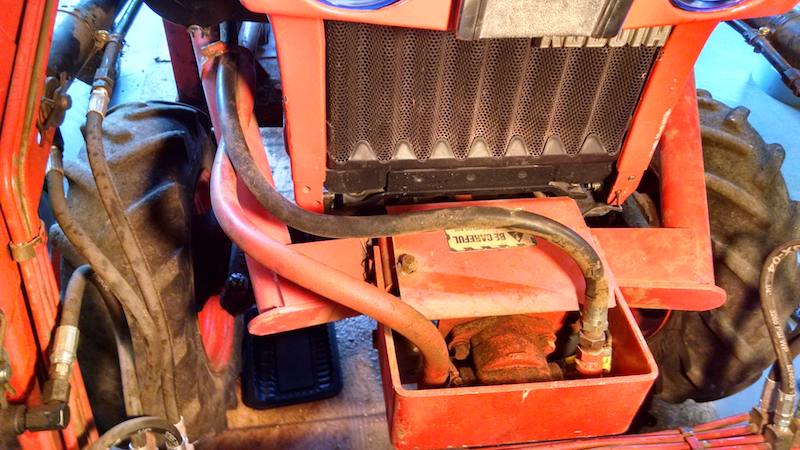

The B219 used a pump driven off the crankshaft, and some have been converted to use the tractor's internal hydraulic pump, with has a lower GPM, resulting in slower operation.

The bottom of my tank was sludge. I used a small hand pump designed for pumping lower unit oil ect. I’d add fluid, stir it all up with a bent wire through the pickup port, then pump it out. It took several repeats to get it cleaned out.
I then filled it with fluid and exercised the loader for several minutes then did a drain and fill. I repeated this 3x like one would do with an auto tranny. I’m not sure this is the best way, but it worked well for me. I figure moving forward I can do an annual drain and fill and be good.
The manual says to do a drain and fill every 200 hours and to use 10w-30 ms oil or type F ATF. I first used the motor oil, but then switched to the 30w Universal tractor/trans oil I use in the tranny. It seems to like the hydro fluid better than the engine oil. Finding non-detergent engine oil was a pain.
My 219 has a Cessna 24205 RAJ pump on the front and is fairly slow, but will easily lift the front of the tractor up even at idle.
I don’t know if the lack of speed is pump volume or the tiny little hydraulic lines. Increasing the RPM’s doesn’t increase the speed much.
