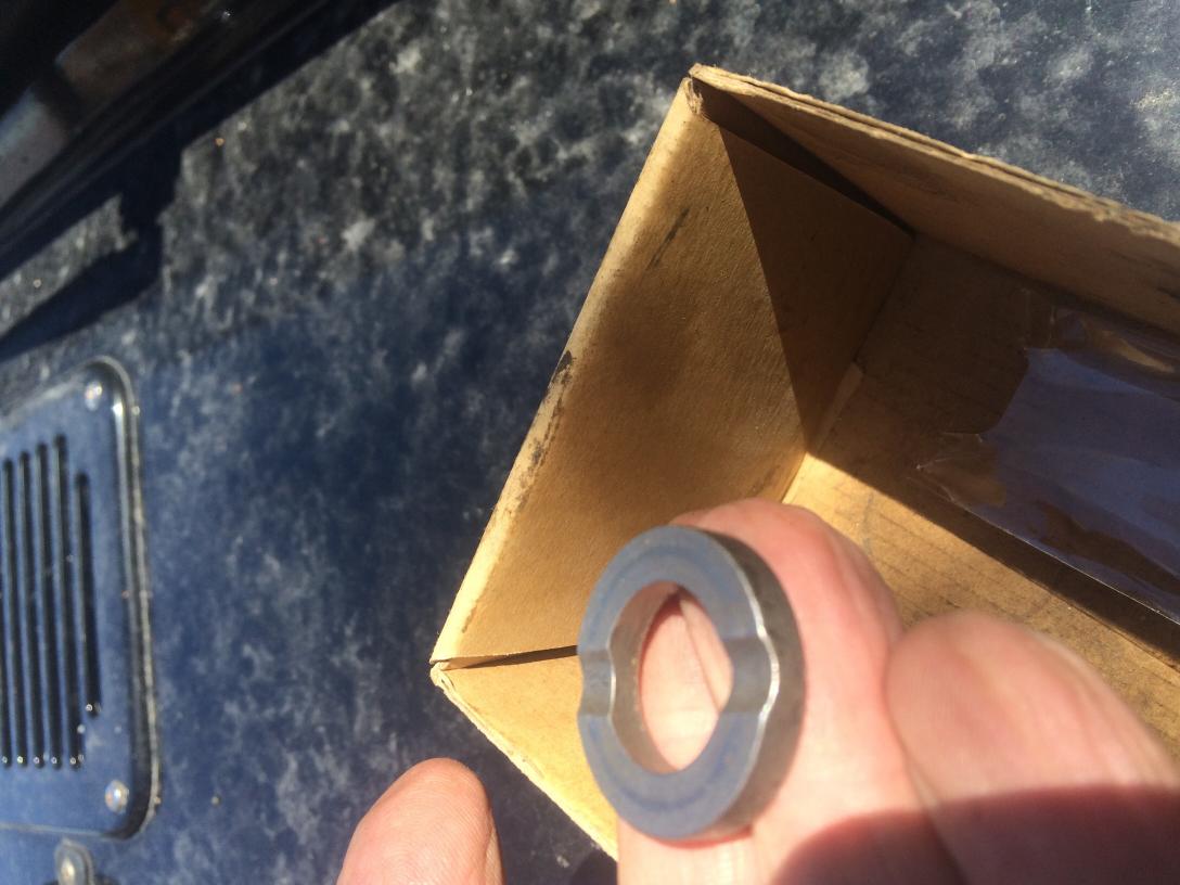

I have a part left over. Looks like a spacer the diameter of the input shaft with indentations 180 apart. I'm trying to find a way to post a pic from my iPhone.

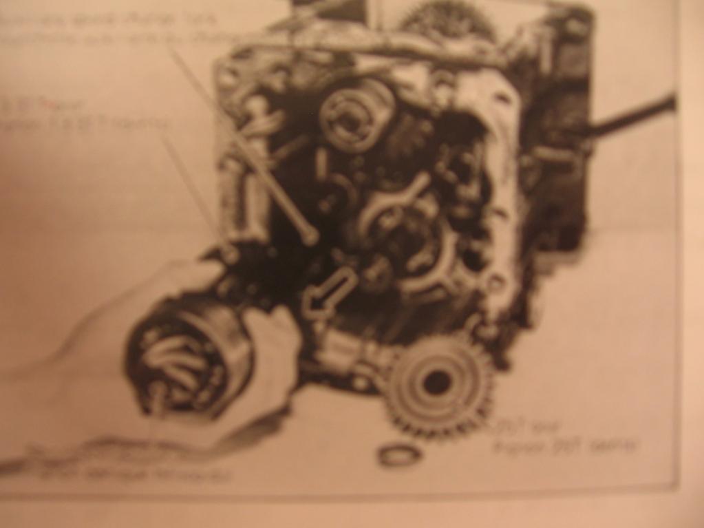

I looked through all my computer-based manuals & my parts list, and none show enough detail to tell the difference between a bearing, spacer, seal, or a lifesaver candy.

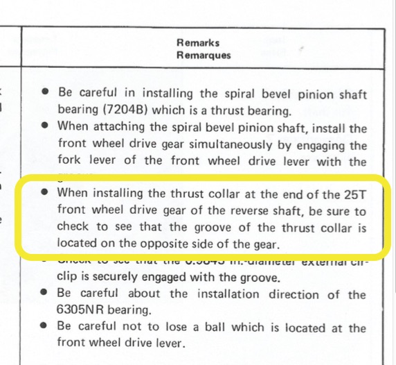

I have a relatively high quality, printed, 400+ page manual, and it shows (pg 206) the photo below. The ring in the right foreground definitely has the two grooves or notches that your part has, but there is no mention of a name or part number, but it appears to be associated with the 25T front wheel drive gear.
Sorry for the poor pic, best I could do.

Another thought- Grooved parts like that usually only have two functions; to act as a detent for spring-loaded balls, or to admit oil to a bearing surface.
Maybe that will provide a clue?

That is a trust collar.
The indents are for lubrication.
Your going to have issues with that not installed.

I am going to the kubota dealer with the part in hand. I too believe it is a thrust collar and I have to be certain. Tractor has been apart for 7 months now. Wish I could remember. ...

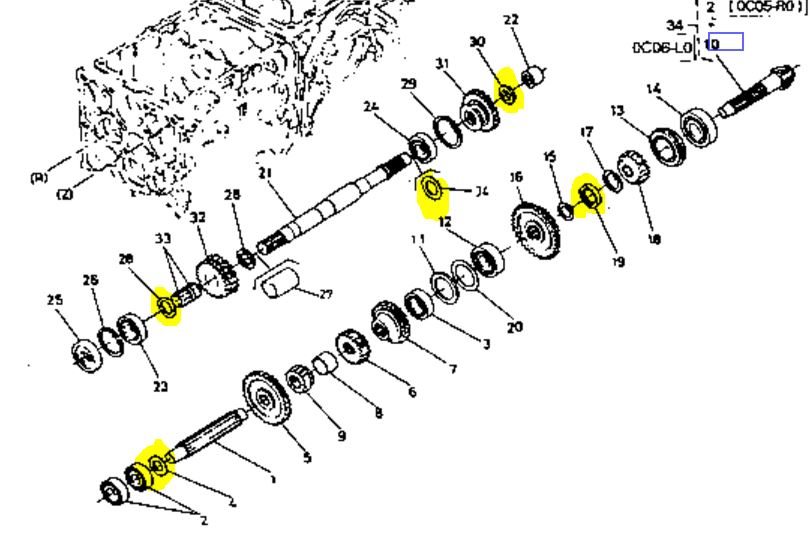

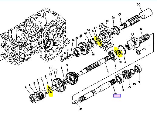

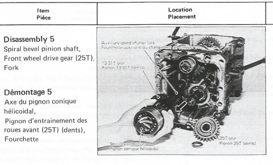

Fiftybucks & I have been exchanging e-mails & I was able to scan the pertinent sections of the manual. These are much clearer, & he thinks he has verified the part & where it might go. He needs to speak with hid dealer who actually rebuilt the transmission to see if the part had been replaced with a new one.

It was a thrust bushing on the end of the 4x4 transmission shaft.
also there is a metal pin that goes in that groove...
