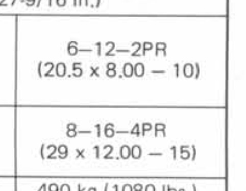

Sorry 85Hokie that's not right:
Tractor data has it wrong:
B7100's only ever had one size R1
Front: 6-12
Rear: 8-16
7,810
3,027
Tire sizes in your first post are correct.
This is cut from the B7100D manual.
