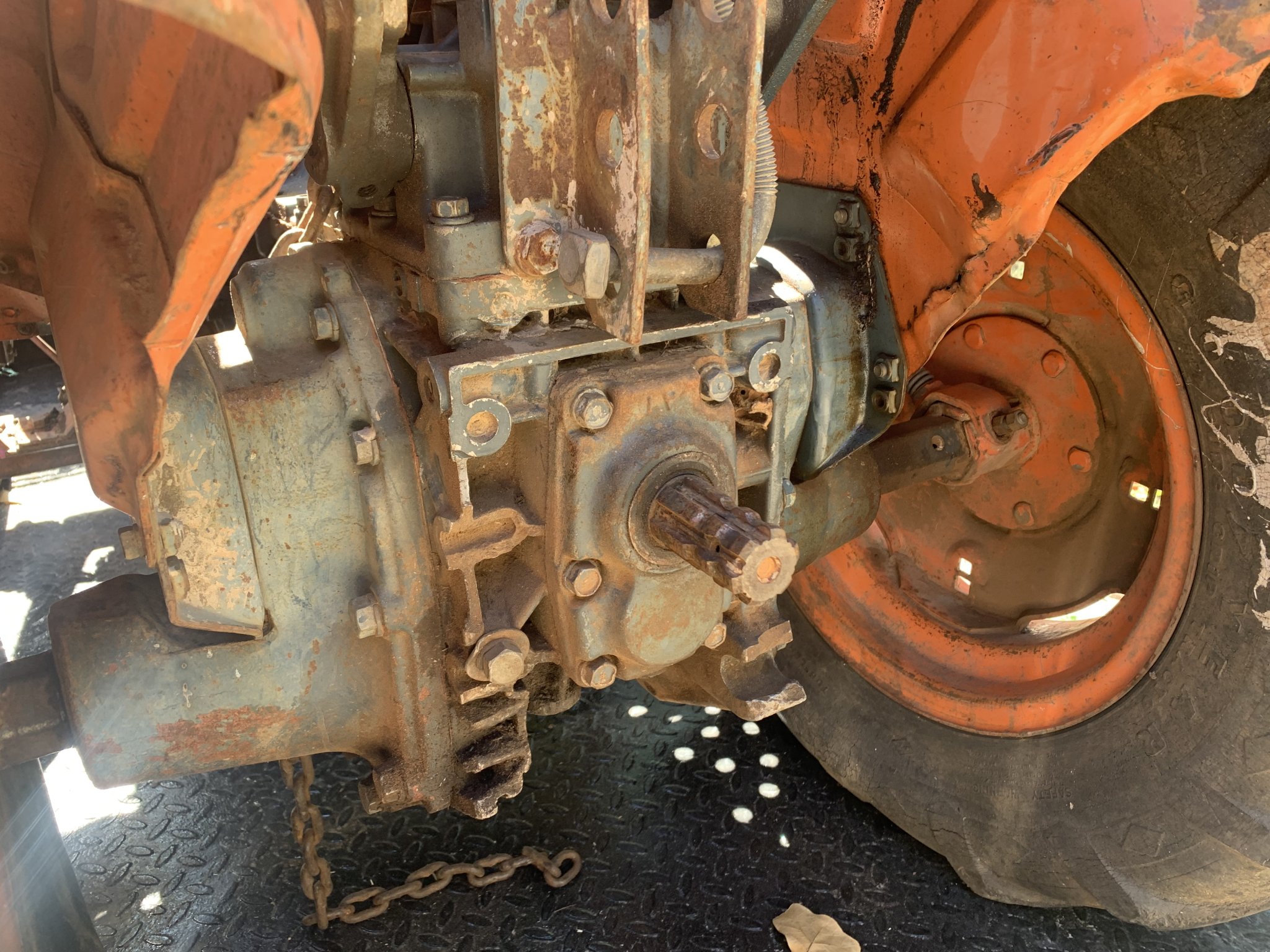

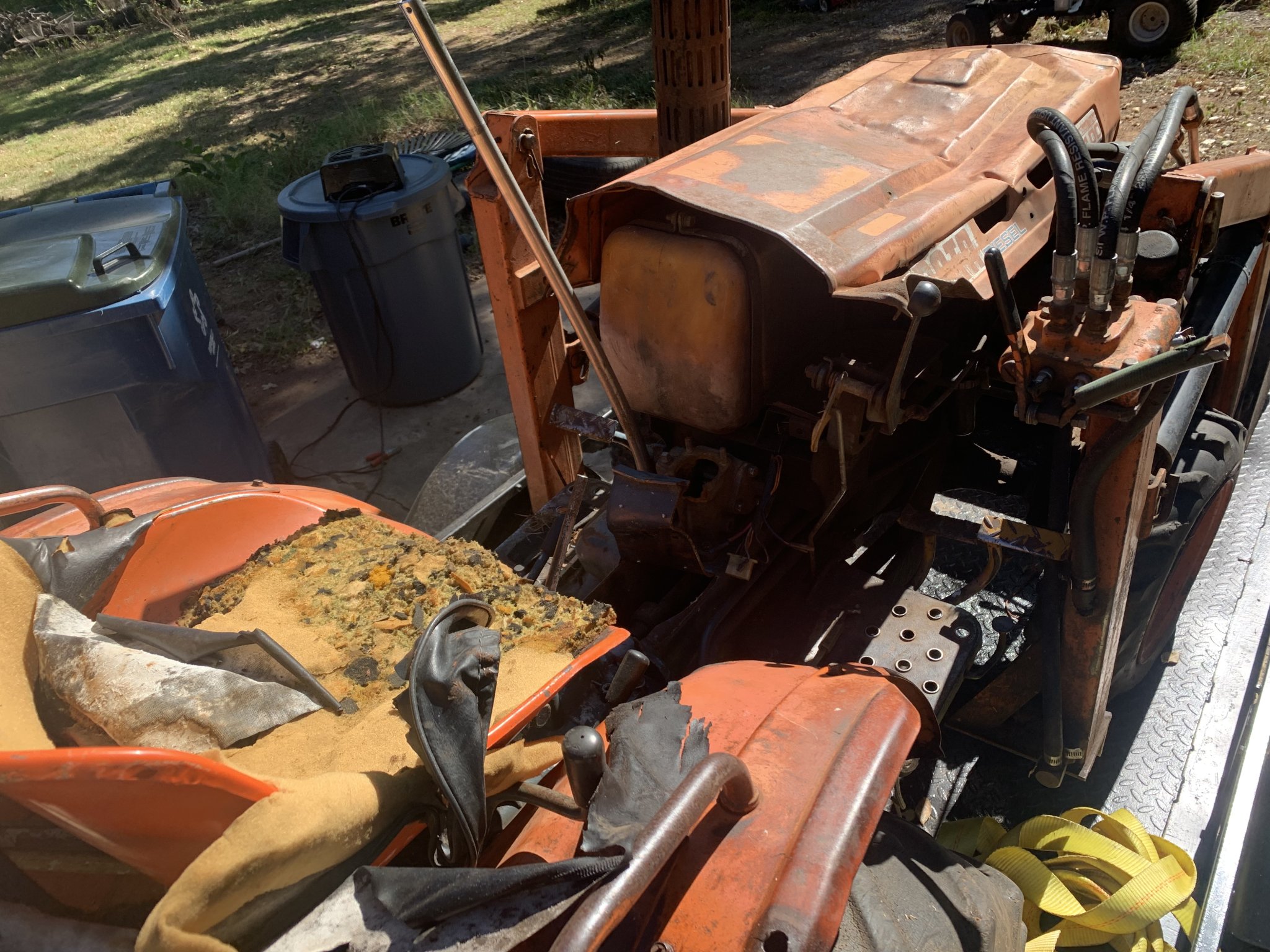

New to this form, hello!
Saw this for scrap price on CL and snagged it for the engine and loader. Pretty darn rough. What’s the consensus, part out and scrap the rest?
What I see: Missing steering shaft/box /wheel, dash, most wiring, side panels, cracked exhaust manifold, crushed hood, broken 3pt attachments…just for starters.
Not to mention where some lazy hack cut up the midsection.
Suggestions? Anyone have parts lol!

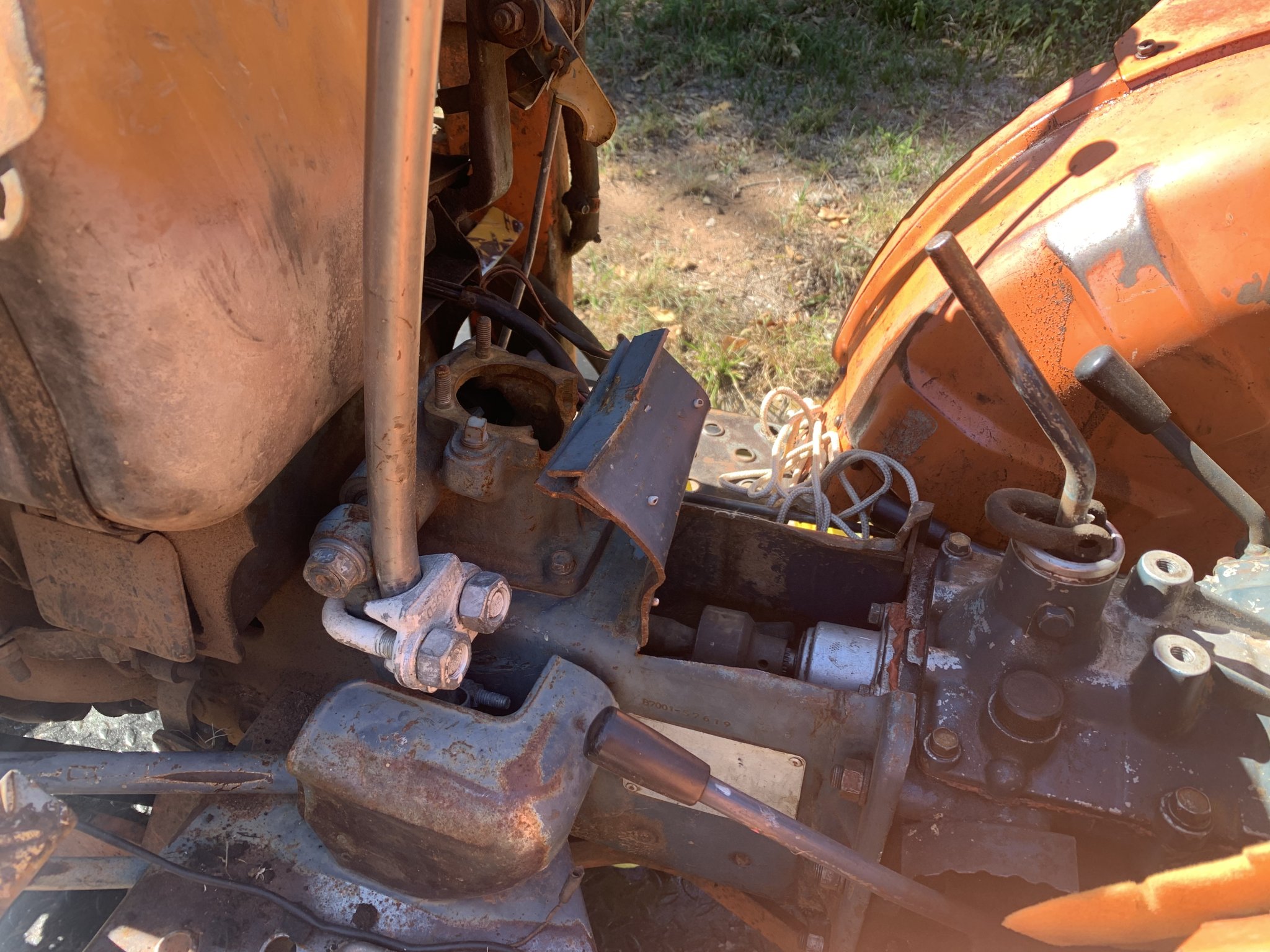

Yes, someone rigged up that piece of rod and steered the thing by pushing/pulling on it. 😅
Any other pics I can take to help?

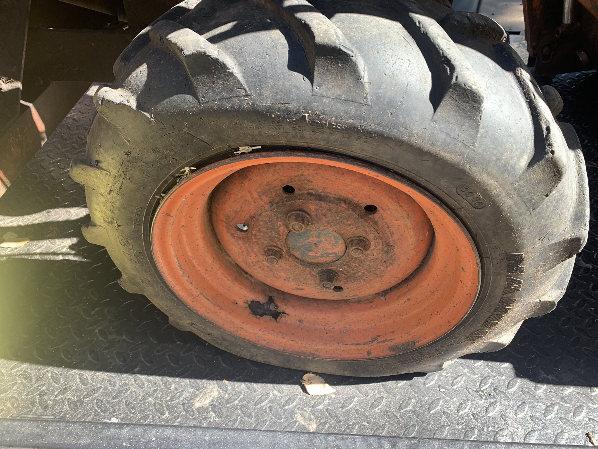

Looks like bone yard...By the pix's not much to part out? Outside of the rims.

It is the old style 4 bolt axle rather than the newer 6 bolt axle.

Wow that thing has been beaten like a rented mule! I think it would be best used as a parts donor for another tractor in better shape. In my opinion I would put just enough time into it to see what actually works so you would have a better idea of it’s condition but I don’t think I would try to fix it to use. If the transmission and front axle are in decent shape, I would look for a 2wd B7100 in decent shape and convert it into a 4wd loader tractor. The majority of the parts on these tractors will interchange except for the obvious parts related to the 4wd. Here in my area the 2wd versions with a mid mount mower come up for sale often and usually are reasonably priced. A B6100 can also be used for a lot of parts as well. A B5100 won’t provide as many useful parts past the sheet metal. Hope that helps. Good luck with it, Id love to find one like that so I could snag the loader.

Yeah it looks like an oak tree fell on it. 😂 The problem is these are not very common around here. The engine isn’t seized and my decision is really going to come down to how it runs.
