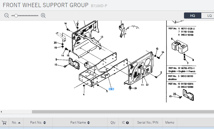

can someone tell me if you can engine swap b5100e 2 cylinder to 3 cylinder
Not unless you find a fun way to stretch the frame!
Or use the frame out of a B6100E or B7100E.
28,301
4,853
Yes and no, The frame bolts to the sides of the block not to the front.
I've worked on quite a few of these!
Top pic is a B5100 (2 CYL frame)
Bottom pic is a B7100 (3 cylinder frame)
If you will note the Frame bolt hole differences between the two.
One will not interchange with the other.
This doesn't even bring into play the side covers and hood are also shorter, along with a host of other parts.
Buy a B6100, or B7100 if you want a three cylinder tractor.
