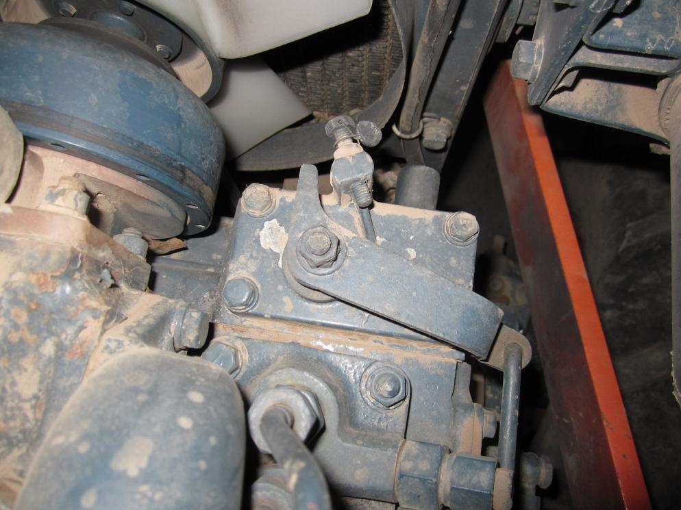

Now on to my throttle creep. I have included a picture of the top of the motor where the throttle linkage attaches. The bolt/all thread goes into the top of the plate and pivots on the bolt/all thread. I would assume there is some type of internal washer/ clutch plate that I need to replace????

Just snug up the nut on the pivot point in the picture. You will have to loosen the lock nut first.

You need to hold the bottom nut and tighten the top nut to lock them together so they wont just back off again.;)
