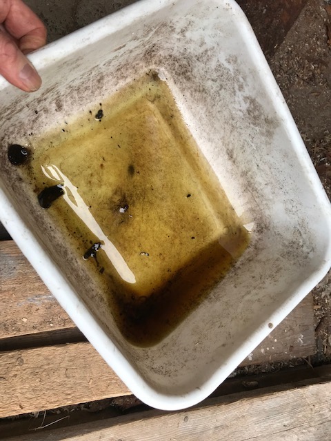

I have a B6200HST which has given great service over the last 13 years. I have all relevant manuals. I have a significant oil leak from the rear axle area. It does not appear to be the PTO shaft seal, and it's not transmission fluid (which is clear, and my fluid level on the dipstick is good). The oil drips off the rear axle case directly below the PTO mechanism, and is yellowish in colour.
What is the most likely cause of this leak? Your help would be greatly appreciated.

Thanks for your replies. I'll investigate further. I'm trying to avoid having to replace the gasket on the rear axle case. That looks like a big job, and like so much else with this track, I've never done it before (another first). I try to get it right the first time, as well as the second.
It has me a bit stumped, though, because the transmission fluid level on the dip stick is still showing good, which doesn't make sense given the amount of fluid leakage into the white tub (and the ground, before I noticed it).

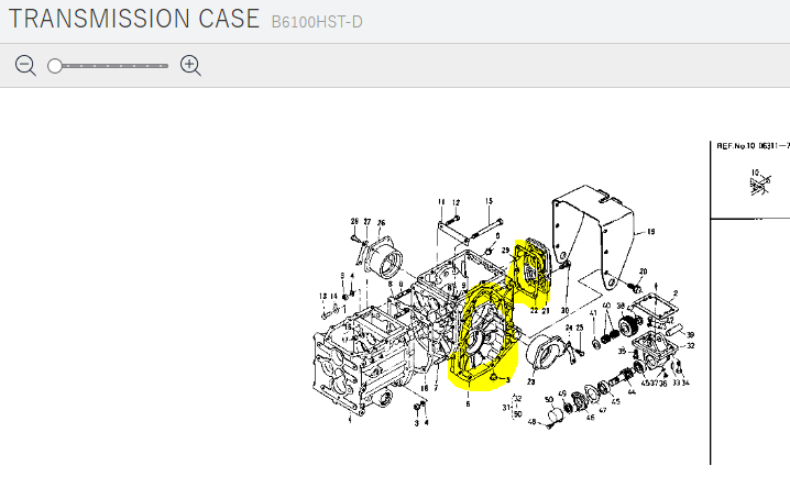

Have you checked your PTO shaft for excessive play? I ran into a similar situation where my B7200 was leaking from the rear and couldn't see anything when it was parked. I'd run it then it started leaking again. When I moved the PTO shaft, it had enough play in it to leak between the seal and shaft. Replaced the bearings and that fixed it.
If you have to replace the gasket, use a little gray or black RTV along with the gasket. I couldn't get mine to seal properly with the gasket alone. You also want to replace the PTO seal at the same time. If you jack the rear end up as high as you safely can, you'll minimize fluid loss during the replacement process.
