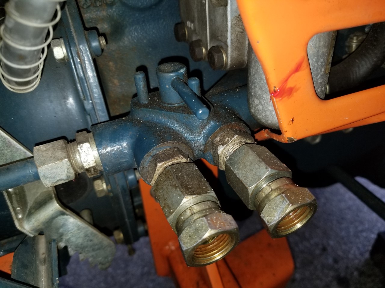

B6200 removed the snowblower and the hoses attached to the Tractor block off plate on the tractor with a lever. valve and ports pour oil with valve in either position gushing oil how to stop?
I bought the tractor off an estate so did not get some parts I am missing the oil block off plate for when you remove the snowblower hoses from the tractor oil block off valve.
Hello,
A little bit new to Kubota but not new to the mechanics of tractors thank you for your help in advance.
I removed the snowblower
I disconnected the oil lines from the Snowblower lifting valve from the Tractors Oil block is a 2 port Valve - valve turn towards the side or back of the tractor
I DO NOT have the original sheet metal OIL BLOCK OFF plate I do not have the 2 OIL Plugs (any suggestions on where to get them?)
Order this part? does anyone have a part name and or part number or aftermarket source and kit?

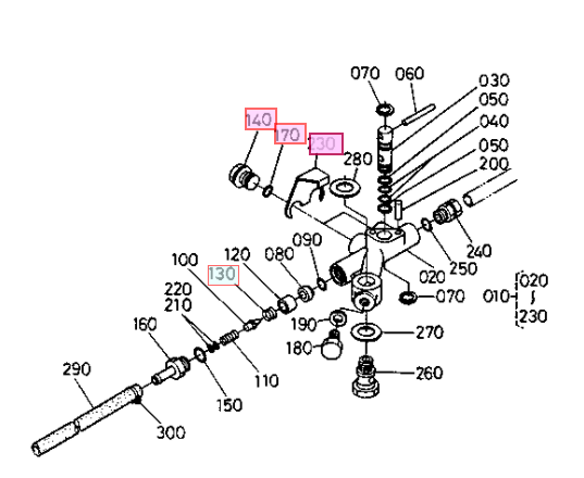

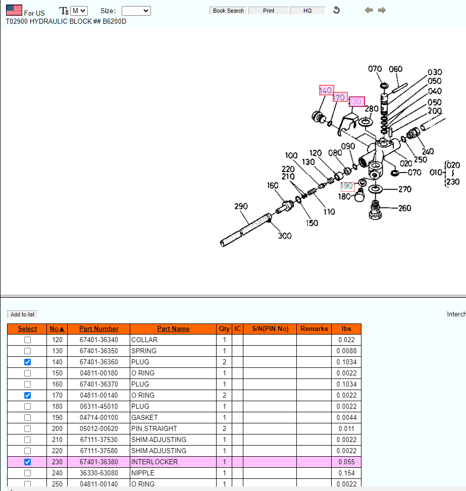

Hi Thank you all for the links to the books and manuals it appears that from the facory the Oil Plate or Oil block comes with 2 plugs in it if you search for like an emay part the pictures show many all plugged up but I wanted to verify because mine hade hoses in it and I did not get the plug from the older man who passed. So the Kubota diagrams and parts list see to use the word plug - I would have guessed a LOOP hose or something but seems like plugs.

Have you removed the valve you used to control hydraulic functions on the blower?
If you did, then re-install it and the valve body will form the loop NIW talked about.
Disconnect the lines from the valve to the blower cylinders or chute motor while leaving the valve in place.
The valve wont leak oil if you do not touch the joystick or control levers.

Flip the lever on the top to the other direction fluid will stop dumping out the side ports.
Super easy and simple solution would be to install a set of quick disconnect to those 2 ports.
That way when you disconnect the blower you just have to flip the diverter valve and your off and running.
Yes you could add a loop then you wouldn't have to flip the diverter valve.
And Yes you can simply flip the diverter valve and cap the 2 ports too.
If you look at the picture of the diverter valve you posted with the caps you will also notice a safety block off plate to keep the lever in the straight position when the cap are in, this is because if you don't you will damage the pump or seals in the pump.
Super easy and simple solution would be to install a set of the quick disconnects to those 2 ports.
If you look at the picture of the diverter valve you posted with the caps you will also notice a safety block off the plate to keep the lever in the straight position when the cap are in, this is because if you don't you will damage the pump or seals in the pump.
Oil comes out with the valve in either direction....
MANY thanks got it KEEP lever in a straight position when plugs are in
Snowblower attached I believe the lever was pointing outward to divert fluid to snowblower lift and lower Valve.
I like the quick-connect valve idea or like the self-sealing ones that skid steers use like an air hose.
Please one last question - can you confirm
With blower and lines installed lever points toward side of tractor feeding oil out to snowblower lift lever manifold.
Summertime snowblower removed flip lever parallel to tractor buy sheet metal plate or tie lever so parallel with tractor and install plugs CORRECT?
