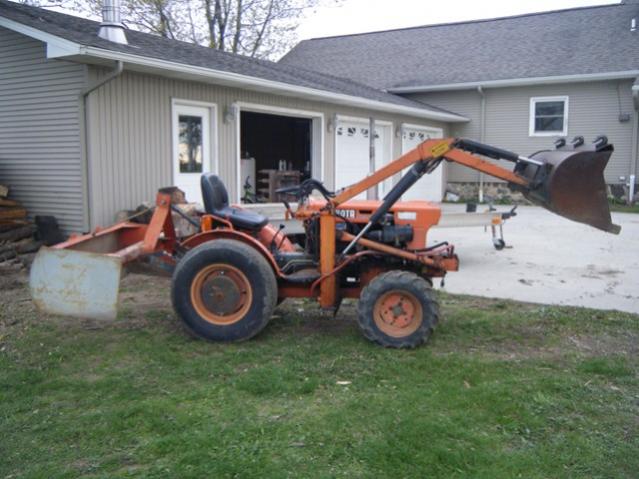

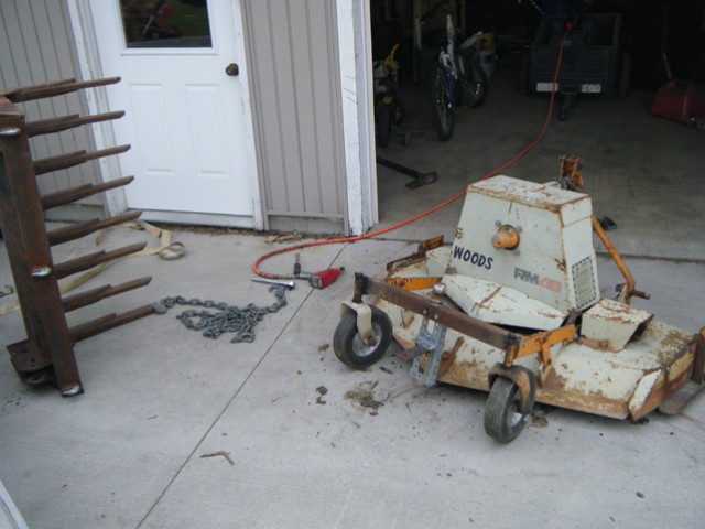

Shes home. The longer glowplug cycle helped but it is cold blooded. While using it I did run into another issue, sometimes when I push the clutch in with the unit in gear it will start to growl/vibrate and it is difficult to take it out or switch gears. If I let the clutch back out and push it back in it will stop and I can switch gears. Wanted to let everyone know that I got the operators manual and the illustrated parts list for the 6100 and the KUB219 loader. Anyway here are a few pics.

YEP I'm jealious! He's got one identical to mine but with a FEL. NEVER AGAIN will I own a tractor without a FEL

Yeah it even has racing slicks:D I just read Vics article on the clutch release bearing so I will be Lubing that baby up and praying that is all I have to do! The old fella I bought it from said it didn't do that for him and the tractor had set most of the last 2 years with occasional use.
