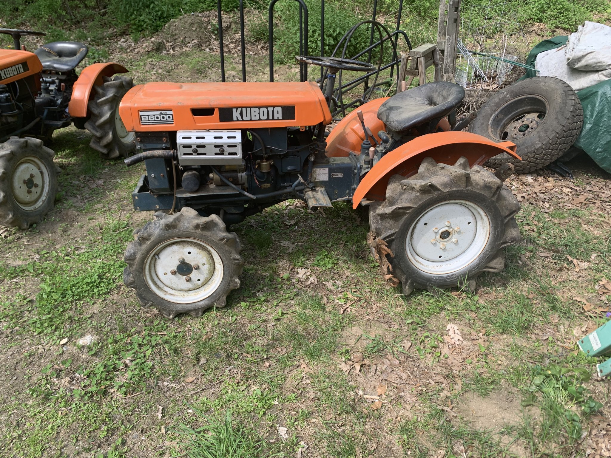

Greetings! I have two B6000's; an E (2WD) and a DT (4WD). Both are geared, no HST. As for the radiator, Tracpartz has new ones for around $240USD plus shipping from NL. I have used them before for B6000 parts and shipping is not expensive as long as you don't expect it overnight...
