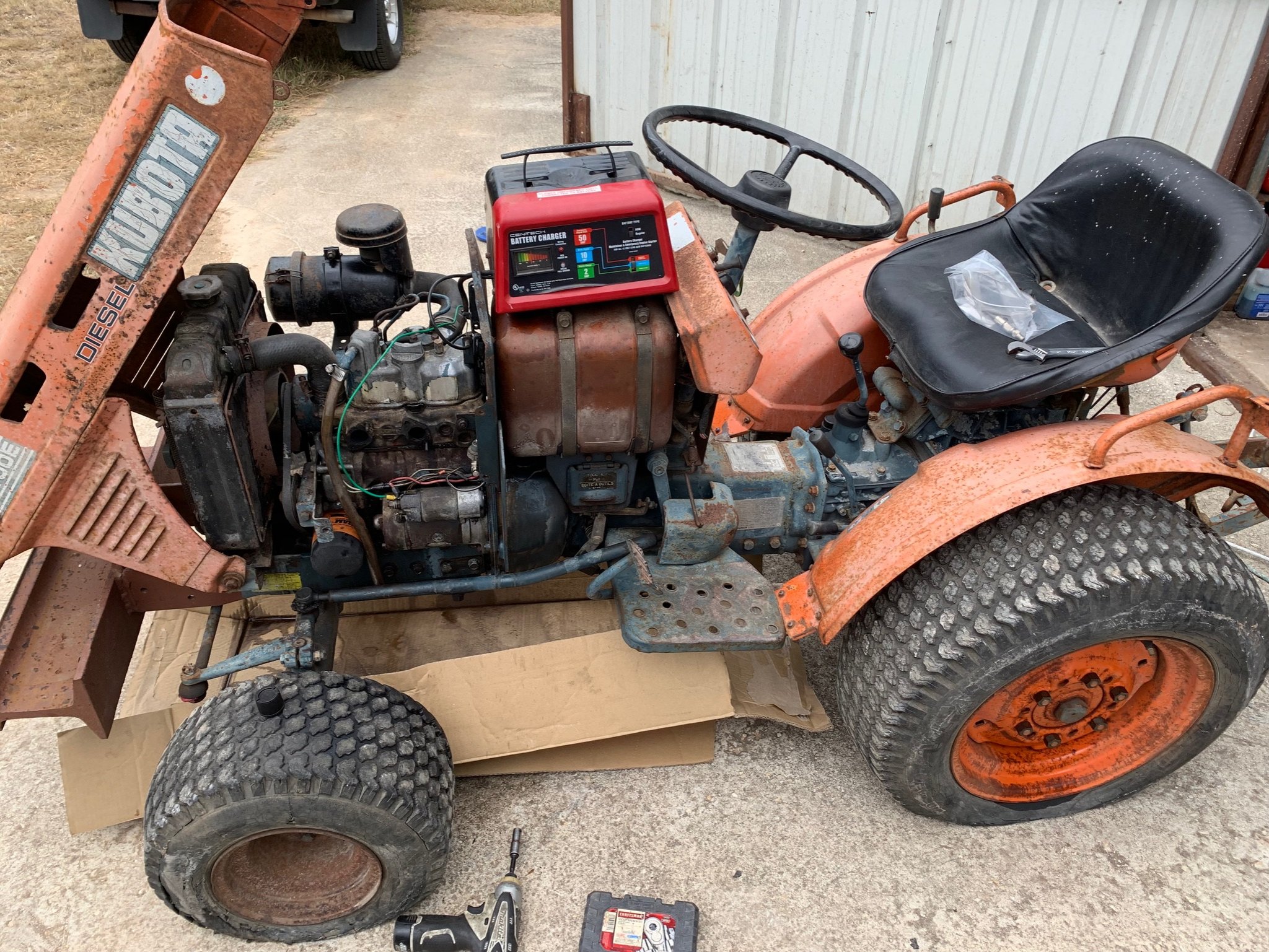

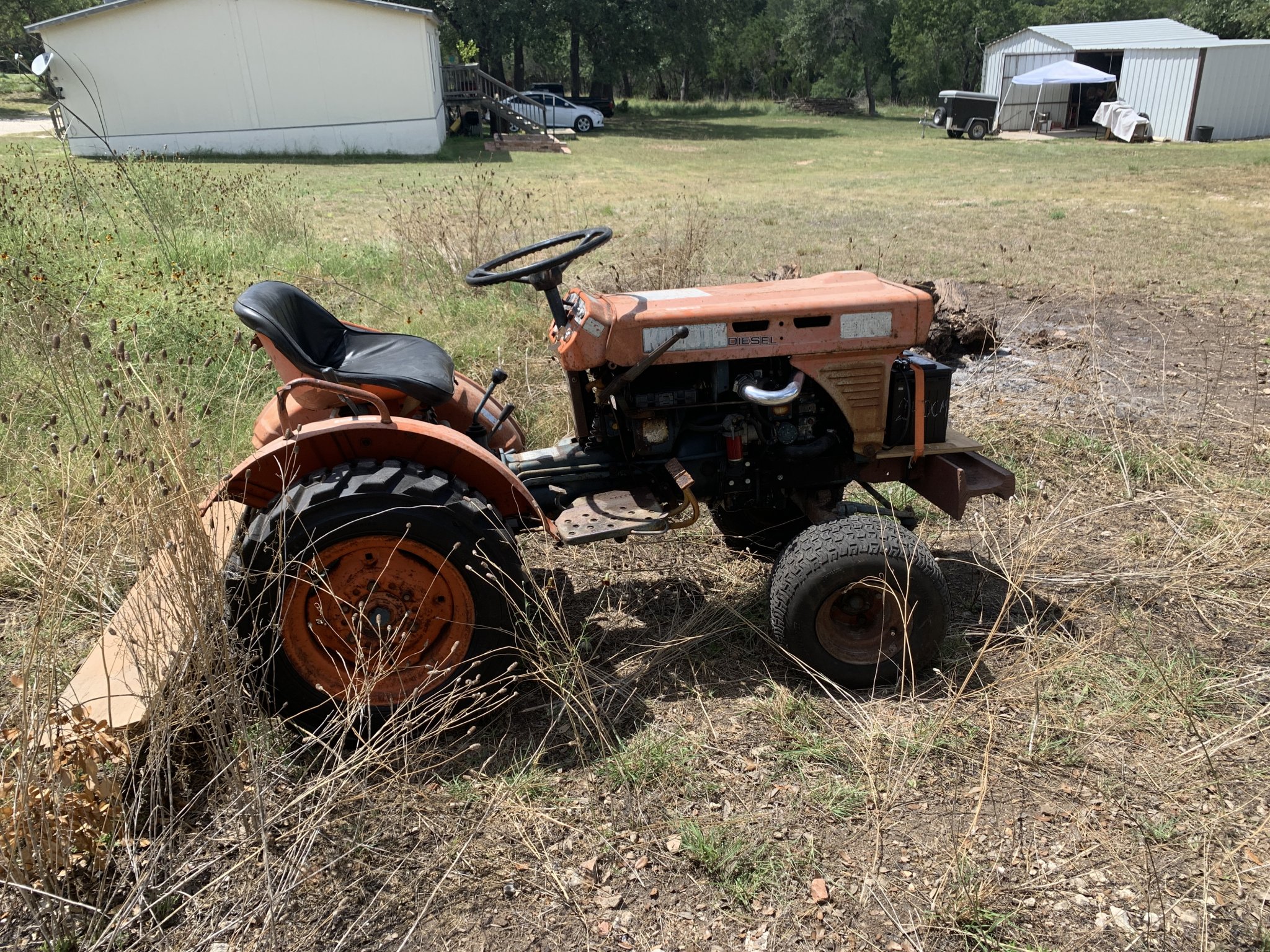

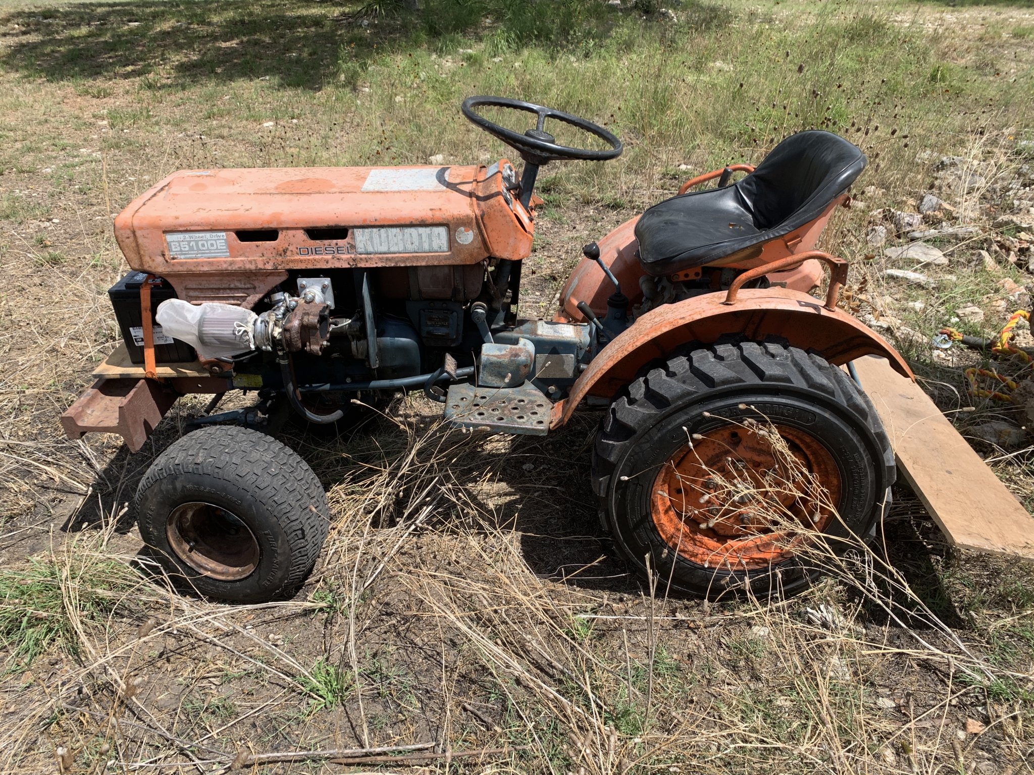

I bought this tractor locally for $600 and then spent ~$400 turbo'ing it. The previous owner welded a piece of train rail as the front bumper which I think is pretty cool.
I don't know what the power level is with the turbo. It's 12hp stock. I have not "turned up" the fuel or anything like that.
Goals are to be able to have a reliable work horse tractor that can maybe pull/do a little more than stock.
Turbo is a RHB31 from a Yanmar marine diesel generator (I believe). You can definitely tell the turbo was used in a marine application.
In any case, I just got it running last weekend. I'm still a noob with tractors, but not new to tastefully modifying my vehicles.
If anyone has any questions please let me know. I still intend to put the stock muffler/stack back on once I make an adapter for the turbine outlet flange.

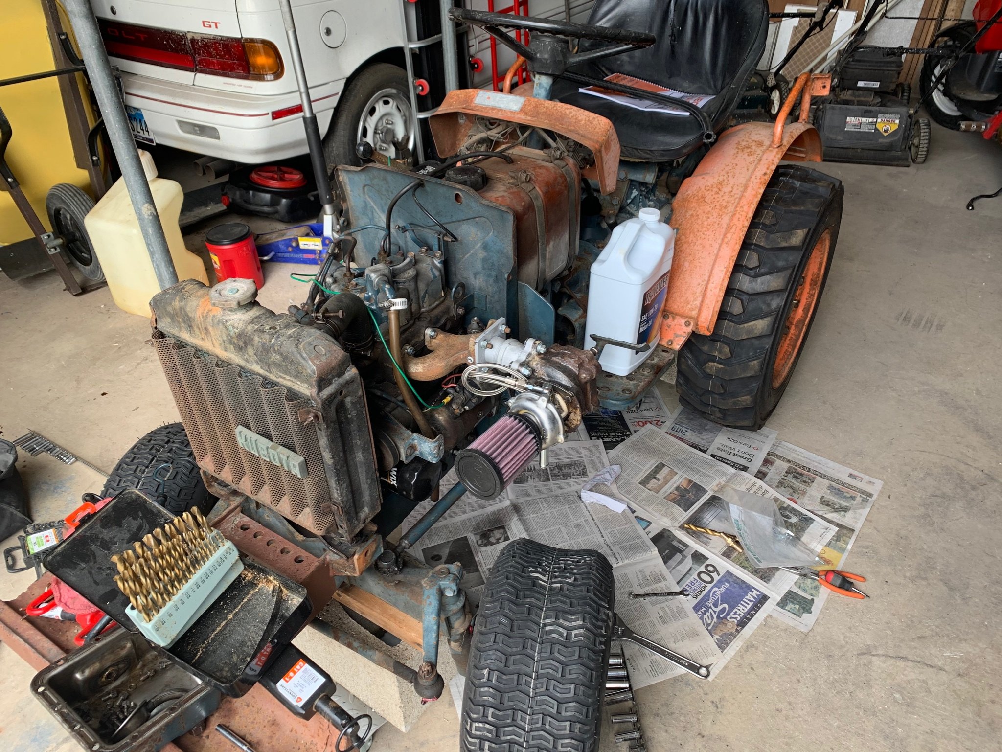

How about pics of the turbo/plumbing/exhaust?

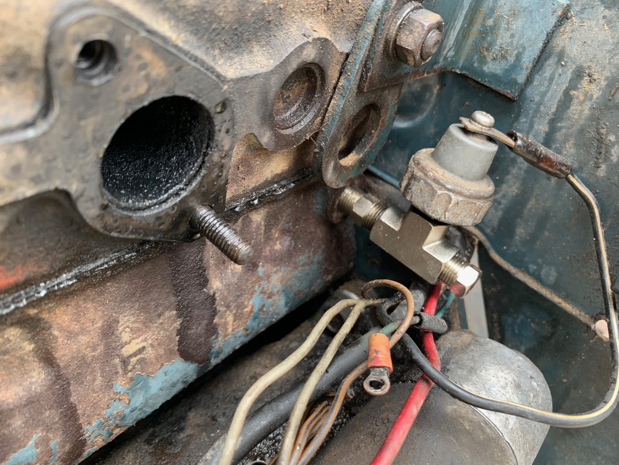

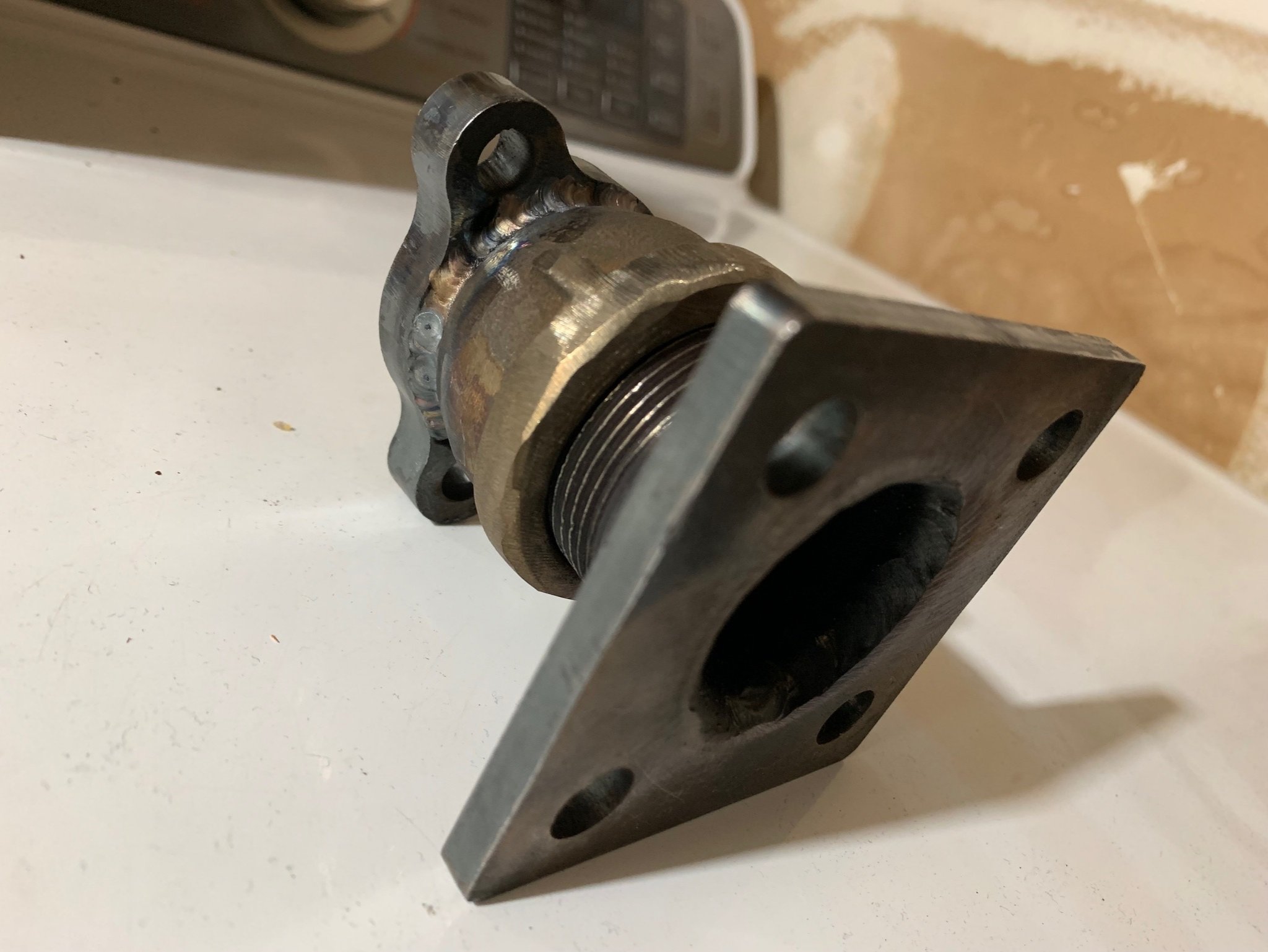

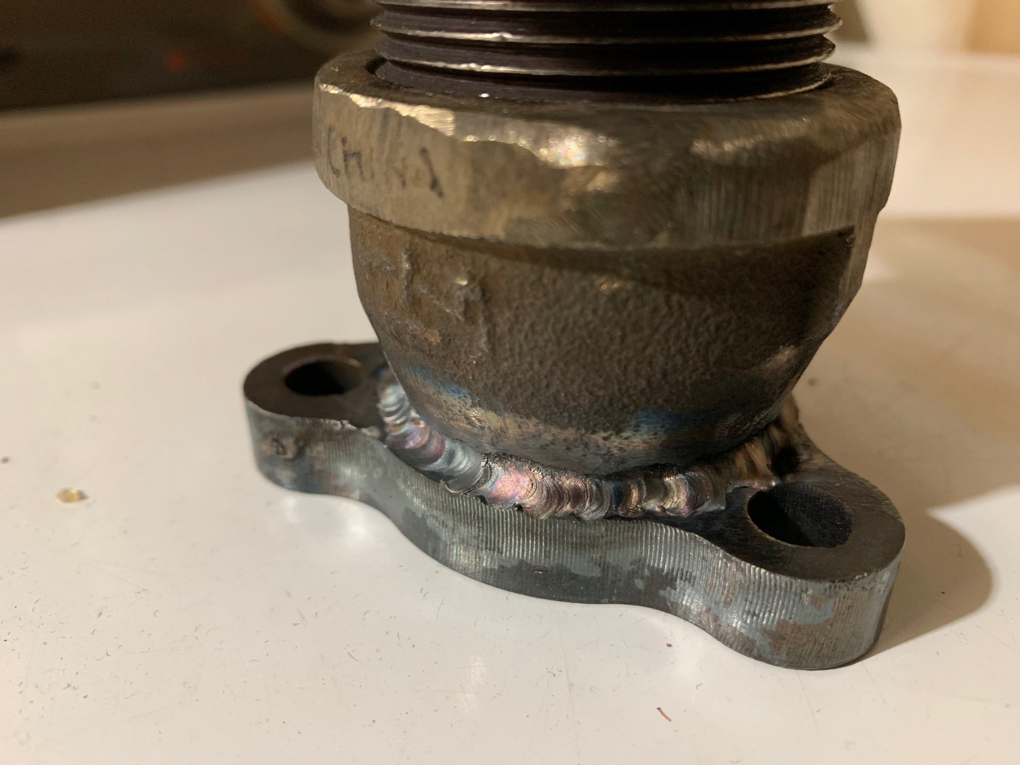

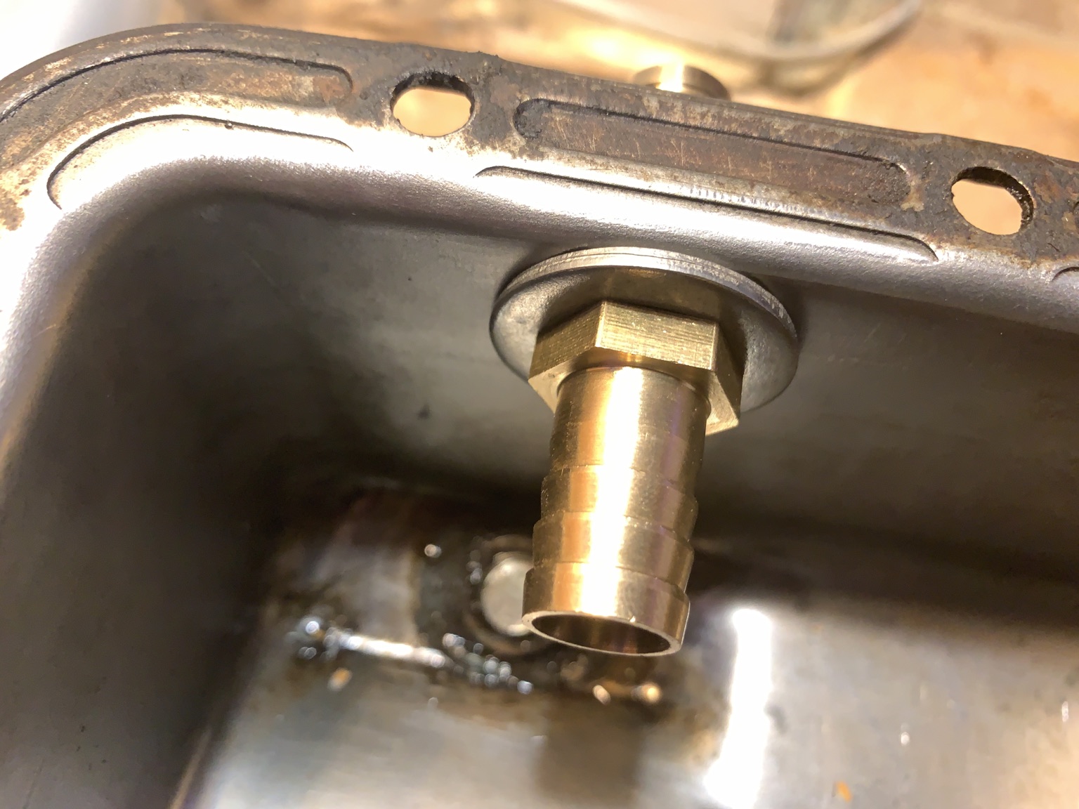

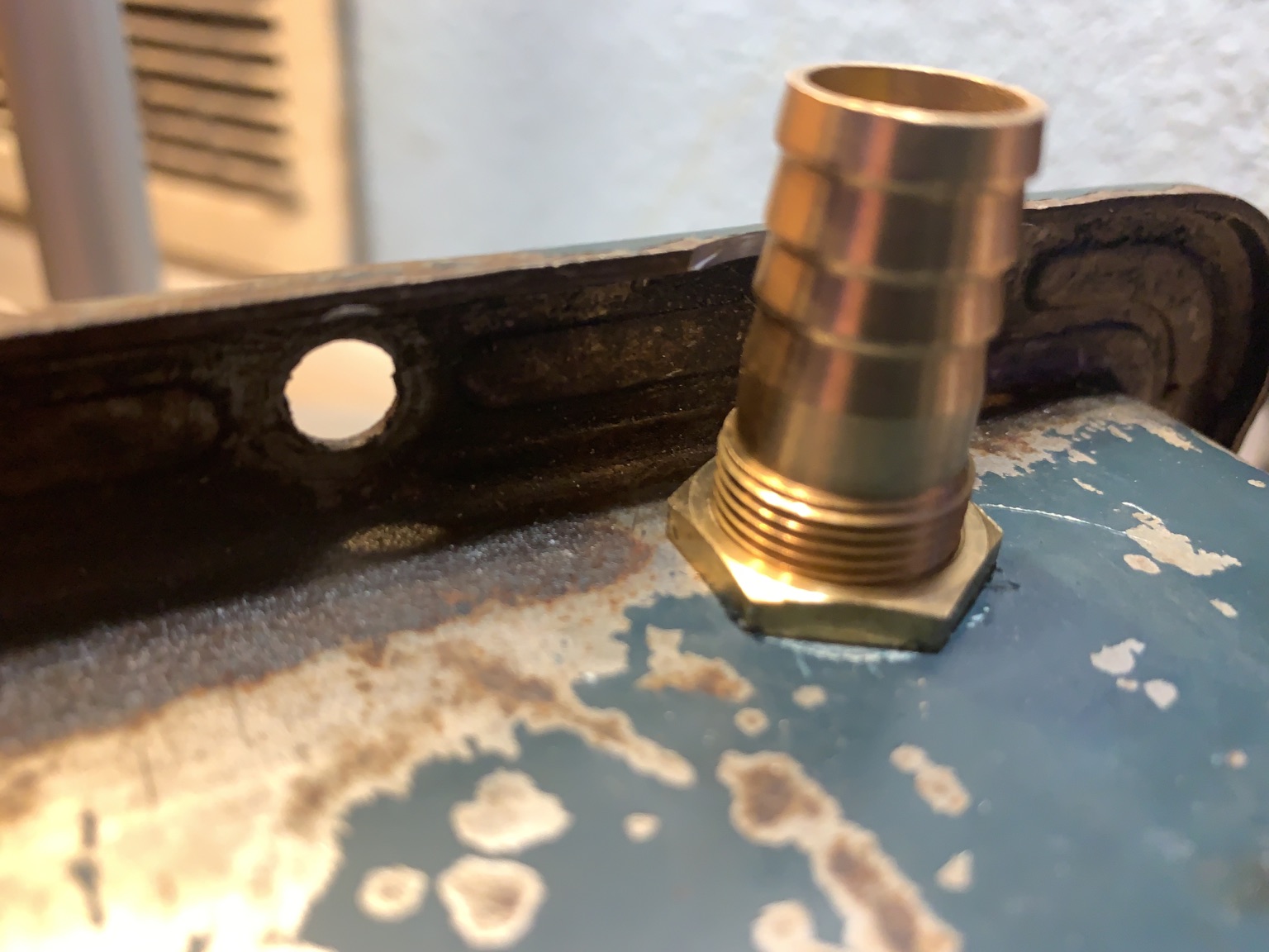

Here's the oil drain fitting I added from HDR (home depot racing).

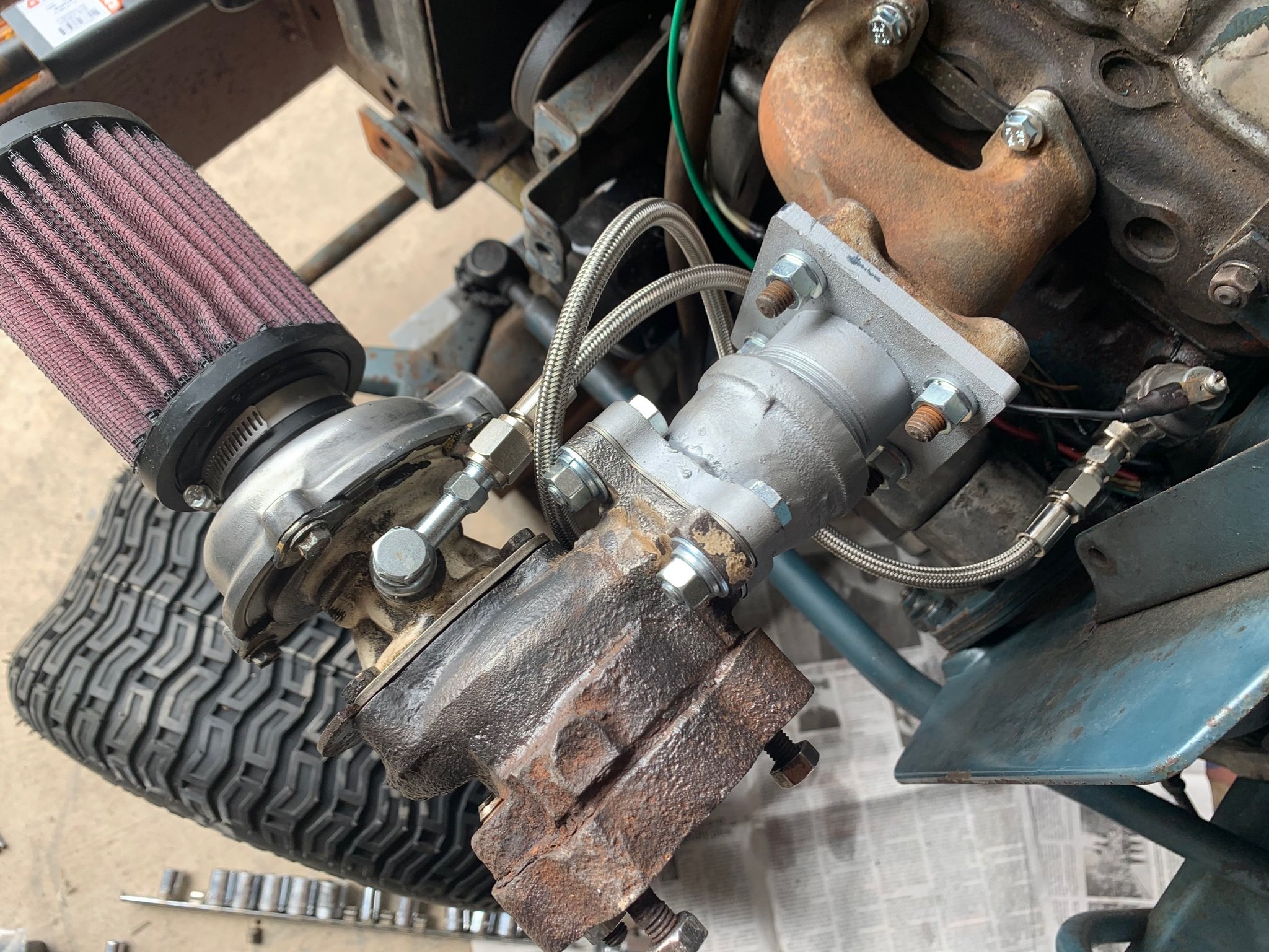

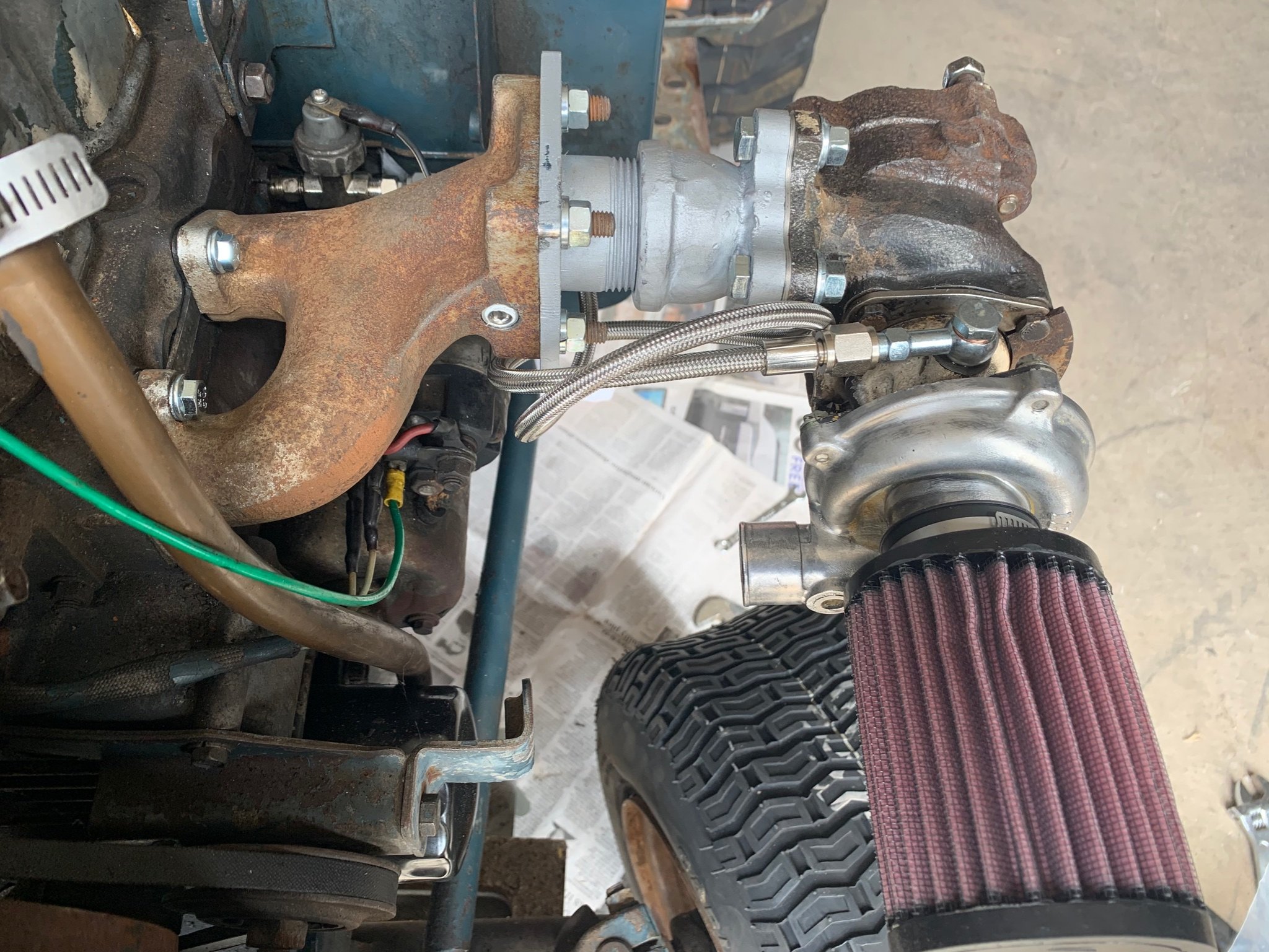

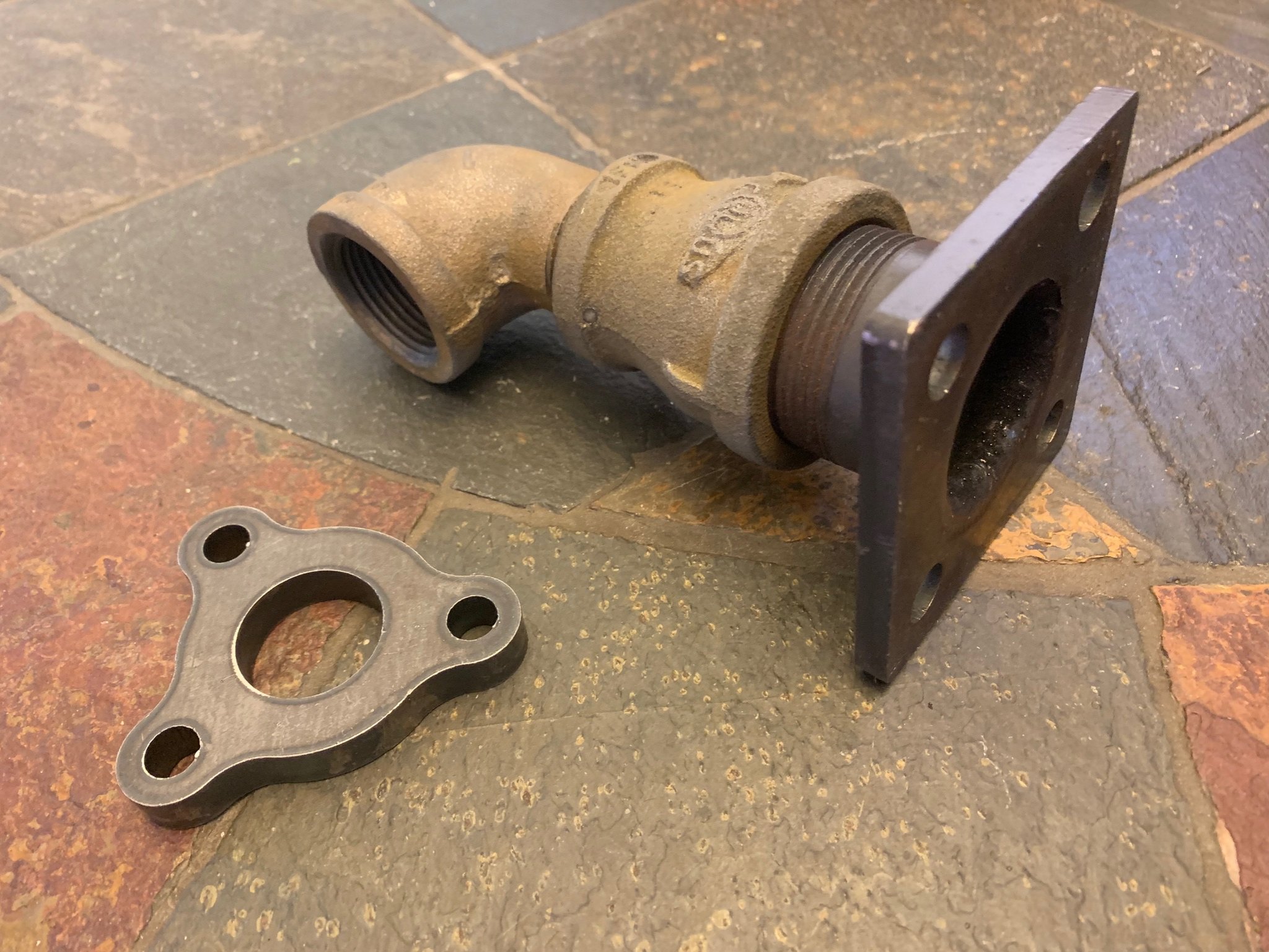

There isn't much to the exhaust. The 2nd picture shows it. I made the manifold/collector out of steel plumbing fittings that I removed the galvanization off of. They still need a tack weld to hold it in position but it's sturdy enough where it is just on the threads.... and it doesn't leak exhaust.
The turbo is in the 2nd picture. I will take some more closeups of how things went together when I go back out to where the tractor is in a day or two.

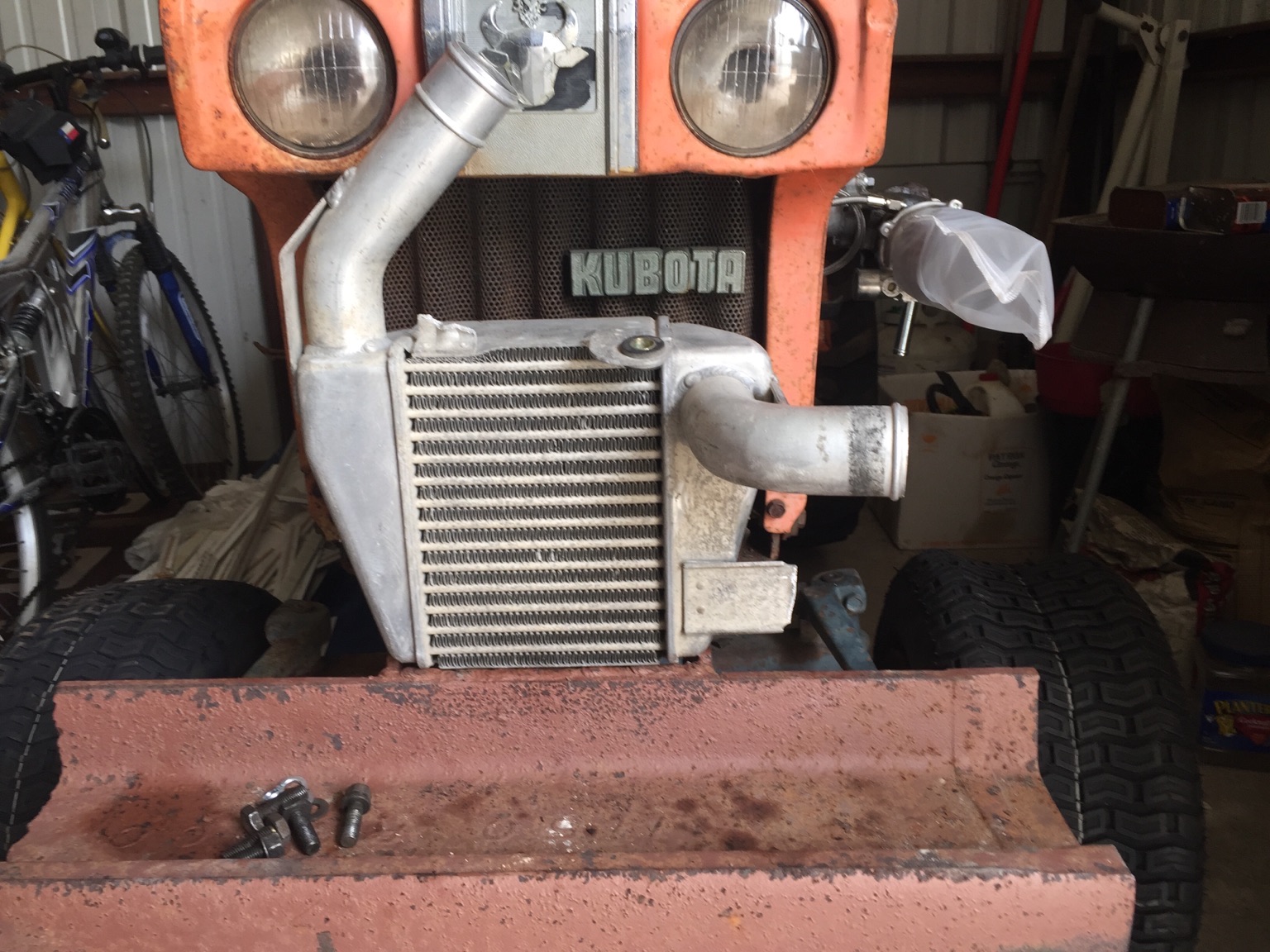

The intake piping (hot pipe, i don't think this needs an intercooler or could even benefit from one unless it had a fan mounted to it) was made out of a piping kit I bought from frozenboost.com. We used a u-bend, 2x 90s, and a 45 to complete the run from the compressor outlet to the motor's air inlet..... and it allowed the hood to shut as well.
I had to go back and put a gasket between the metal washer and the oil pan because it leaked after I assembled it.
The oil feed was pulled from the oil pressure switch port in the head that I adapted to a t-fitting and ran -4AN line from to the turbo. The oil pressure switch still is in line but now the oil can feed the turbo as well.

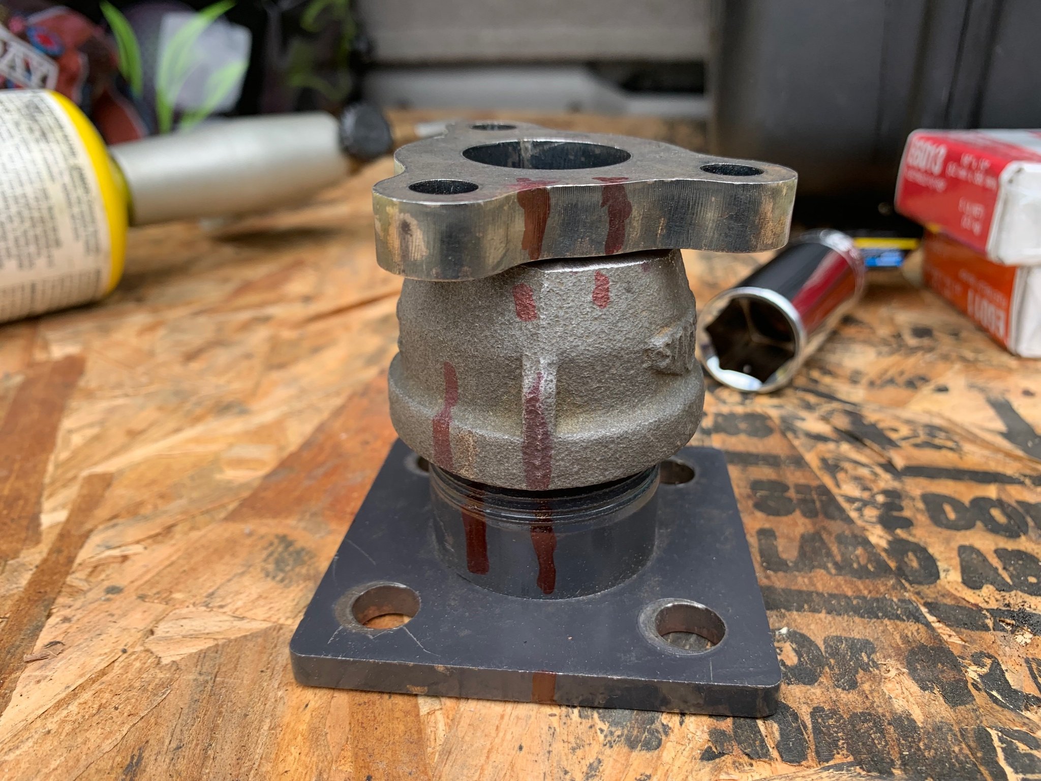

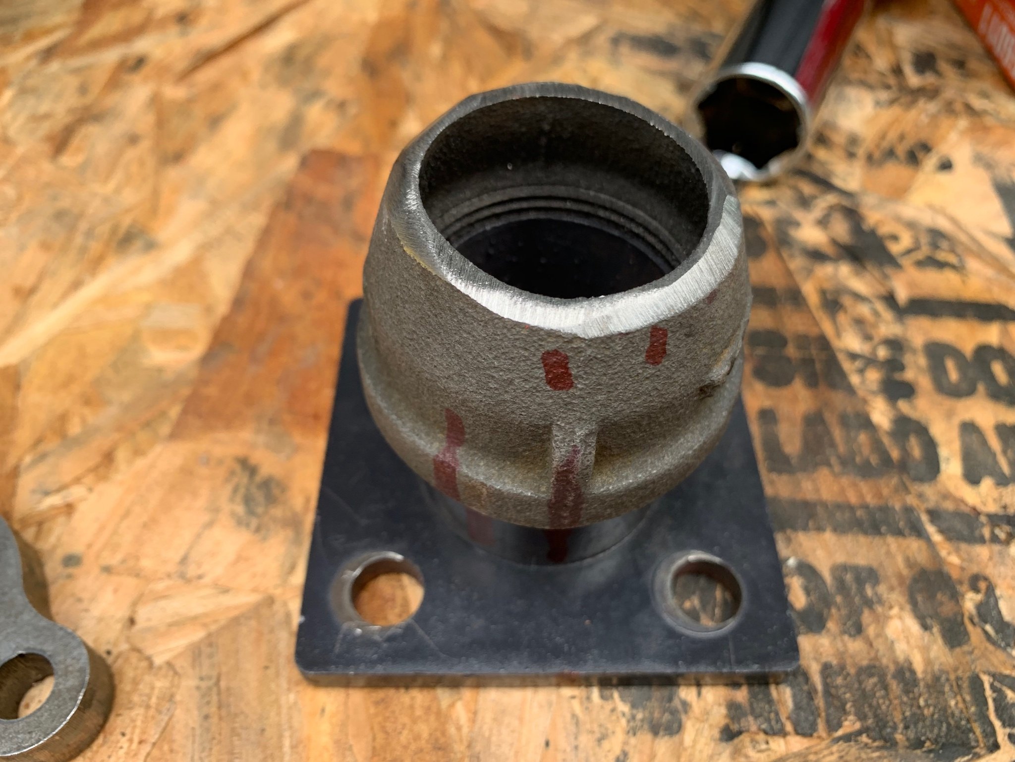

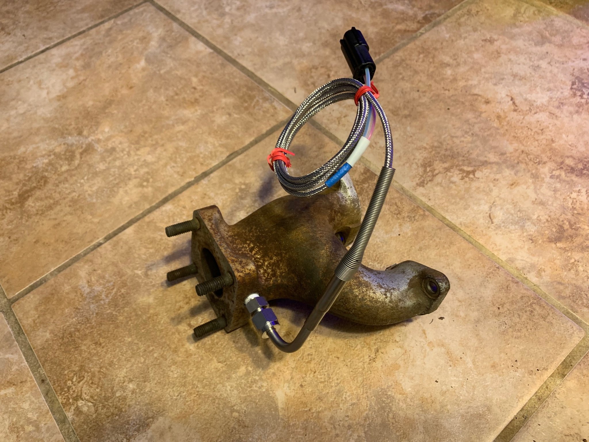

Here are pictures I promised. The charge pipe has no intercooler in it, it just goes to the inlet manifold on the cylinder head.
You can see mockup of an intercooler, but I really don't think it's needed.
