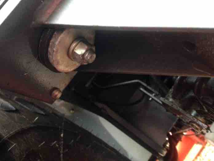

I’ve noticed the rubber washers on my cab mounts to frame can all be moved around easily, indicating that that’s the factory specs or they are worn, the bolts are tight and at their limits. Any ideas on this one folks?

B3350 cab mounts, you say yours seem tight, can you spin the washers with you fingers? i have about 1/8 inch slop on all of mine, hmmm

I believe loose means replacement time. There is a wear limit spec I read somewhere...

Went back and took a second look at the rear cab mounts. The nut is tight. The metal washer is tight as well, but there is a hard rubber above the metal washer is very loose.The rubber mount on the top side is solid. I would say this must be normal. The tractor only has 80 hours on it, so I can't see them being worn out.
