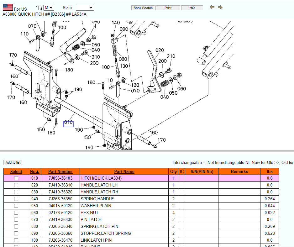

Here is the part# for the US LA534 loader. Maybe it is the same? I would ask your dealer. Or like @Roadworthy said, contact Messicks. I am only assuming this would fit. I would definitely get some measurements.

The Part number above (7J056-36103) is the same as the Kubota B2366 part I believe which I have seen mentioned a few times now on other forums.
