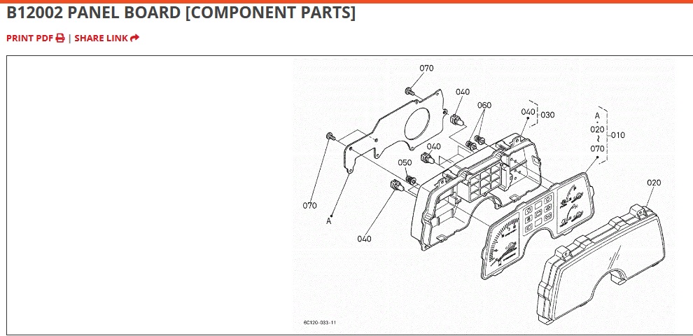

I have been to several sites looking for a new tachometer for my 2910. None of the sites display a picture but all of then have the same factory (Kubota) part number. So I ordered one and of course it's wrong. Anybody else experienced this?
post photos of the original and replacement tach.
It might be easier then to make an intelligent comment
I see this unit for $1,000 on Messicks
Why not tell us why you feel you need to replace the tach and what diagnostics you have done.

I replaced the tach cable which was not the problem. The tach is erratic and howls like crazy. The photo above is the unit I have. Intigrated in the dash board.
Just a quess my b7800 I can see that the needle is bent(probably from heat) and it is touching the plastic cover and it is catchy
I did a google search and came up with this company local to you who repair instrument clusters.
Repair
Worth taking to them and perhaps they can fix yours on site.
