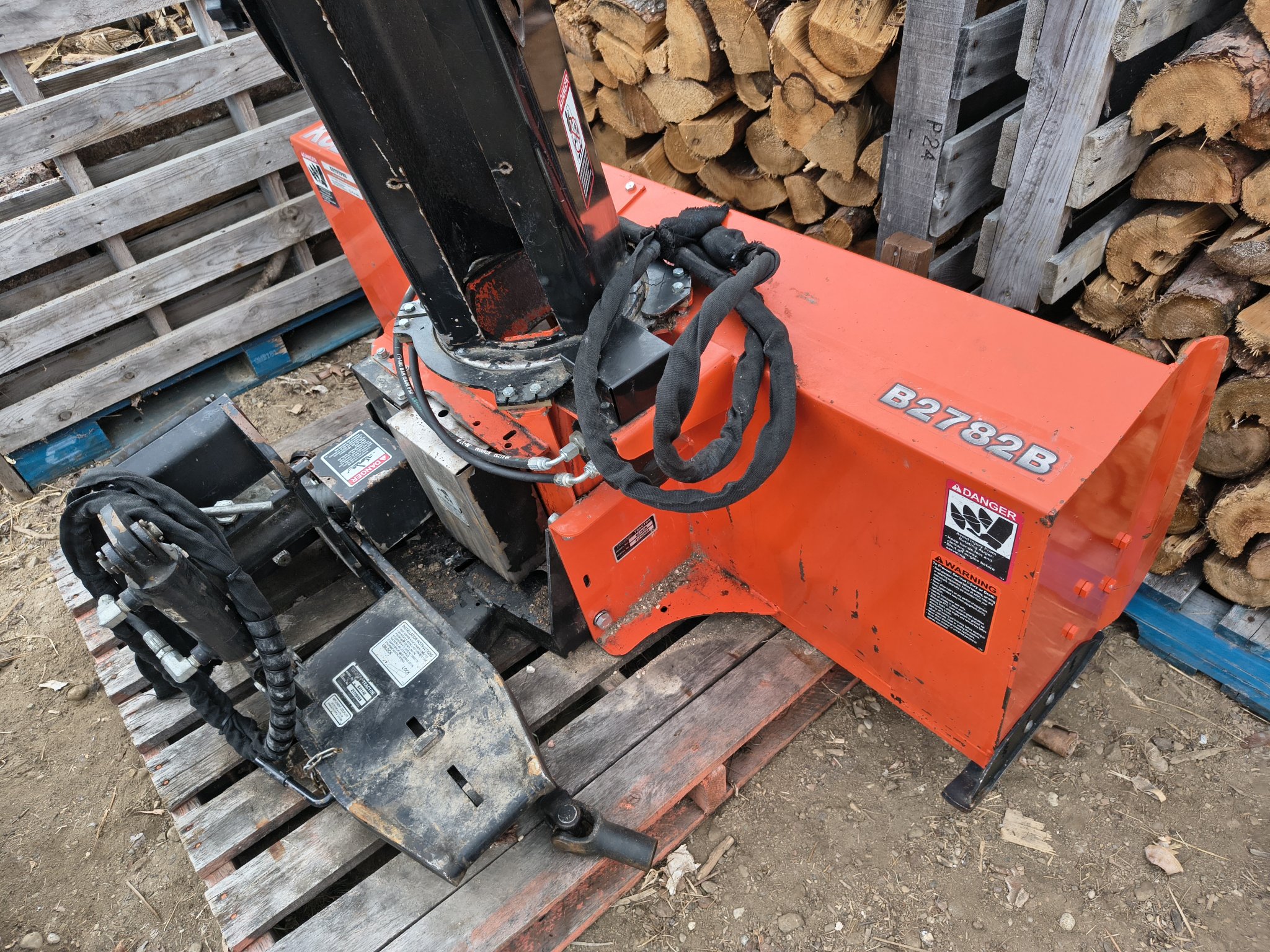

*sigh* ok I'll go snap a few photos of the un-attached blower and subframe in the hoop shed. I give up trying to ID them online, and all the manuals are out there too. Will be settled shortly.

It's B2782B. Not B2782.
Anyway, photos shortly.

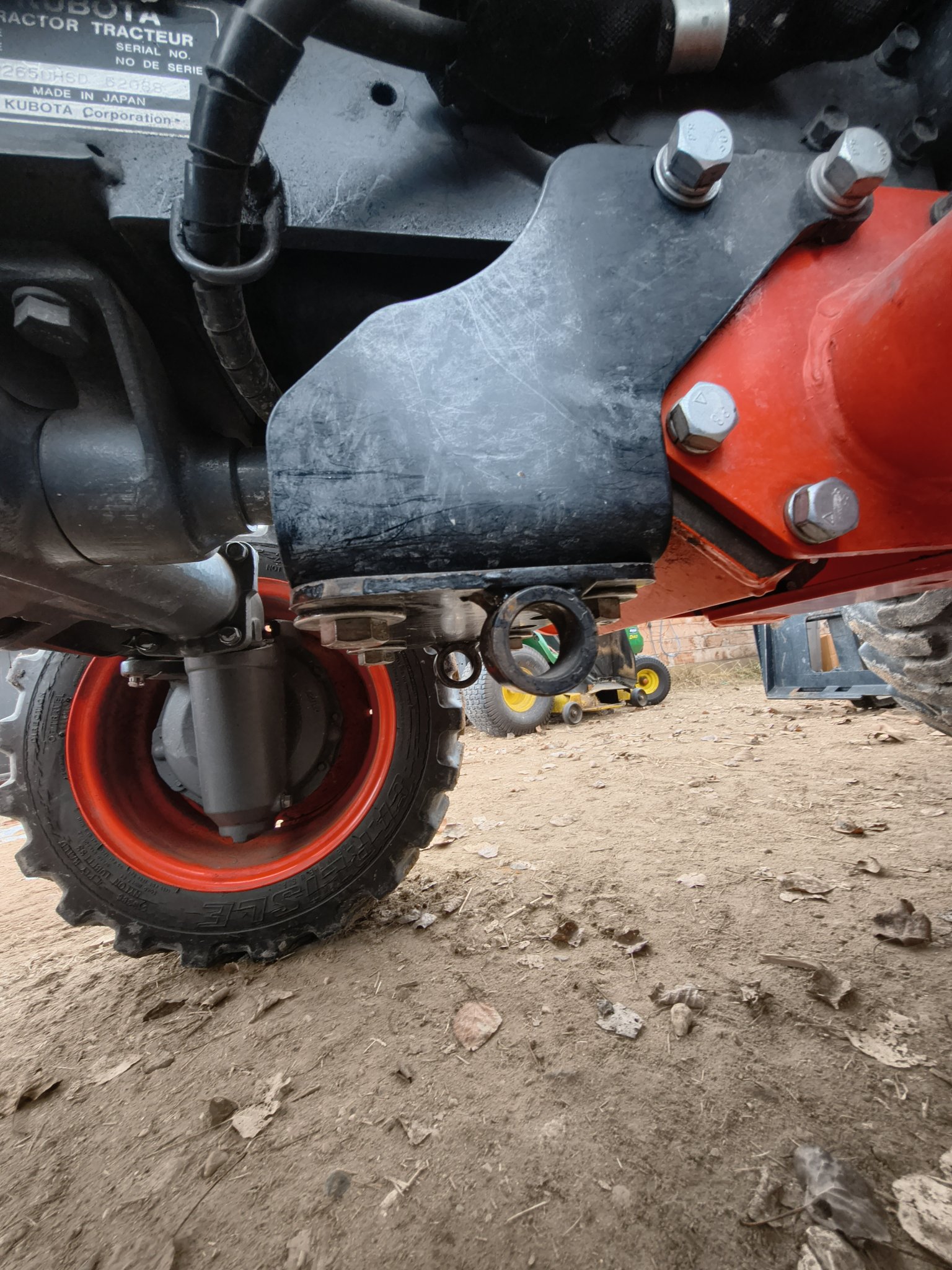

My B2650HSD with B2782B blower, and B2714C quick hitch, subframe, and drivelines.
I have to fish that blower out of the shed crowded with firewood by tomorrow afternoon. An Alberta clipper arrives shortly today for the first dump this year needing the blower. Then standing by for the next bigger clipper forecast for the day after
