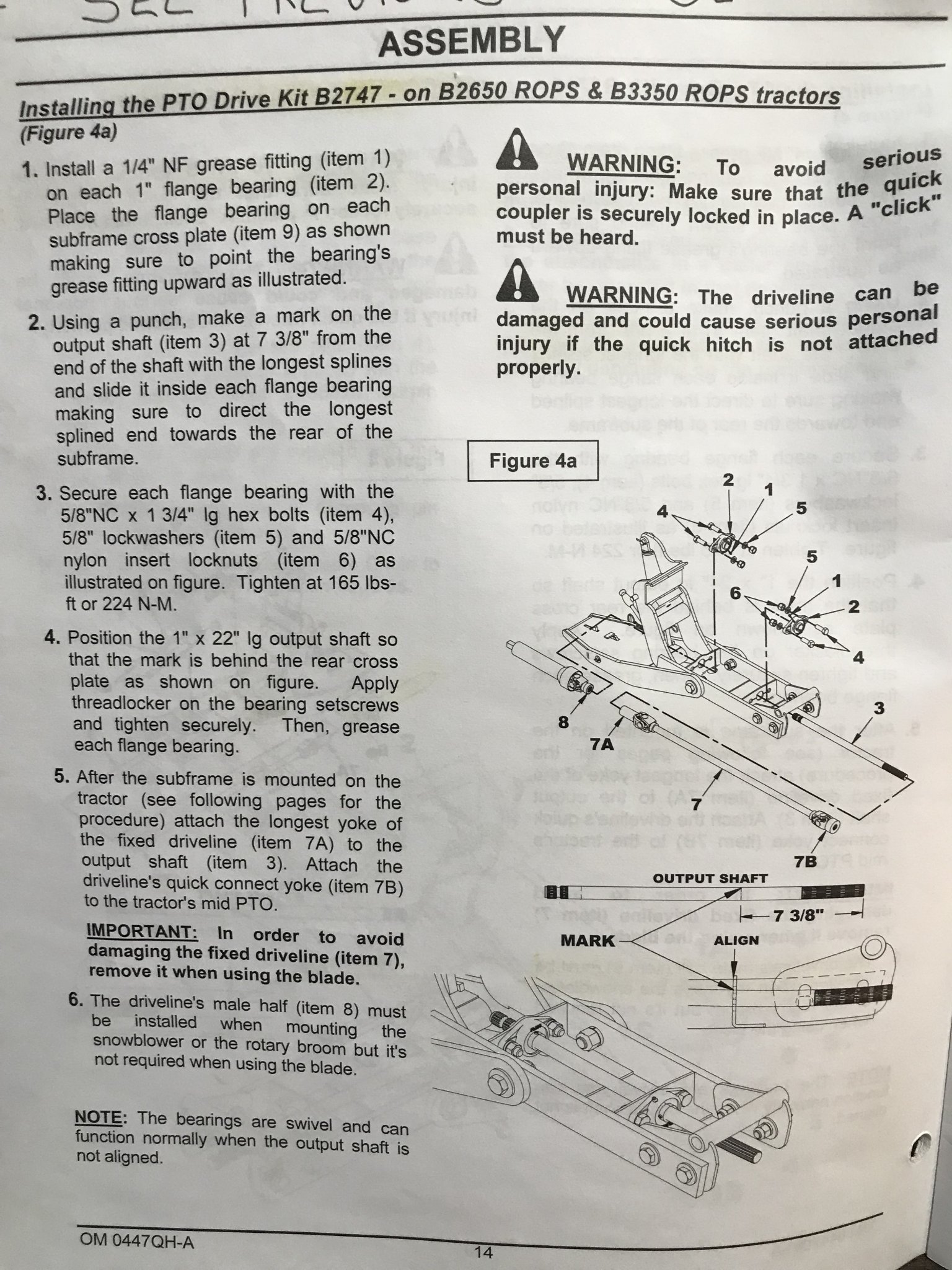

if I understand your problem correctly, this may help. I have a cabbed 2650 with the b2782b snowblower, and this is the assembly manual that I used to put things together. Hopefully it will be of some value
edit: I looked at the instruction sheet for My cabbed tractor, and the only difference was in section 2, my dimension is 9 3/8” from the end of the shaft. Everything else looked the same. Make sure you use thread locker on the set screws for the flange bearings.

thanks guys ya the set screws are the culprit there is none in the collars,shaft did get beat up some may need to replace,geting new set screws in am. im learningand this could have been avoided. thanks again

After you get it all repaired I recommend to mark the shaft with a paint marker. It gives a quick visual if anything has moved. I use bright yellow so it really stands out.
