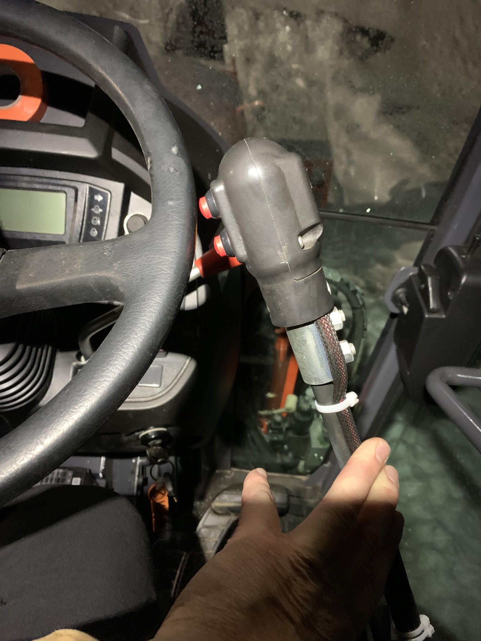

I’m new to tractors but not to heavy equipment. My control lever hits my steering wheel (knocks my 3rd function LP button off) when maneuvering the hydraulics, and wondered if any one has cut the shaft shorter to create a shorter throw to prevent this nuisance?

can you take a picture of what the problem is - maybe a couple of pictures.

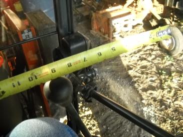

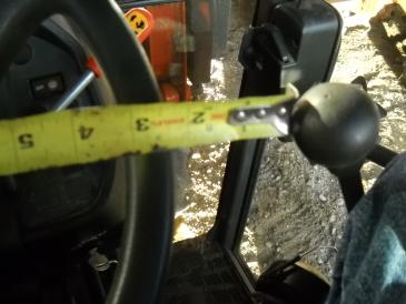

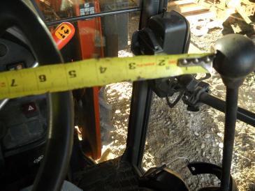

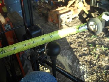

I'll check mine and take a picture of full-left travel. Cab model, but no 3rd function.
Lever in neutral position, steering wheel in lowest position. Distance from knob to wheel and knob to window.
Knob to wheel, full curl position.
Knob to window, full dump position.

This is a GUESS. It appears that the original knob was removed and replaced with a much longer assembly that includes the TF buttons. If that whole tall mess on top went away you'd have clearance?
Could it be that the TF assembly is either made for a different tractor, aftermarket, mounted incorrectly or engineered poorly?

If you had an original OEM Kubota third function installed you would not have this issue. My B2650 cabbed installation does not hit the steering wheel. My guess is that most if not all aftermarket third function installations will suffer with this issue.

At least the top part looks like the one that mcmxi posted of his control in another thread. Might it be an official Kubota part but meant for a different model?

Interesting. It’s a Land Pride TF for the tractor, so I thought it was made with Kubota in mind. Thanks for the help!
