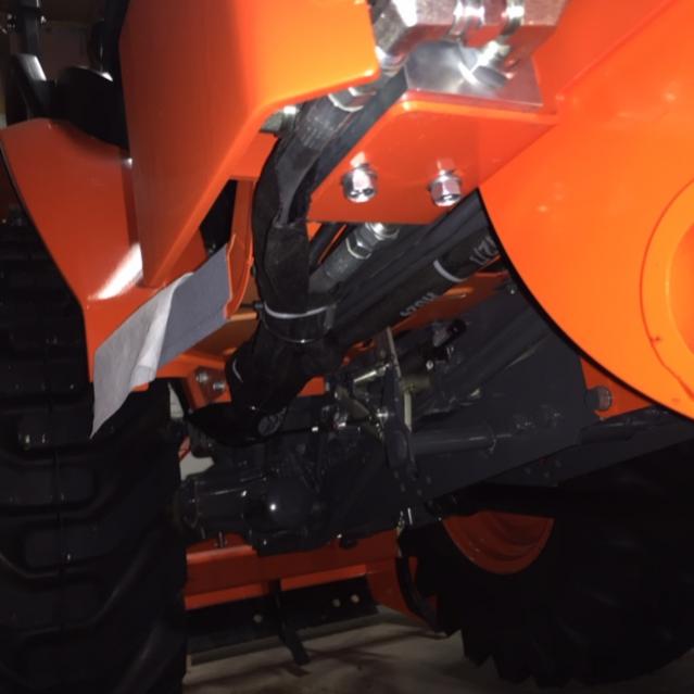

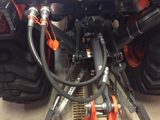

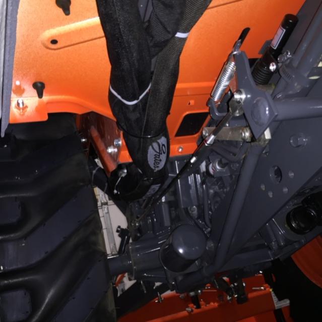

I don't have the Kubota part numbers in front of me, here is what I did. I got the factory third function valve with the controls on the loader handle. I opted to run my hoses to the front for the future use of a grapple. I then ran a second set of lines to the rear with disconnects, for my hydraulic top link (Fit Rite Hydraulics). I have to swap connections for front or rear control; this is not a big deal as I use the hydraulic top link the most. I also modified the mounting bracket for the third function valve and added a custom made guard.

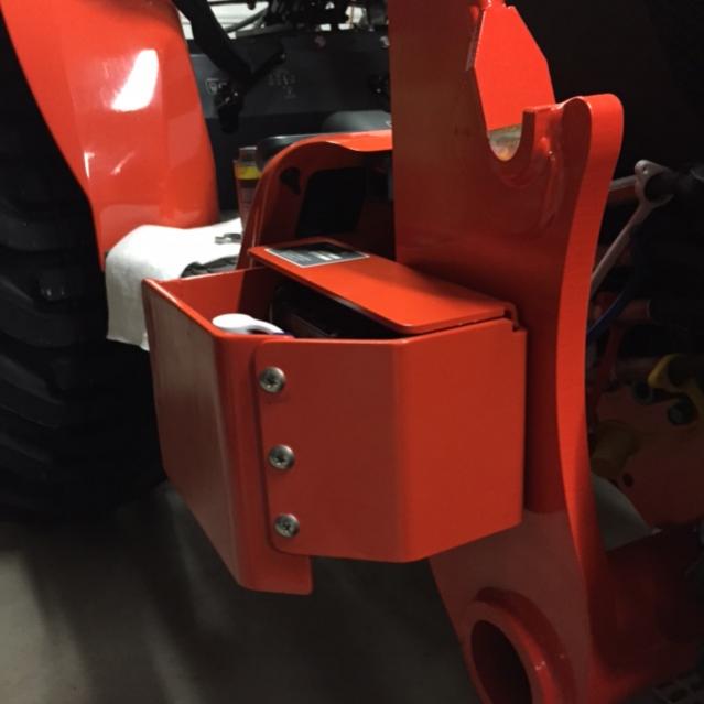

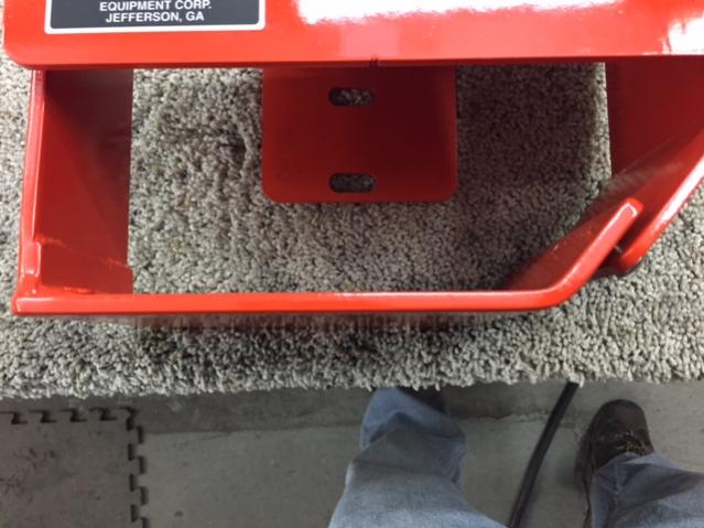

Did you make that cover for the third function valve yourself?
I have the same valve and was surprised they leave it so exposed on the side like that. Was going to build one pretty much how yours is done.
Nice clean looking install.
Thanks, first off not trying to sidetrack this thread (sorry OP)
I made the cover guard outta 1/4" SS plate . I had to slot the bottom holes that mount the solenoid valve allowing it to slide forward, flip and rotate a few of the elbows and re route the hoses as seen in the pics. Cut one corner off the original bracket to allow the elbow and hose to clear. Lobster Red Krylon paint. Just drove me nuts the way the valve and hoses where in harms way!
