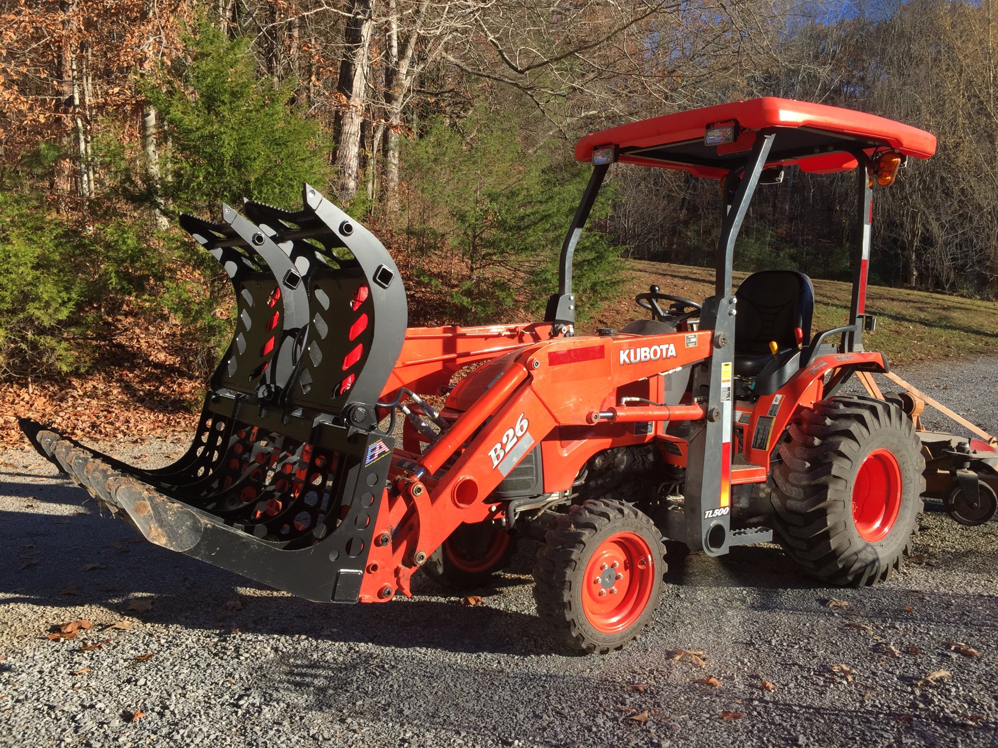

OntheRidge
Nov 1, 2020
406
471
25427
This is what I have on my L47, 55". It is a well made product from a reputable company. You will get a ton of suggestions, this is just what I use and like. Good luck with your cleanup!
