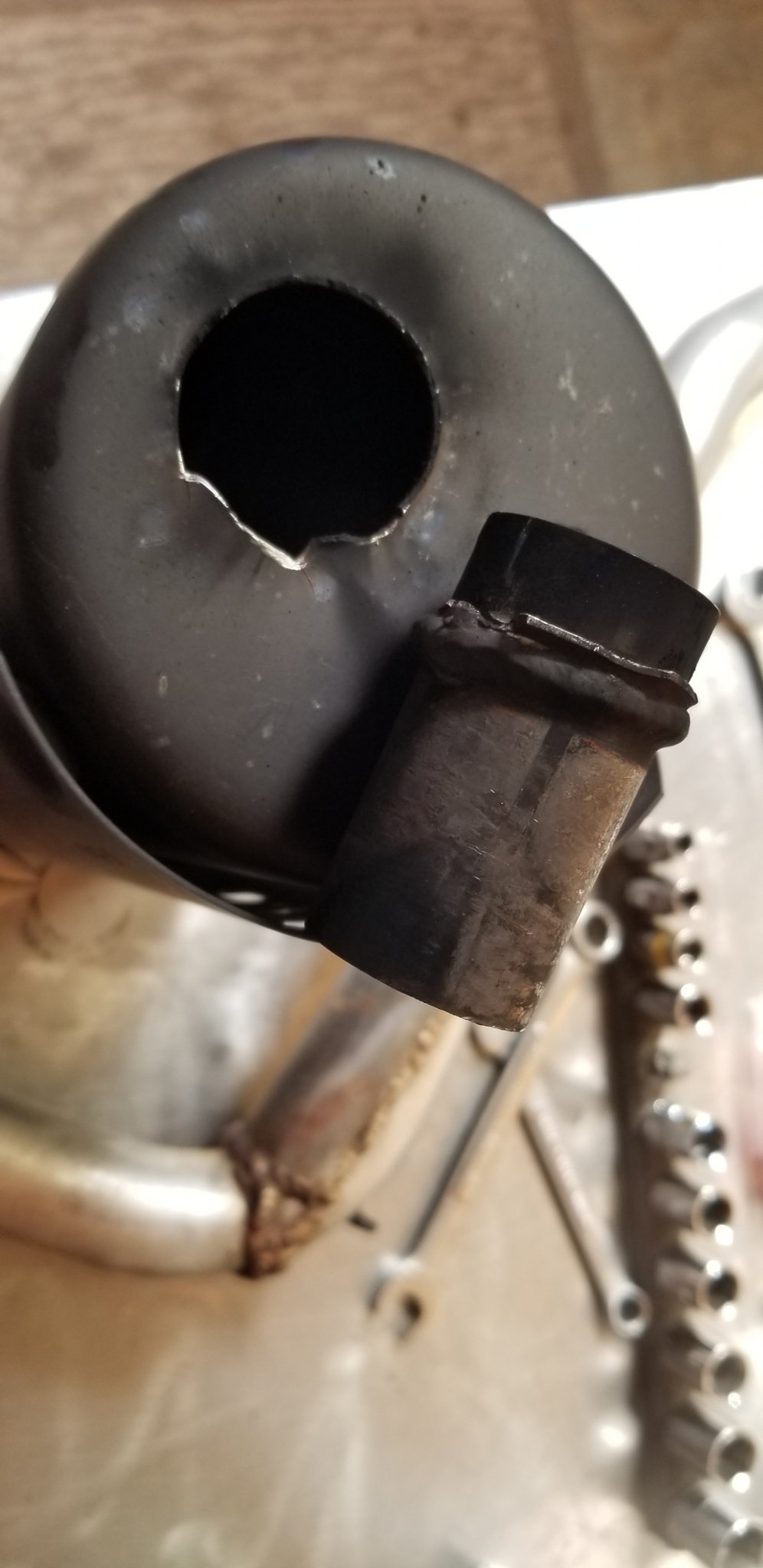

My exhaust pipe got cracked somehow just below the lower mount point, I guess I hit something, so having it brazed at a neighbor. But when pushing the repaired pipe back onto the muffler I saw the pictured crack at the muffler joiner flange. It was invisible with tail pipe mounted. I'm wondering if anyone has seen this kind of cracking on their B2650 mufflers? Vibration and minimal weld strength/thin metal the culprit?
Thanks for any feedback.

It's pretty common on B series, although its usually on the inlet side of the muffler.

Thanks for the feedback. But common with just under 200 hours on the tractor? I probably messed it up when whatever cracked the tail pipe outside the engine cowling, but it cracked right below its frame mount, which makes sense. But could there have been that much effect up where it joins the muffler? I guess maybe, but it didn't take much.

I have never seen one cracked at 200 hours but if you hit something, they can break at any time. Usually, the ones I see cracked are around 1000 hours or more.

Looks like poor welding/manufacturing processes. If its a common failure as the above post suggests, recommend repairing versus purchasing a new one for $370. Why repeat the same failure?
I'm guessing you didn't do anything to cause the broken joint and the quality and/or design is a bit suspect. (Assuming it's common failure across other users).

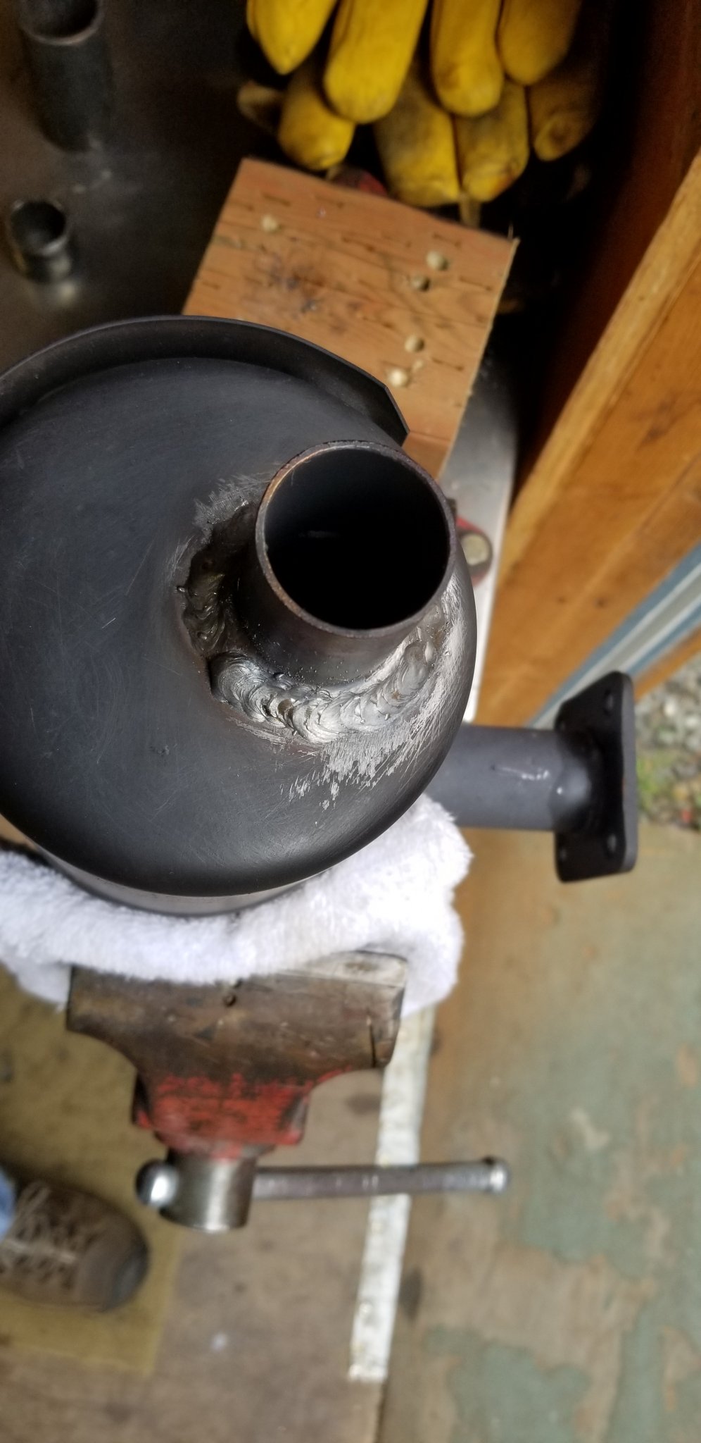

I'll be fixing the muffler out-pipe weld on my B2650 tomorrow.
I'll get some pictures taken too!
Almost 600hrs on my '18

I fix mine today:
Welded up the exhaust and added a support as well!
