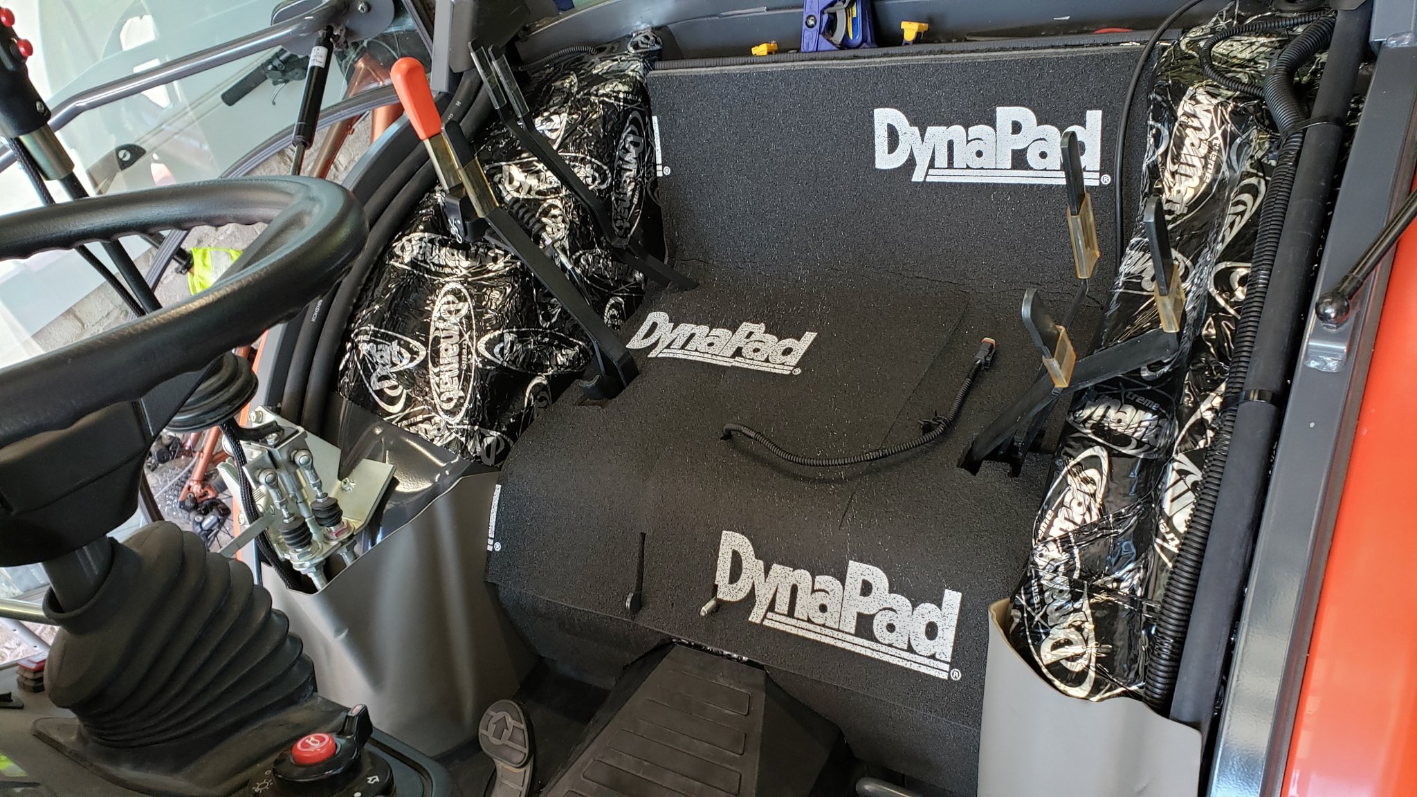

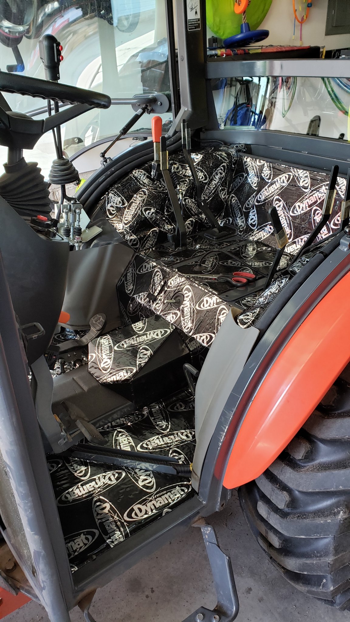

I've read a few threads on noise in the Cab of B2650 models. After 200 hours on my tractor I decided to make an effort to improve the situation. I took a weekend and added multiple layers of sound deadening to the interior and made a significant difference to the sound level. 2 layers of dynamat extreme were used, 1 layer dynaliner 1/2", 1 layer of dynapad 1/2".
The source of noise has now been isolated to the HST pedal. A significant amount of noise originates from the pedal and I don't have a solution at this point to make it better. Appears the vibration from the hydraulics transmits through the linkage into the cab. I did notice a greese zerk on the HST pedal pivot that I didn't see listed in the owners manual.
As a side note, maybe the AC will be colder when it's 100° outside now that the floor of the cab is insulated from the hot hydraulics sitting directly below the cab.
Any solutions for HST pedal noise?
Wow.......the factory service manual says there are exactly two.....one on the brake linkage and on the the top linkage of the 3 point. But yeah look at that.....I do have that one.
(and wow, you really went all the way with the dynamat)
I'm very interested if you track down a way to make it better in the cab. I gave up on it and just wear headphones, but I'd rather not.
