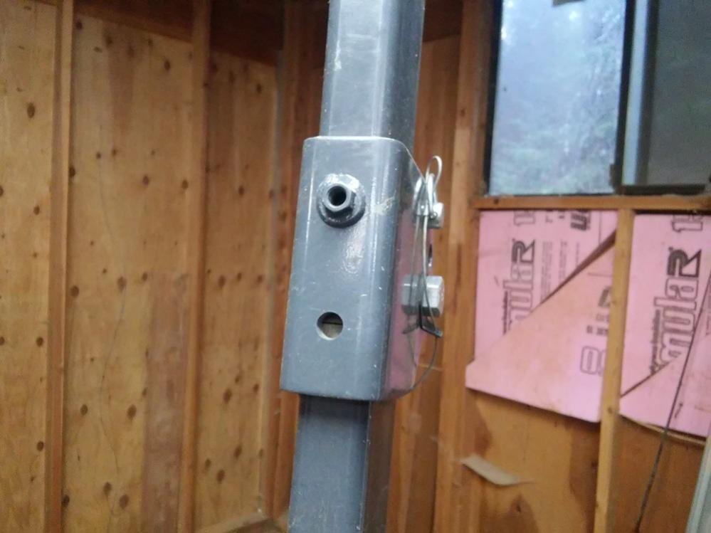

B2620 mechanical connection
I am looking at led lights for my B2620. Checking out the different ways to connect to the rops. Wondering about the factory welded nut on the hinge of the rops. Looks like a 10 mm nut.
