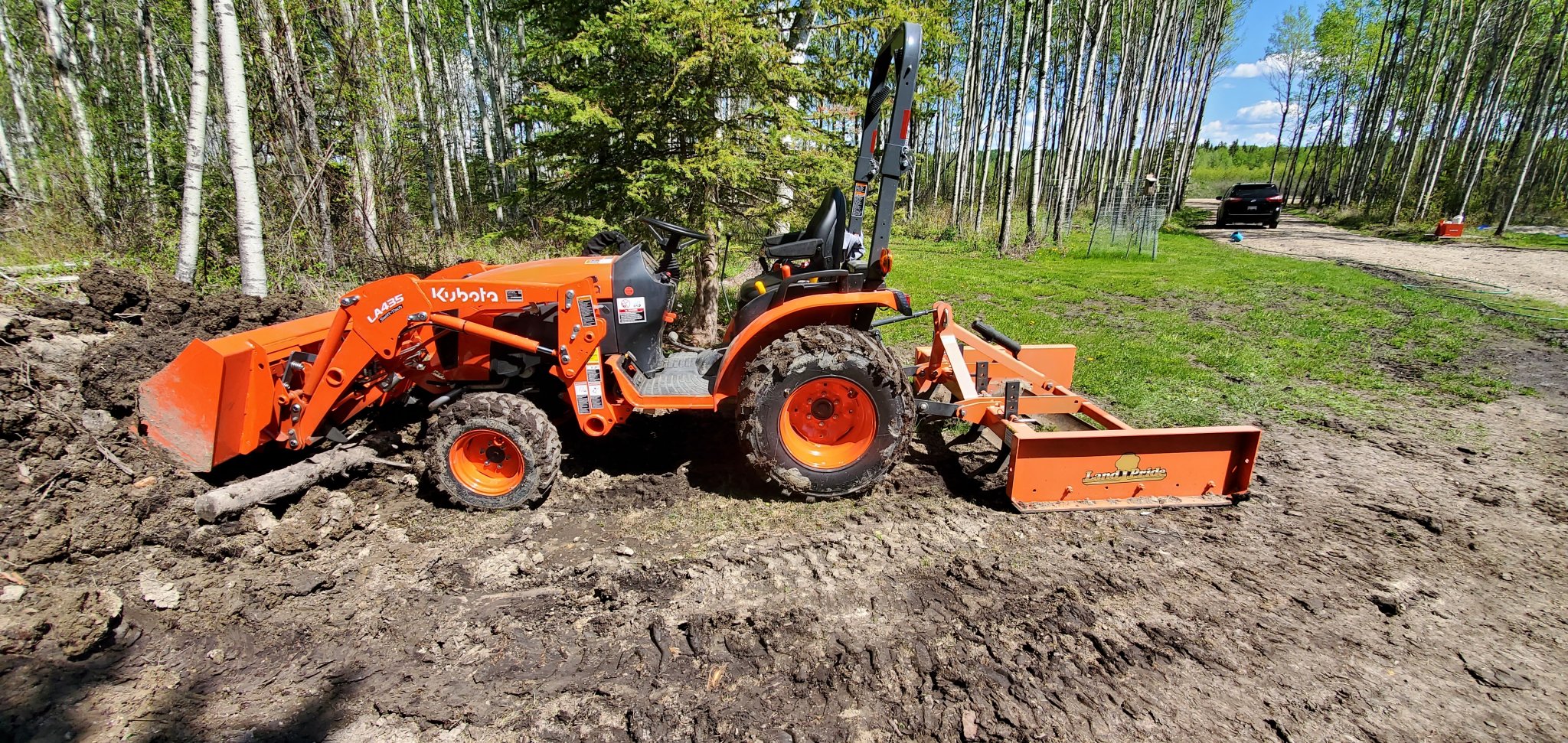

A few days ago I was moving lots of dirt on my acreage. It was +26'c(79f) outside, after a few hours the tractor was very warm, about half way on the temp gauge and the hydraulics were hot, couldn't hold my hand on the lift cylinders. The next day same temp and same running for a few hours but this time I took the side panels off. I noticed a difference in temp. The B2601 ran a bit cooler with the side panels off, the hydraulics still got warm but not as hot too. If I was working in my bush I'll keep them on to help with sticks not trying to stab the motor, but for moving dirt or gravel around sure. Another thing I noticed that helped out engine temps is I switch to Shell Rotella T6 5W40. I know some don't like synthetic oil, but where I live northern Alberta we get temps from -45'c to + 40'c. The other thing I noticed after the oil switch was a extra 50 RPM on the tach @ wot.
