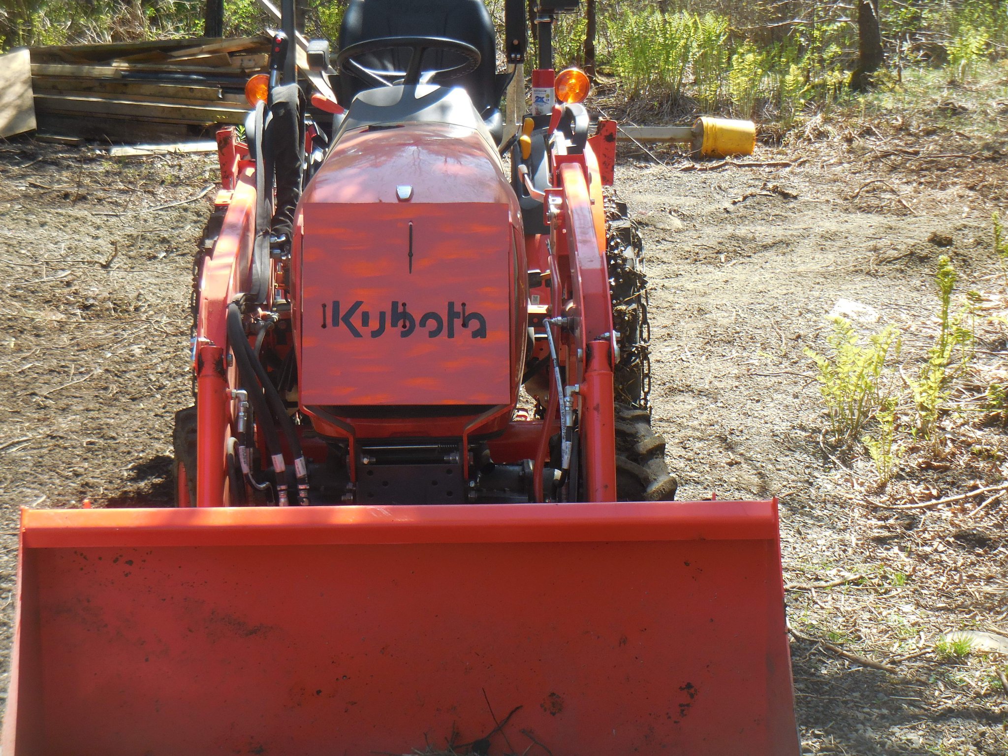

I made a temporary one out of hardboard and zip ties does not protect well from underneath but has a few dents and scratches that may have been on the grill. My wife did the lettering
That will probably work just fine until the one August week of hot weather in Nova Scotia! :ROFLMAO:
