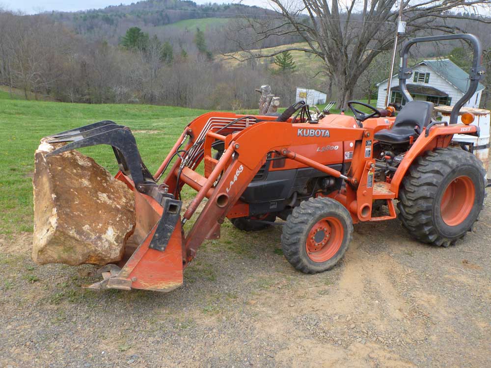

The wider the easier to bend and tweak the loader. 54” on B26 is plenty. Better enhance your grill guard first if messing with limbs.

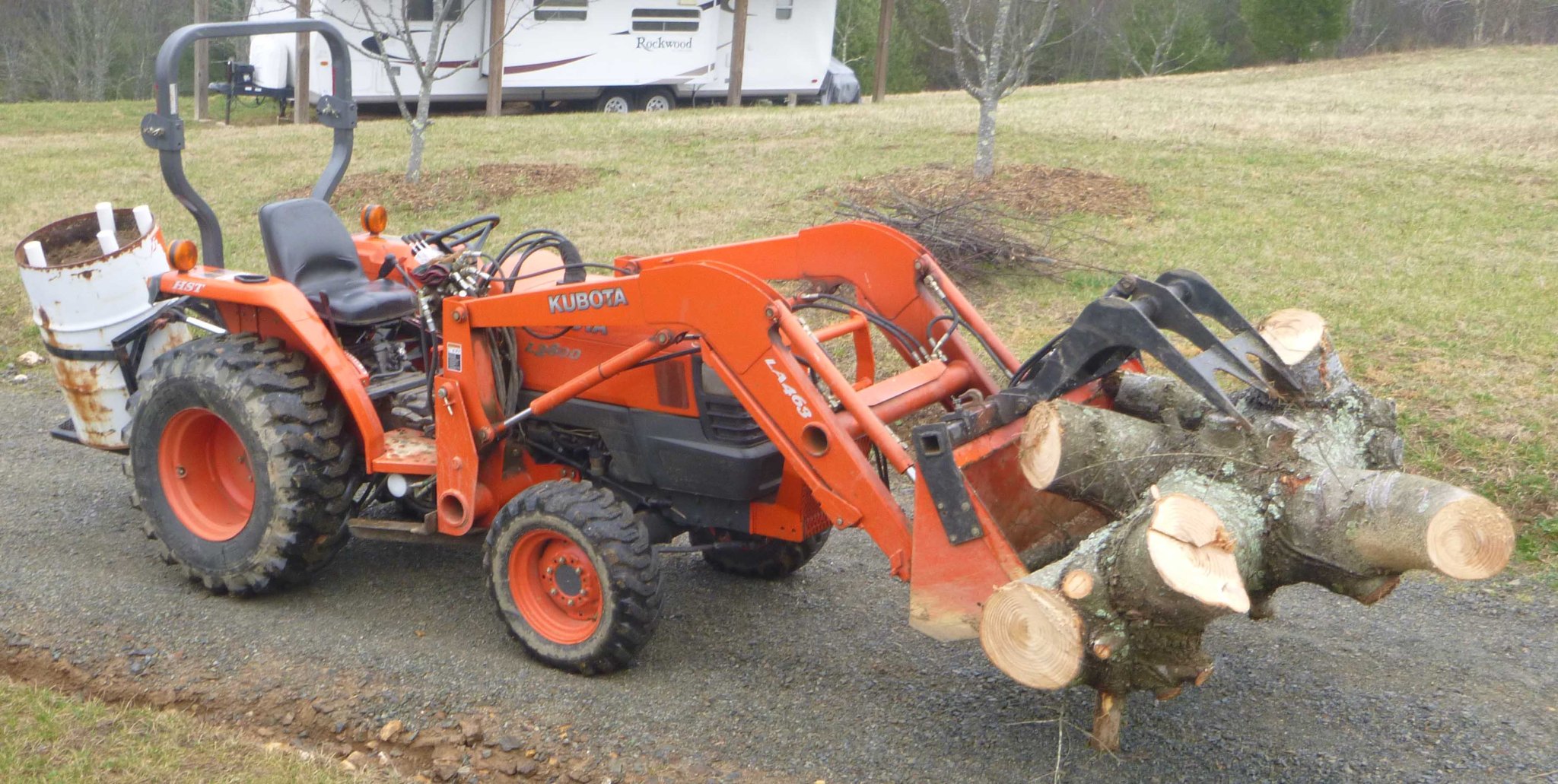

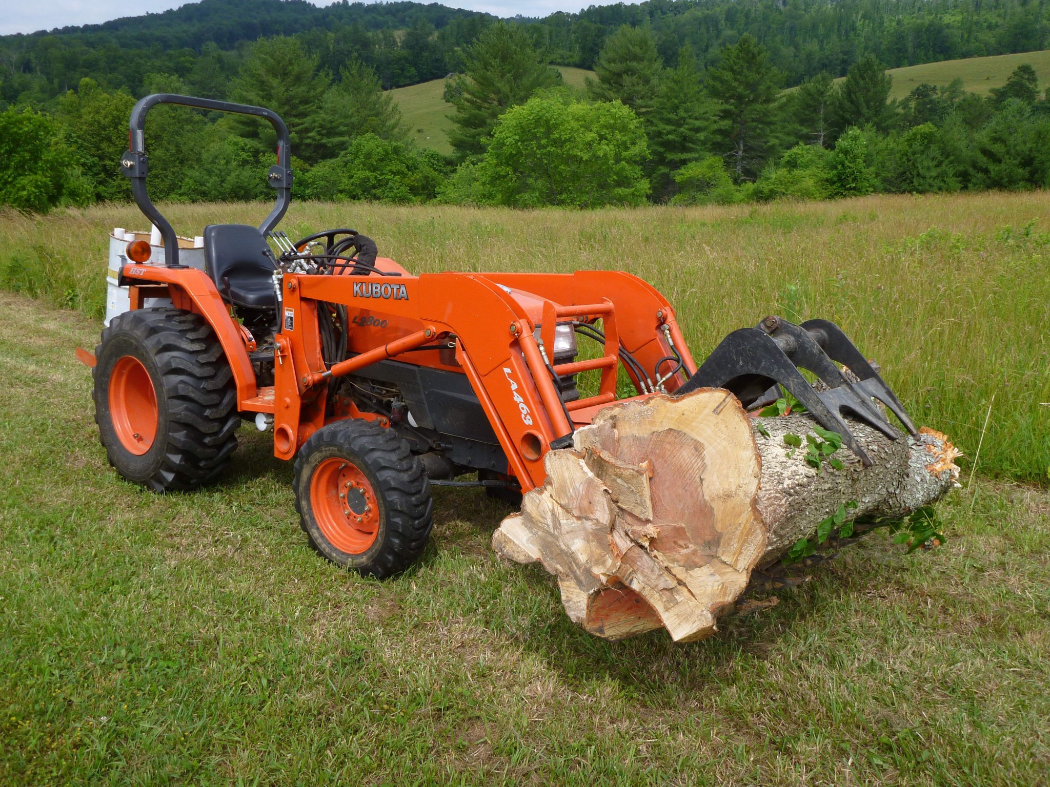

I used to work near that "company" best I can tell, they import from China. Next town over, Tarboro, is W.R. Long, they actually build in the USA (if that's important to you). They have dealers in Beckley or Lewisburg that could order (guessing here) a bolt on grapple (I'm bias since I love mine...)
Anyway the single lid bolt on grapple is 143 pounds and $1,045 based on their website https://www.wrlonginc.com/single-dual-dualx I would add a tooth bar and if you don't have hydraulics, they have that too.... Again, I think it's a great match and with the bucket still attached, the solid bucket protects your grill (somewhat).
Good luck, you'll love ANY grapple (but I do think 66" wide might be too wide...)
