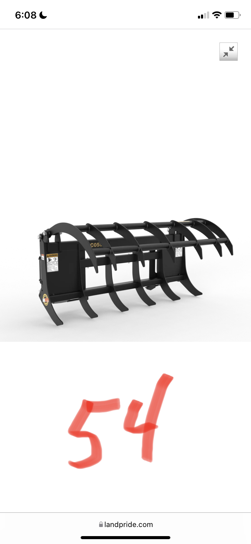

So I bought my B2601 about a year ago and love the tractor. The one thing I wish I did when I bought it was get a grapple and third function right away. Well I am changing that now but want to make sure I dont regret my decision moving forward. As it stands my delear has a LP third function and LP 54" grapple on site which he recommends for my tractor. He said if I wanted the 60" it wouldnt be in until around Aug. I spoke with EA and they told me 5ish months for their Wicked Root Rake and 4ish months for their Compact Wicked Root Grapple. I like the EA products I just dont want to rob my tractors lift capacity and aren't too with how long the wait is.
My concerns with the LP are it is recommended for a BX not a B and I dont want to end up with a ruined grapple. I saw a poster in another thread say that he has the LP 54" on his LX2610 with no issues but I do not know what his grapple goes through.

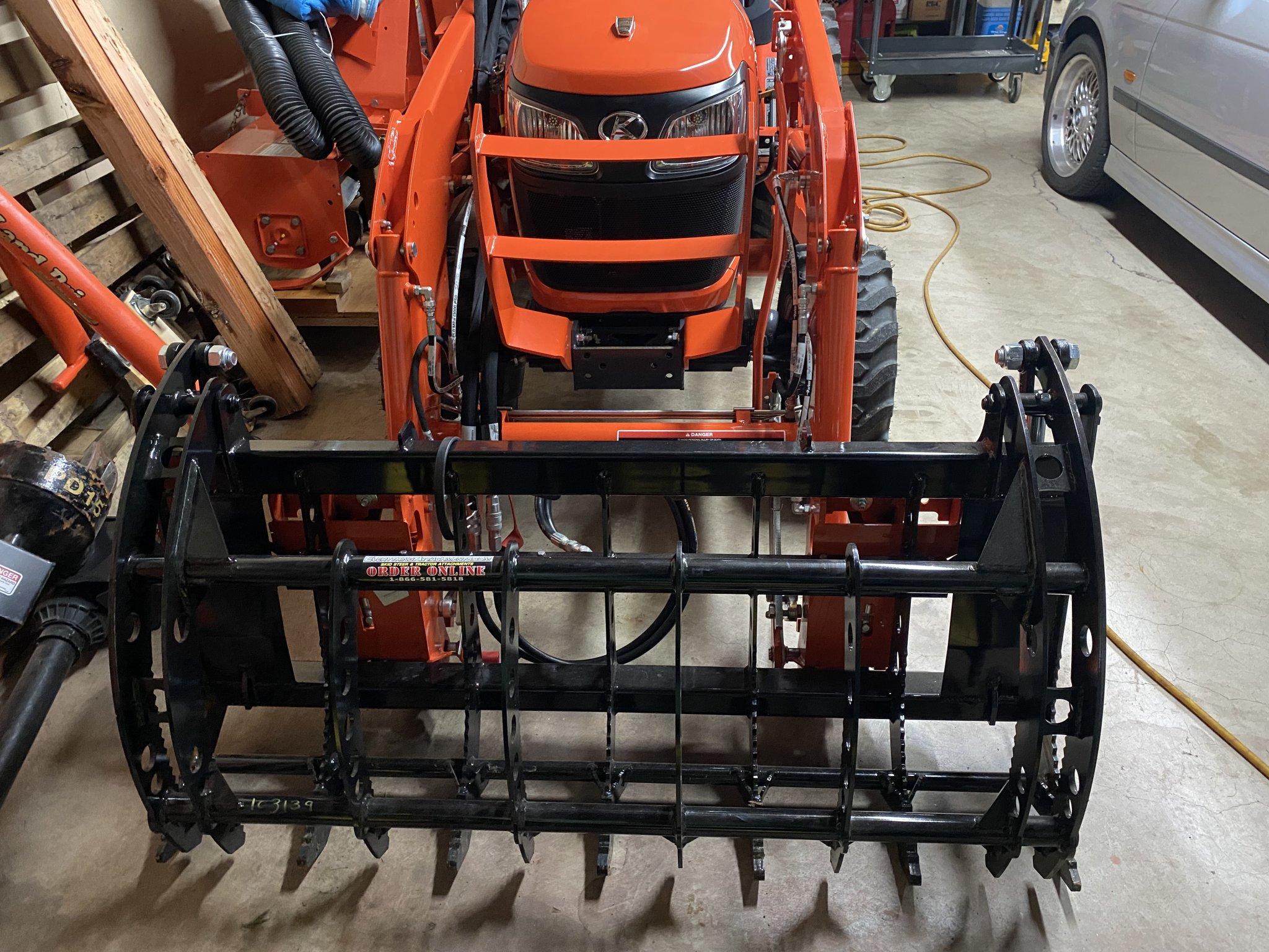

Thank you all for your replies. My real concern is not the width but ruining an expensive piece of equipment/bending a tooth. The big difference I see between the LP 54 and LP 60 is the thickness of the steel used and the crossbars between the teeth which are on the 60 but not the 54. I saw peope complaining on youtube that they bent teeth on the 54 where LP then told them too bad because they were using it on a larger tractor than a BX. Since LP's brochure only states the 54 is compatible with a BX.
I posted pics below showing the "crossbar" on the teeth cause I'm sure I called it the wrong thing.

I have the sco60 on a b 2301 and I do not see how you could damage the grapple without damaging the loader. I would think the 54 would be the same. the grapple is very strong and I would say stronger than the loader arms. If you use it as intended and not as a bulldozer I do not think you will have a problem I almost wish I had gone with the smaller grapple as the 60 inch grapple is considerabley wider than the front wheels and limits access by a small amount in the woods. That being said the grapple is fantastic if you are going to clear brush and limbs after taking down trees it does twice the work done in 1/2 the time. also for bringing in logs and firewood you can keep the logs off the ground instead of skidding the logs and that keeps the gravel and dirt off of them. a lot of people on this site say it is worth the wait to get exactly what you want but I disagree to some point I may have liked the b2601 and the 54" grapple better but a bird in the hand so the b2301 and the 60 inch grapple both were in stock and available I got them the 4th of January and we had a noreaster with a foot of snow two days later and three more since, one that took down a dozen large spruce trees. My tractor has already done a ton of work that I would have been waiting to do when the b 2601 shows up in June. With Diesel at 2.00 a liter the b2301 makes me look way smarter than I am. :unsure: I do not think you can go wrong with either grapple.
