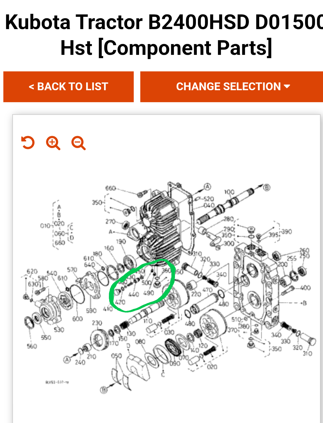

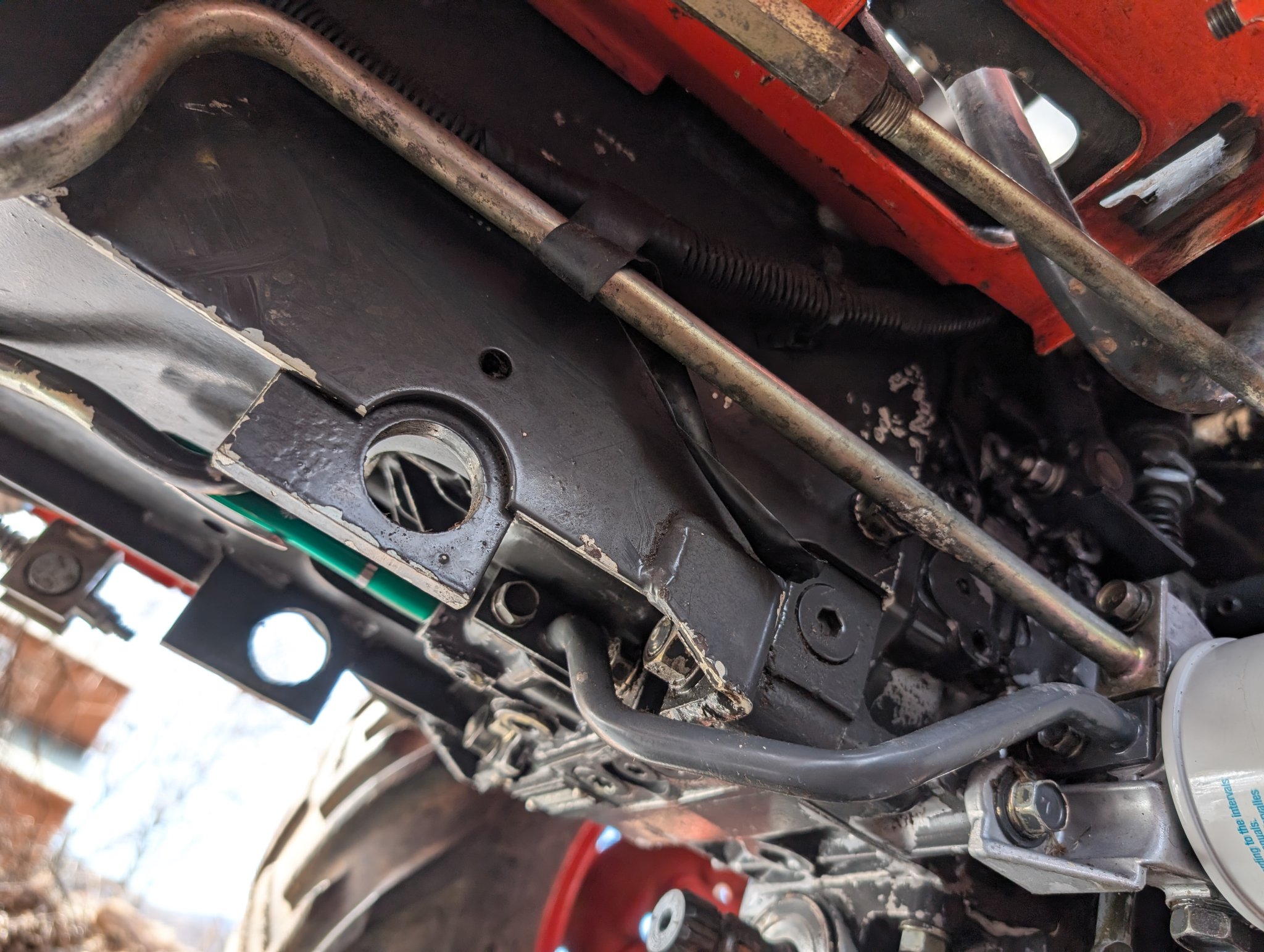

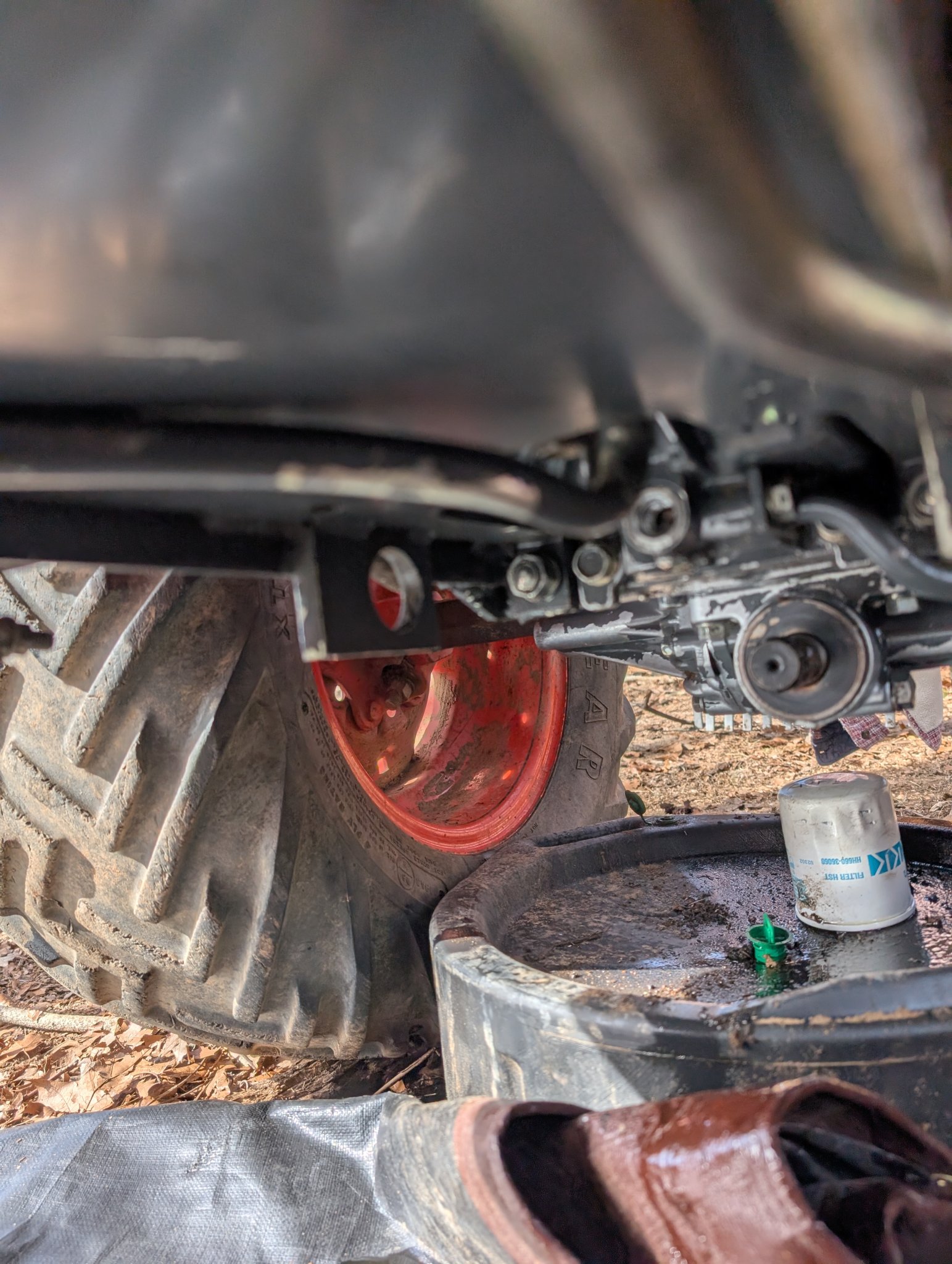

Working on the tractor today and started randomly tightening bolts to reduce sources of hydraulic leaks. When I came to the bolt shown in the pictures below, the bolt did not tighten at all but could not be pulled out by hand. I did turn it counter-clockwise to remove the bolt. The bolt was not damaged but had some metal shavings on it indicating that it partially stripped the bolt housing. In addition, I found a spring and another part shown in the pictures below. The bolt housing appears to be an integral part of the tractor that would be extremely difficult/costly to replace. I have two questions:
1. Is there a product or method to allow the bolt to firmly seat in the bolt housing? I have used helicoil when working on cars but it does not seem practical in this application. Locktite might help but not as firm as I would like. Ideas would be appreciated.
2. I have been unable to locate the bolt and bolt housing with certainty in the parts diagrams. In the pictures the bolt housing has a green pen in it to help locate it. This is important to me because: i) I am not 100% certain that I recovered all the parts behind the bolt and ii) I am not certain how the parts go into the bolt housing before the bolt. I've gotten better at reading the part diagrams but have a way to go.
Thanks for your help

I would try a heli-coil there. The other alternative is Loctite's "Form a Thread" repair kit. It's an epoxy that you apply to the hole. Also supplied is a release agent for the bolt. You apply the epoxy and insert the bolt, allowing the epoxy to cure around the bolt threads.
The problem in this application is getting the hole clean and free of all oil so the epoxy can bond. I'd also be concerned about extra epoxy oozing in to whatever that spring is for.

@PoTreeBoy got it right.
Let me post a little less blurry pic.
That's the charge relief port.
Get a epoxy thread repair kit or a heli coil kit.
Loctite PC3967
I would use a Qtip or a small hook tool and pull the seat out, #450
Then put a cotton ball (dry if doing epoxy or oil soaked if helicoil) in the port.
If helicoil:
Drill 1/8" deeper than the helicoil.
Vacuum port
Tap hole
Vacuum again
Install coil
If epoxy:
Follow kit instructions
Once rethreaded:
Pull out cotton ball reinsert seat cone, spring shim and bolt with new O-ring.

Thank you for your help. I was unable to Loctite PC3967 so I ordered Loctite 236382 4.8-ML. Form-A-Thread Stripped Thread Repair Kit from Amazon. I am missing parts 460 and 450 - am in the process of getting these parts. I do not think that I had the necessary clearances to do the helicoil well in this area. Oddly, it maybe that the treads were previously helicoiled (more than 20 years ago) and have failed. I will look into removing the old helicoil and replacing it with new helicoil- would be the simplest and best solution, if possible.
Once again I want to thank the members of this forum. Amazingly helpful.
32,154
7,868
If it ran before those parts can not be missing.
460 would only been needed if the pressures were wrong, that shim is an adjustment for a short or weaker spring.
450 is in the case, it does not easily come out.

When I removed the bolt, the spring and charge relief fell out but I was unable to locate the shim. You are probably right about 450 still being in the case. I am hoping to get the parts used so I'll probably get the whole assembly because I don't think there would be a significant price difference. And, I am known to lose and break parts.

You have all the parts, only the 420 seal washer looks a little sketchy and could have been leaking.

Torch - I like the ideas and will use them. Looking into the hole there appears to be a small hole on the top (and maybe the bottom) of the bolt hole, just after where the bolt would stop when screwing it into the hole. Certainly is best not to cover this hole(s) with locktite. I will also jack up the tractor to stop the fluid from flowing toward the threads. We shall see. Thanks.

That's probably a relief hole to prevent trapping fluid behind the poppet, or it could be a pressure equalizing port. Yes, better not to plug it.
