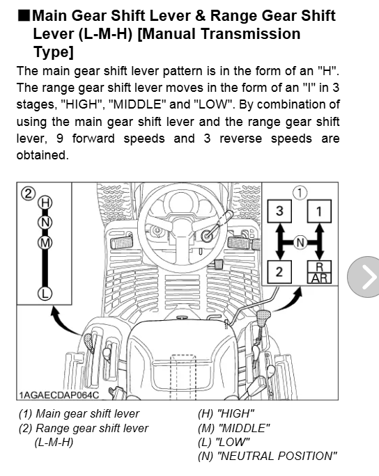

What does the AR stand for which is located next the reverse symbol (R/AR) on my manual 2320? The R is obviously reverse, so what is the AR?

Alternate Range, as it's a three speed reverse.
Whatever main range you are in the reverse follows that.
