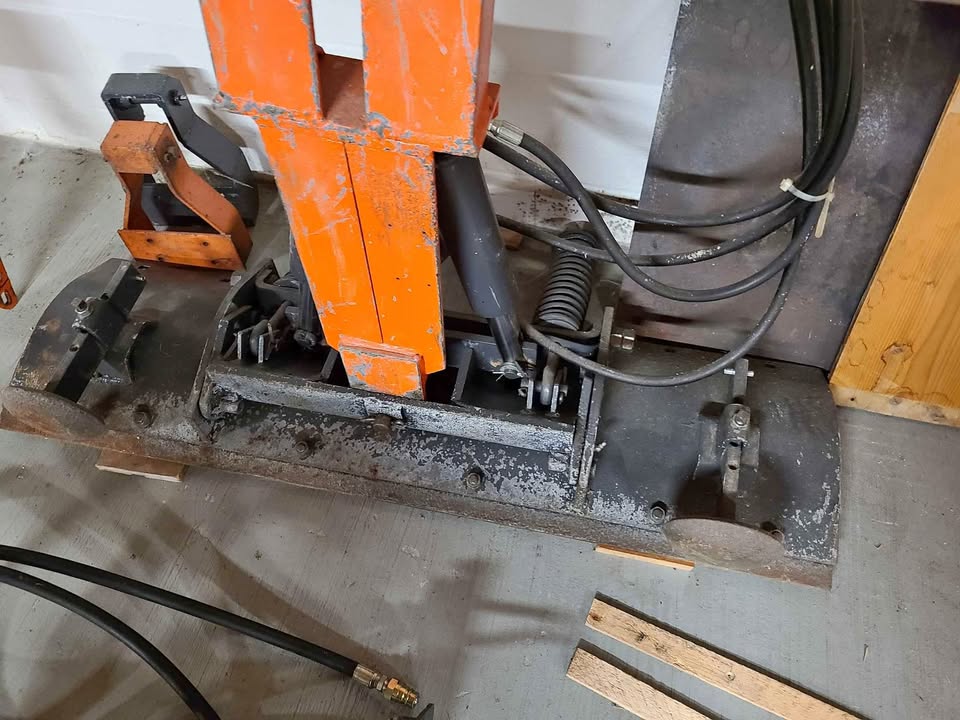

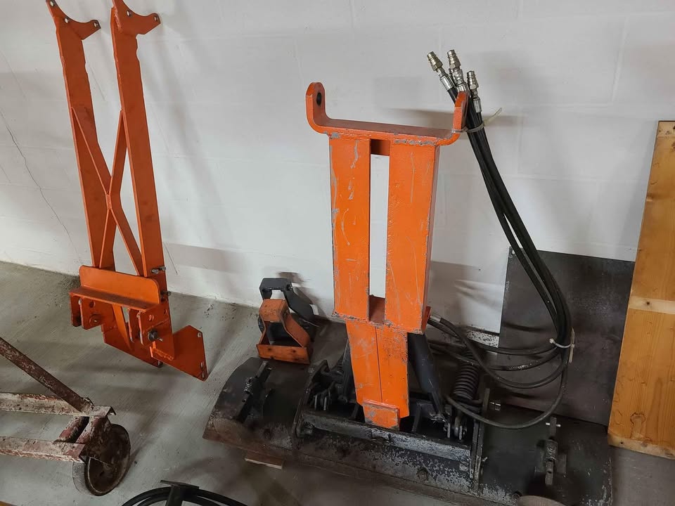

I found this listed near me and initially thought it might be a B2020 that I am hunting for to install on my B8200.
After comparing the sellers pics and my manual, I think this might be a B2030 for the older Bs. It is 48". I read where B2030 blades had 3 subframes.
Can anyone confirm that this is a B2030? Would this have been for a gear drive tractor?
Thanks.

Can't tell you which one it is exactly.
Doesn't even look to be a B2030
The subframe will be a different length for the D over and HST.
and that's an older subframe, the B2030 subframe was adjustable for both tractor types.
Did you ask him what it's off of?
And someone has altered some of the mounts quite drastically.
This part does not look stock.
If your looking to bolt it right on and work it, that's a crap shoot.
But if your willing and able to rework it and the price is right I'd say go for it.

Wolfman, it was left by the previous owner who took the tractor but either didn't have room to take the blade or didn't need it.
Does it look like the B2020 mount? The lift cylinder tower is what caught my attention initially. Thanks.

I'm not sure what model it is.
I do thing that it's very possible that it will fit your tractor.
It does look like one part of the sub frame mount is missing, I'll see if I can dig up the pic of the part.
It would be a simple part to make.
